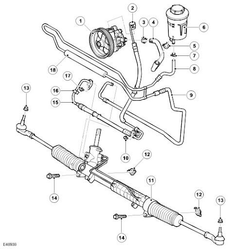

Need a better description than that. There is more than one PS hose. When you say at top, I tend to think at the reservoir?
These are all the hoses, can you point out where it comes off? Green connect to reservoir tank. Red connect to the rack itself. Blue connect to the pump, left one being high pressure output to the rack with the right one being "suction", which is fluid being pulled from the reservoir.
Thanks Dakota he says it's the return hose that's causing trouble.He has ordered it. Boy I think we had better somehow put together some $ to get a spare car.This has got it stuck home a little too often : )

Te return hose is just clamped on each end. Sounds like a hose clamp is missing. The return hose is part of the cooler, so its a very expensive part to replace.

I was mistaken he clarified..its the Steering Rack to Cooler Power Steering Pressure Hose.

The only pressure hose is from pump to rack, after that the pressure drops. But I am sure he just means the connection of hard lines here in yellow. Odd, that joint is sold and should not be an issue really. That joint just snaps together like a fuel line/AC line with a spring clip. Once snapped together they are impossible to separate without the right tool or technique. Also attached a better diagram that shows how the lines all hook up, although it is for RHD. Keep us updated.
Hi Dakota,
He ordered the hose (LR057262) and that turned out
​​​​​not to be the hose !!! He says the hose #9 on your first diagram is the hose.
Do you have a Part number for #9 on your diagram ?
He says it's not a pressure hose.its the one to the Cooler.
MISTAKE AGAIN.
His mechanic didn't realize it was a snap in connection. Thank you you telling me I told him and walla.That was the hose horray : )
