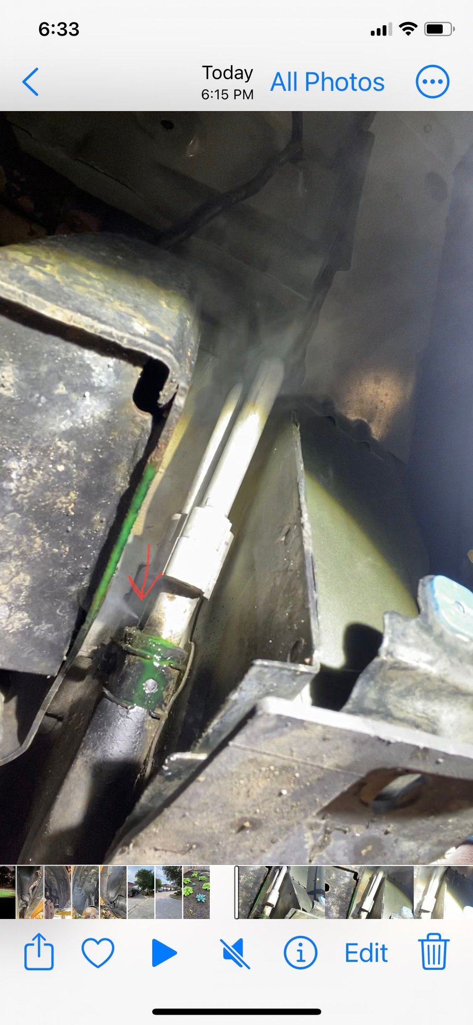

Nice work! I would want to save the rear if possible. My 07 had a pinhole leak on the rear tube Assy that starts in the front left wheel well and runs down the frame. I also had the same o-ring leak as you on the rear connection. I replaced the whole tube assembly, LR029191 Line Set.
