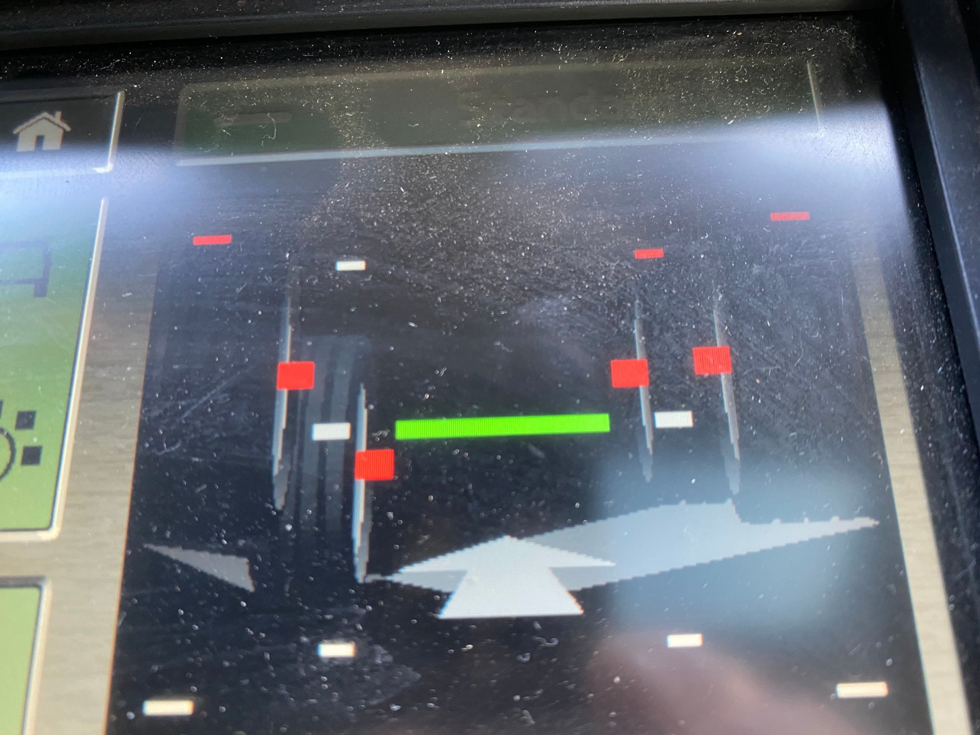

4x4 info on dash had shown the 4 height indicators flashing ( I disconnected them when did conversion as per instructions ). Hasn’t been an issue, everything has been great.
Noticed about 1 month ago that the front left indicator stopped flashing and is showing something different.
Coincidentally, I’ve had a couple random HDC faults pop up lately.
not showing any related codes on GAP tool. Wondering if I should perform a hard reset with battery to see if this goes away?
fyi checked the sensor again and it’s unplugged. So, it should be flashing.
thanks for any help.

Contact AB, looks like a fault with the module that gets installed to "disable" the EAS.

Although I have not fixed it yet I know for a fact it’s related to the coil conversion modulator that tricks the LR3 into thinking it doesn’t have air shocks. I’ve gotta trace back but it’s a wiring issue.

Do you have a GAP tool? I never tired it, but I wonder if changing the CCF from air to coil would actually do anything.
