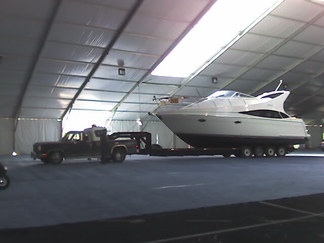

Being in the boating biz, I recommend everybody get a boat. Of course the stuff I deal with isn't exactly trailerable. Here's one of the smallest getting ready for an out of the water show.

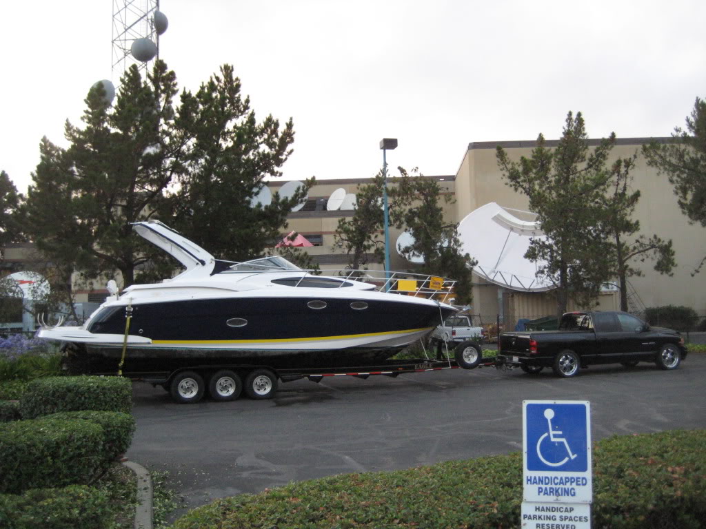

And me moving another small trade-in. Took some work to get that up the ramp with a 2wd! I think the Rover would have done better!

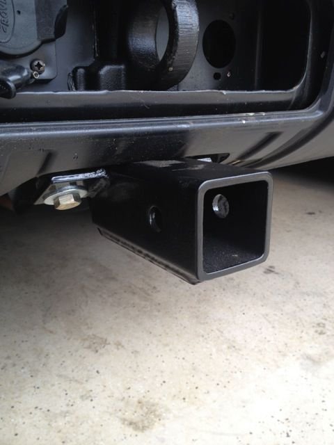

Anyone know if Voyager Racks still offer their lower profile adapter? Found this on expedition portal.

I had reached out and they aren't making it anymore. Said there wasn't enough demand to keep building it.

Fwiw, I had this style (regular, not low profile as in pic) on the truck when I bought it. Be careful of how much tongue weight you have as I bent the tabs or ears that bolt the unit in place. I had to have it rebuilt with 3/8 material instead on the 5/16 that they use. Also, the unoit I had di not have a rear pass through which probably contributed to the extra forace applied to receiver. When I got it rebuilt, I got a pass through incorporated so my bar fully inserts itself now.

I'm assuming that's simply for a bike rack or something? It's mounted to where the chains would connect on the factory hitch, isn't it?
