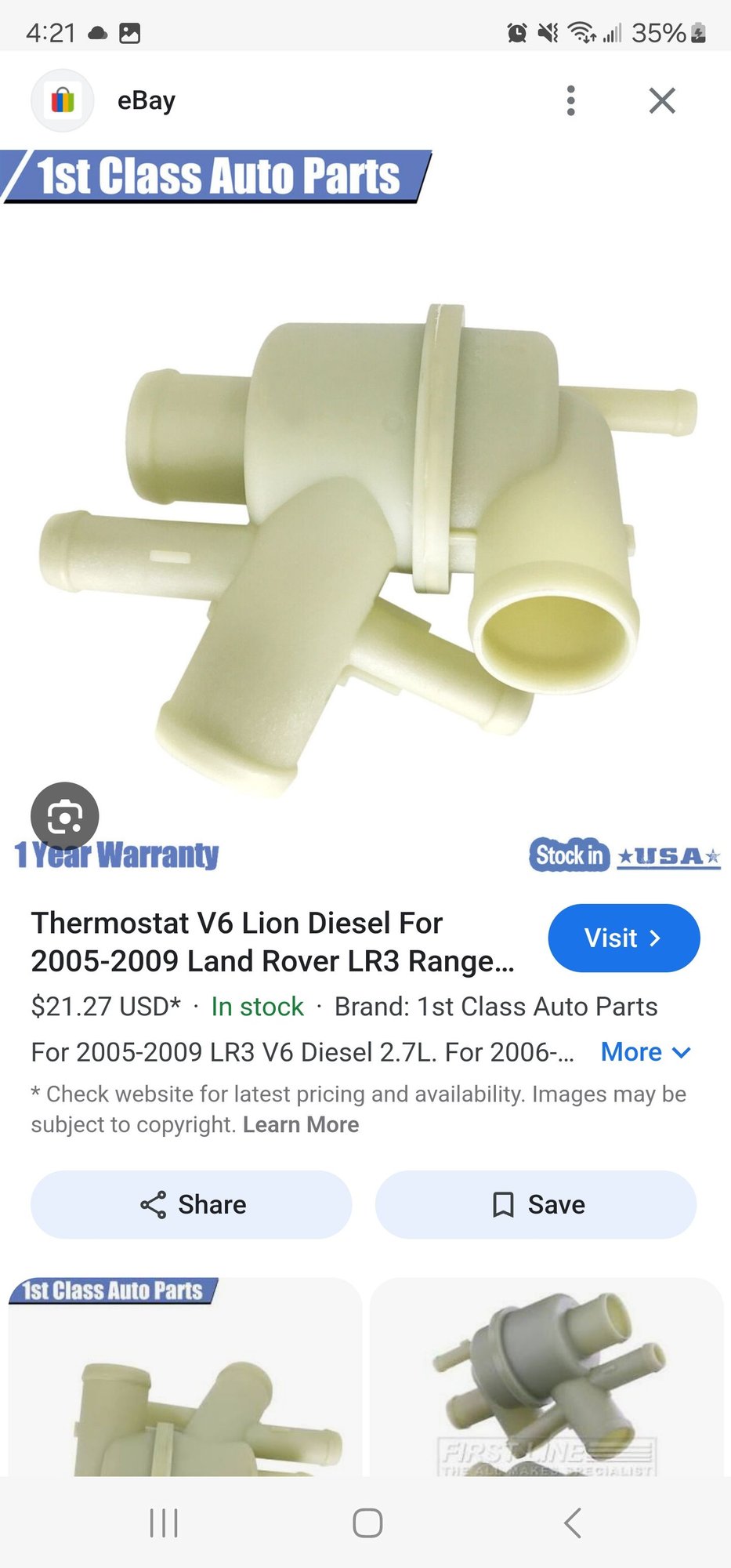

I think this will work. It looks identical but it's for the td 2.7 V6 . I ordered it and I will update when I'm done installing it. It says it's a 180° thermostat.

Hi I ended up buying one off AliExpress that was for the V6 petrol and it came with all the hoses it worked fine but my old one wasn't the problem there was a loose hose connected to it so now I have two
