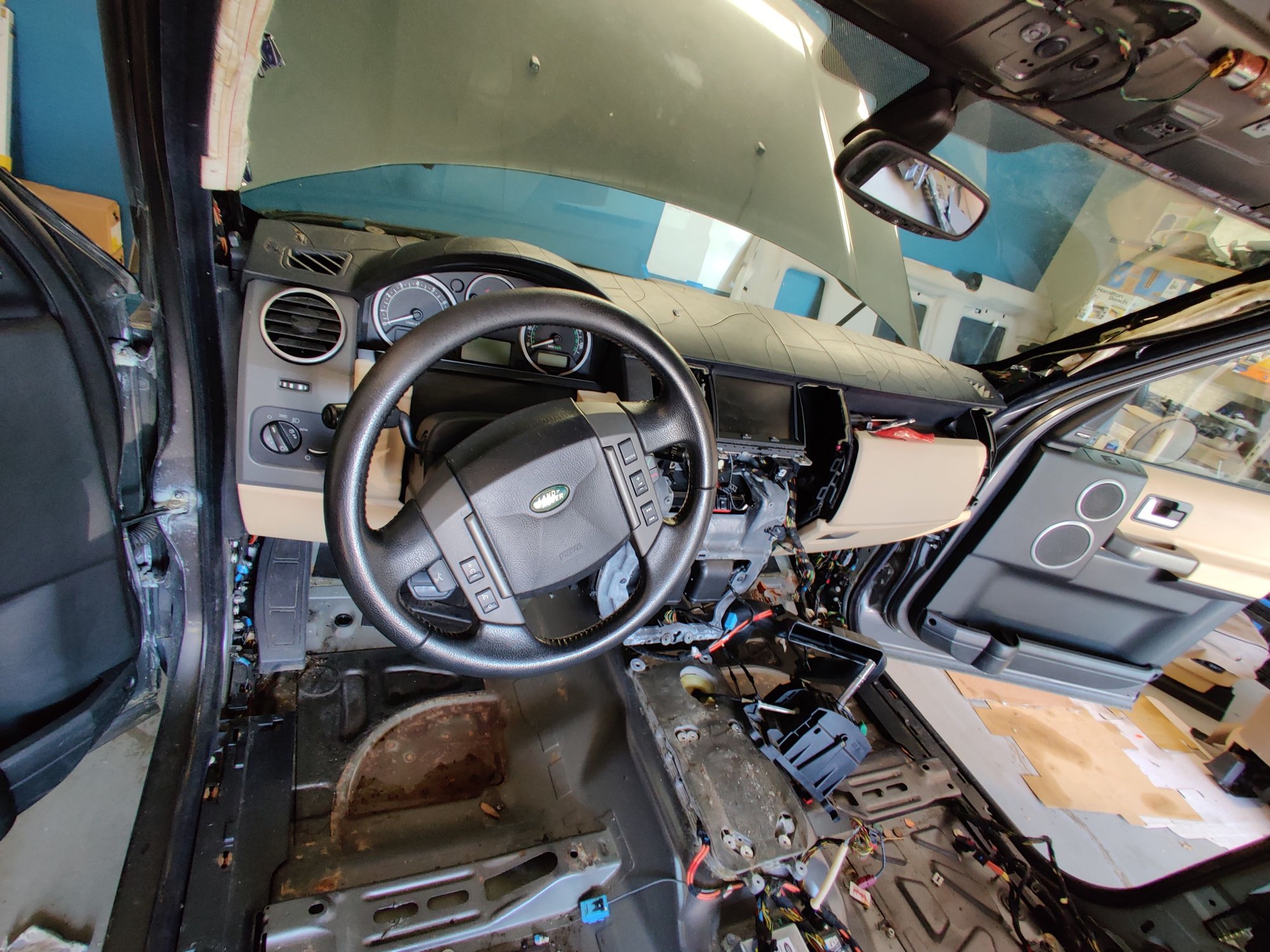

Wait till you need to pull the carpet sometime.
The dash needs disassembling to this point if you aren't cutting the carpet.
WTH is taking place

Originally Posted by Johnny-Bones
WTH is taking place

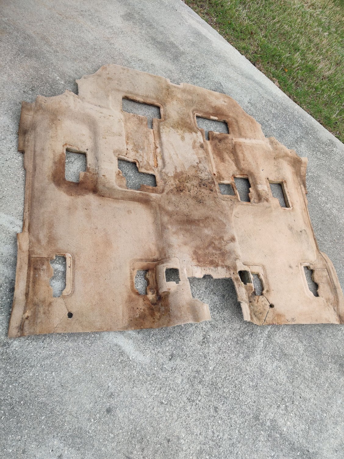

Needed to pull that carpet. Amazingly that is all the garbage that must be removed to do that. I have a thread going in the build thread section. Feel free to join in and have a laugh as I go down the road with this one.
Originally Posted by Rufflyer
Yikes!
I know right. I remember being angry about having to pull the console and seats in my old cars

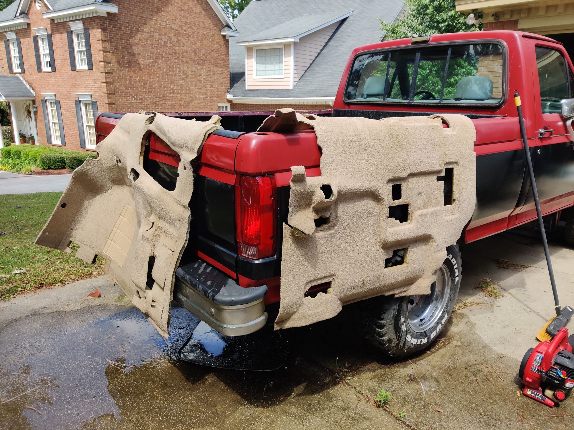

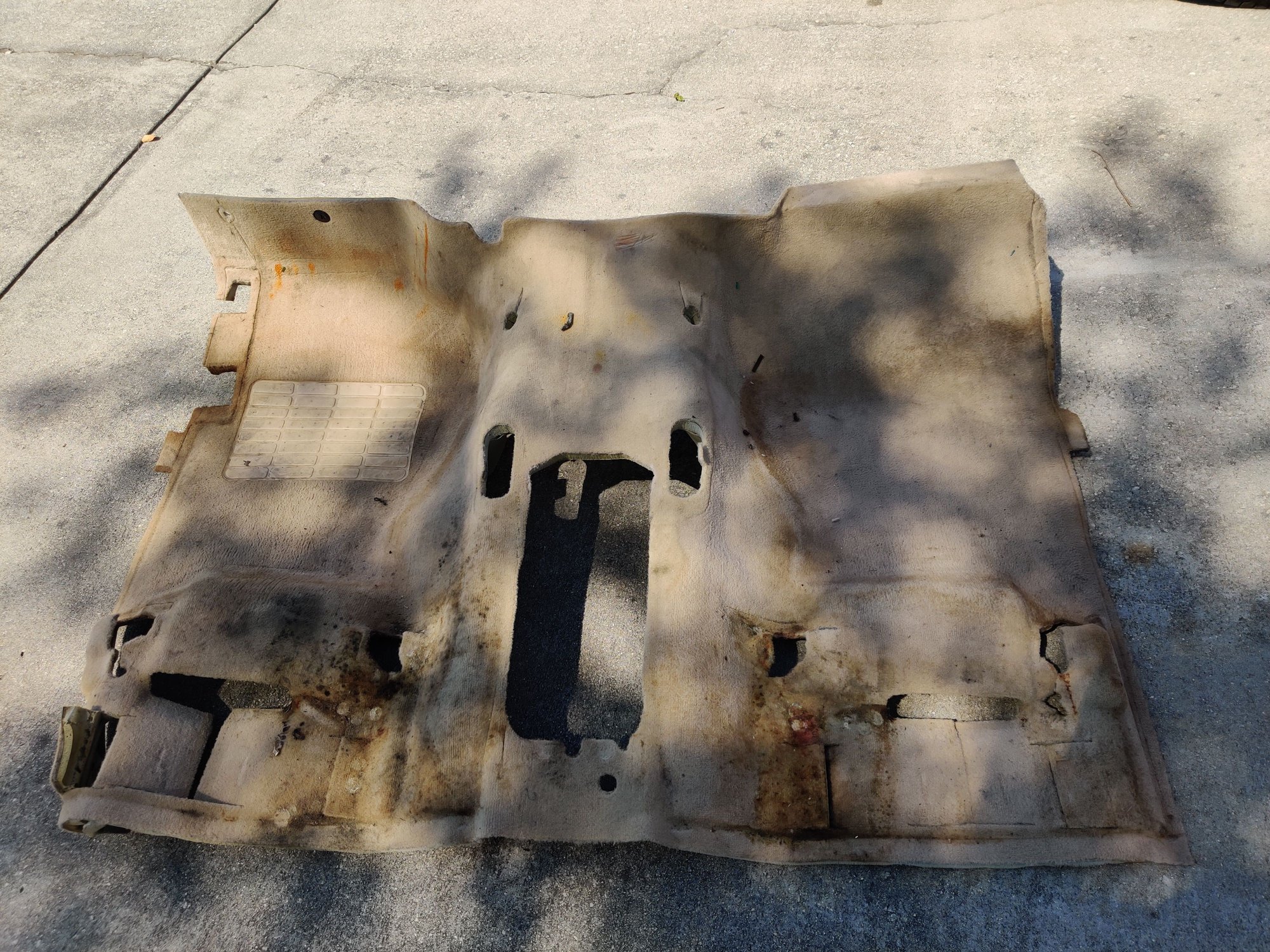

Long story short massive water ingress while the truck was stored in the post lot. That combined with years of spilled everyting and mold meant it needed to come out to be properly dried and cleaned.
Before:
After:
First wash was car wash soap, scrub brush and pressure washer. Second wash was carpet cleaner, scrub brush and pressure washer. Just finished the second wash about 20 minutes ago so they are a bit damp still. Smell and look 100% better. I'll be able to slot them back in the truck, once they dry and I get the added sound deadner installed.
