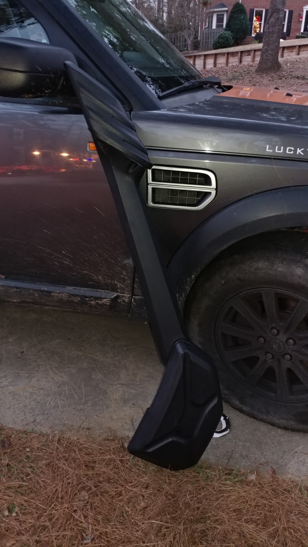

I took mine camping at the SOLAROS Christmas event.
Much to my surprise is snowed in Georgia.

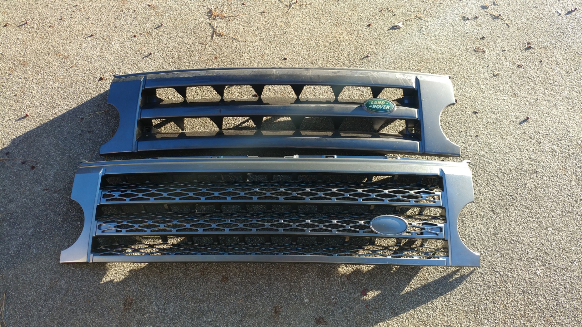

Got a early Christmas Present from my Dad!
Attached Thumbnails What did you do to your LR3 today?-20171215_172438-1048x1862.jpg

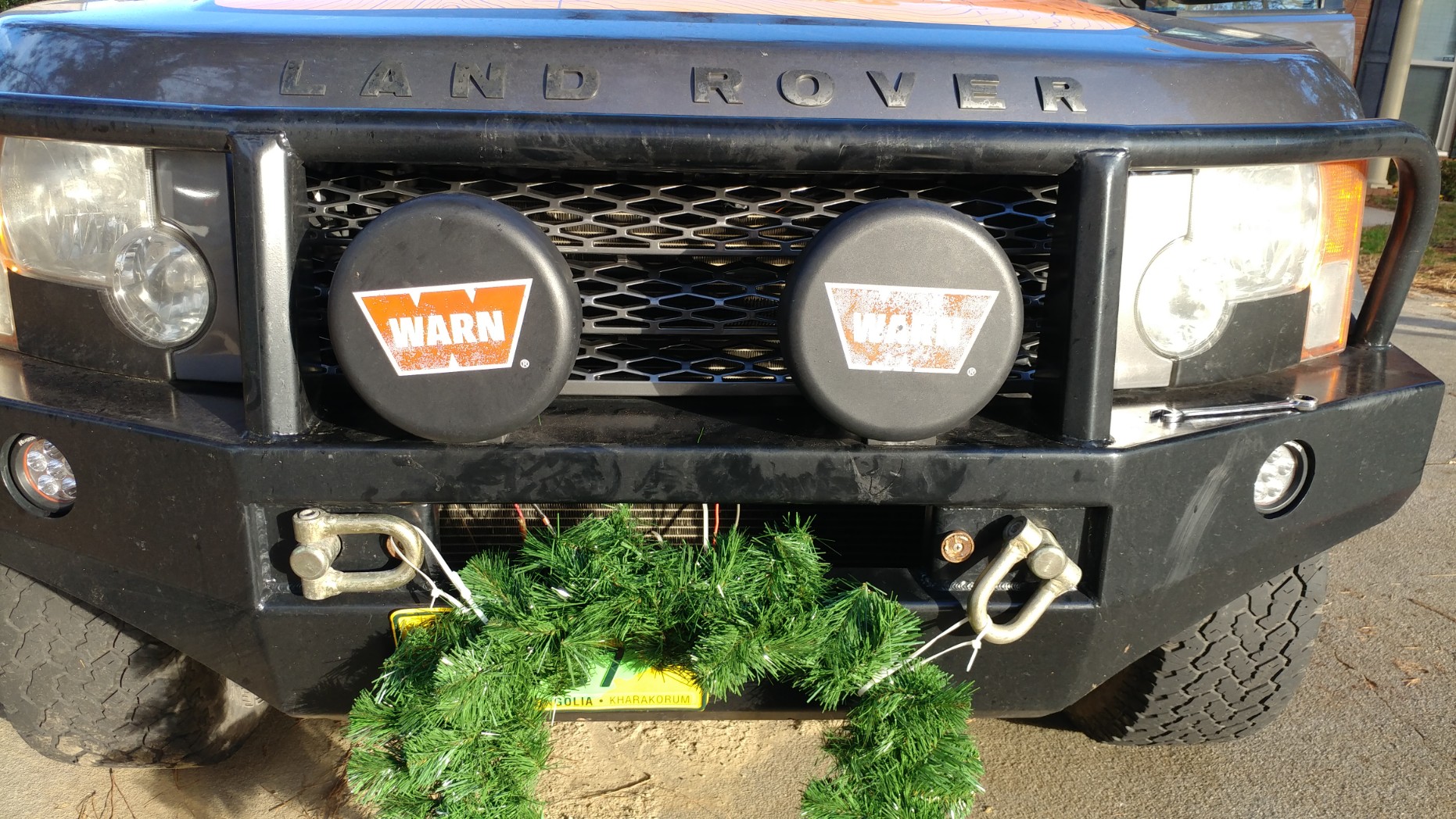

And another early present from the old man
Attached Thumbnails What did you do to your LR3 today?-20171219_155320-1862x1048.jpg   What did you do to your LR3 today?-20171219_155958-1862x1048.jpg
