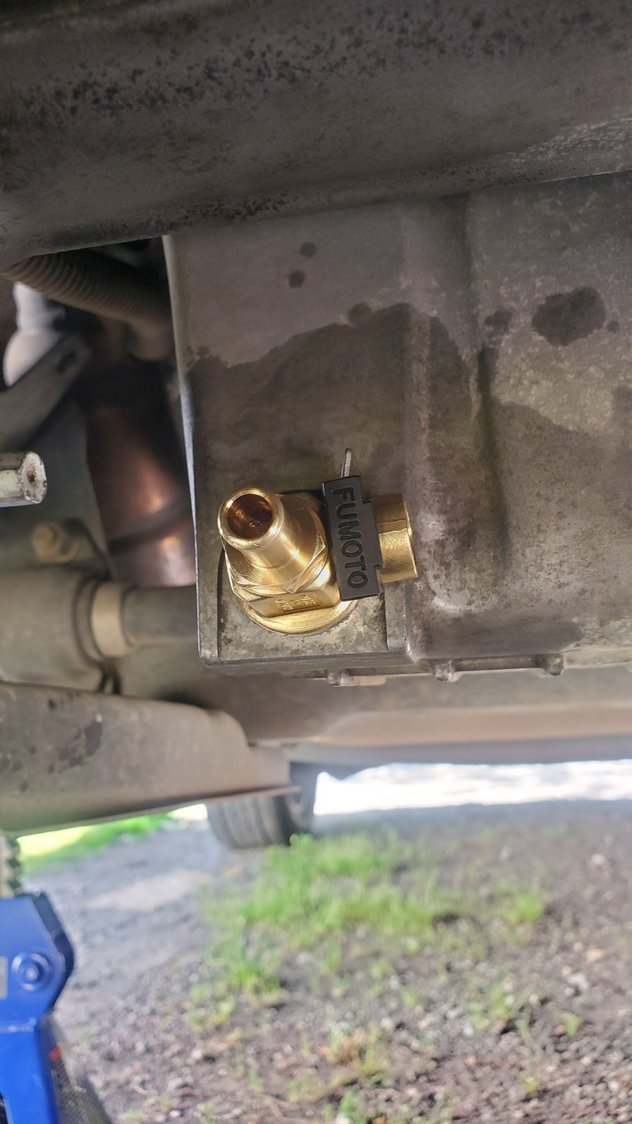

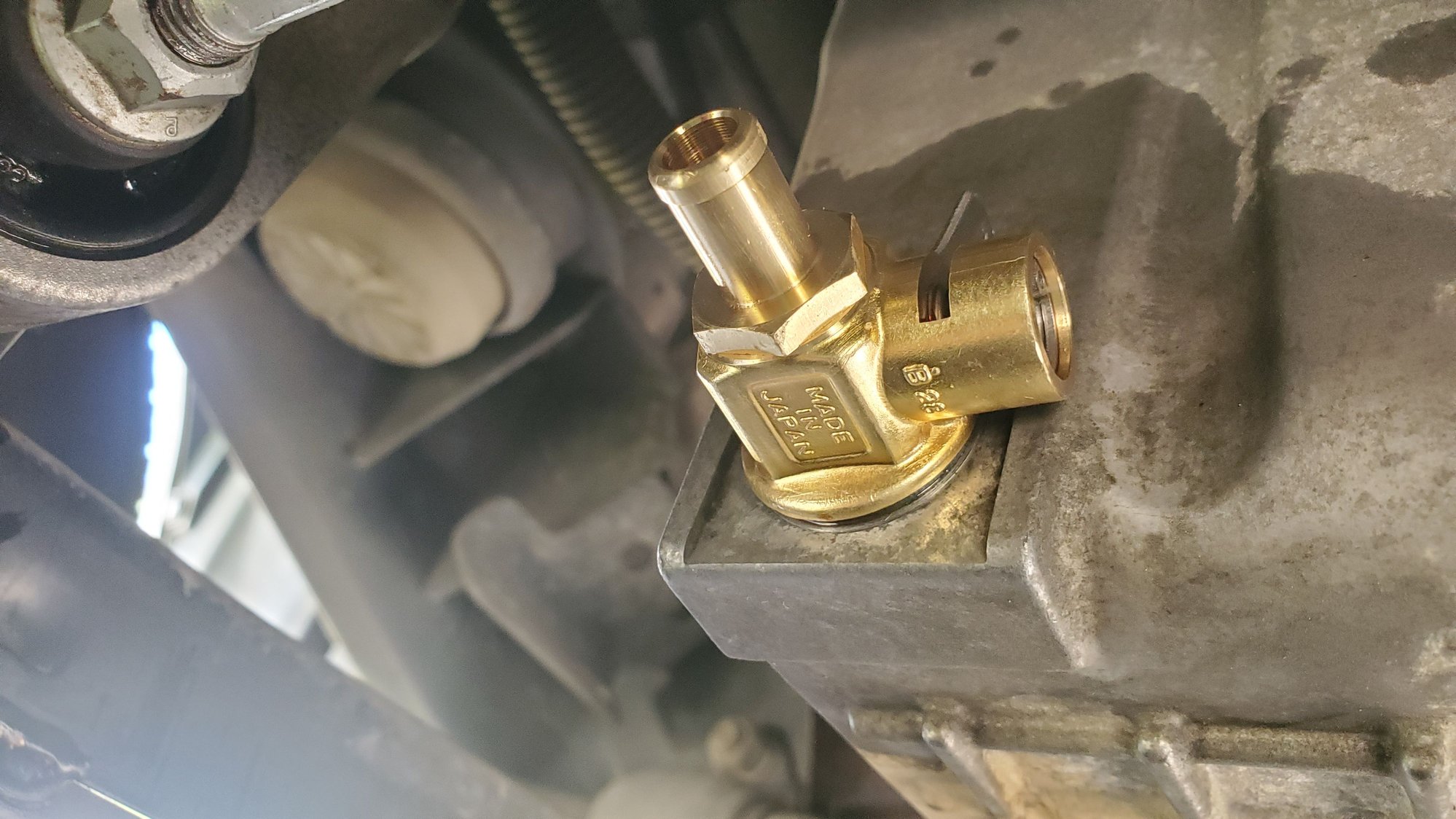

I managed to have the time to change the oil properly today, and on the advice of some prior threads on the forum I bought and installed the fumoto f106n oil drain plug. This was mostly so I could use my nice vacuum pump setup that I bought last week. I have to say that this new plug is AMAZING, and makes changing the oil so seamless. I HIGHLY recommend that you only use this with the skid plate on at all times, as it sticks out a couple of inches, and it might only take a lucky hit buy some loose gravel on the freeway to damage the drain/oil pan/threads. The oil pan is also made of aluminum, so you don't want that getting damaged either as replacing a cracked oil pan would require either an engine pull or disassembling the oil cooler, front engine cover, front differential, axle assembly, steering rack, and generator at the least.
Also, thanks to my skinny, stick arms and child-like hands, I can actually reach around the skid plate in the space around the right front tire and just barely attach the hose, and actuate the release lever on the fumoto drain. This means I never have to take off the larger skid plate again and only need to take off the much smaller plate only when I need to change the filter.
Thanks to everyone on this forum, you guys are awesome!

If you can reach the valve lever, you may be able to leave a section of hose attached then just extend the hose, if needed, when draining.

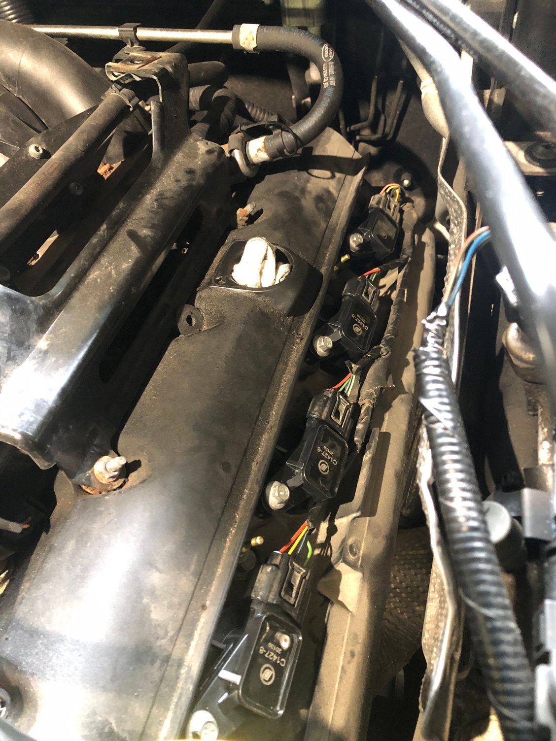

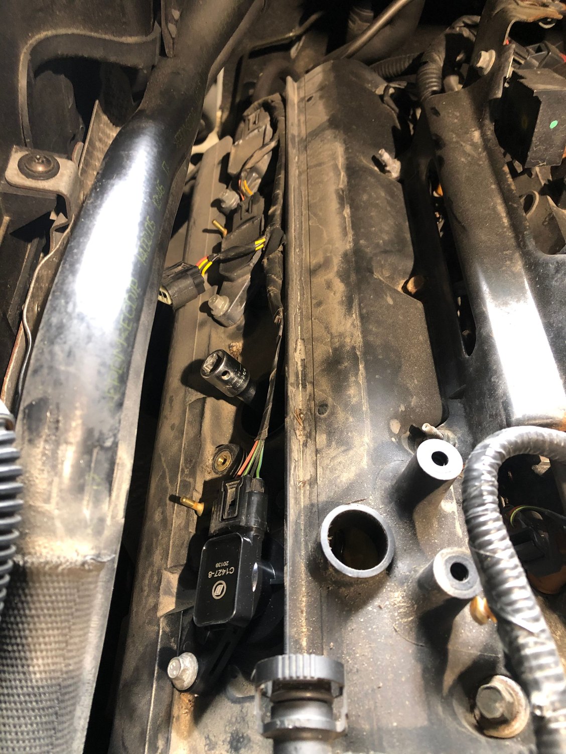

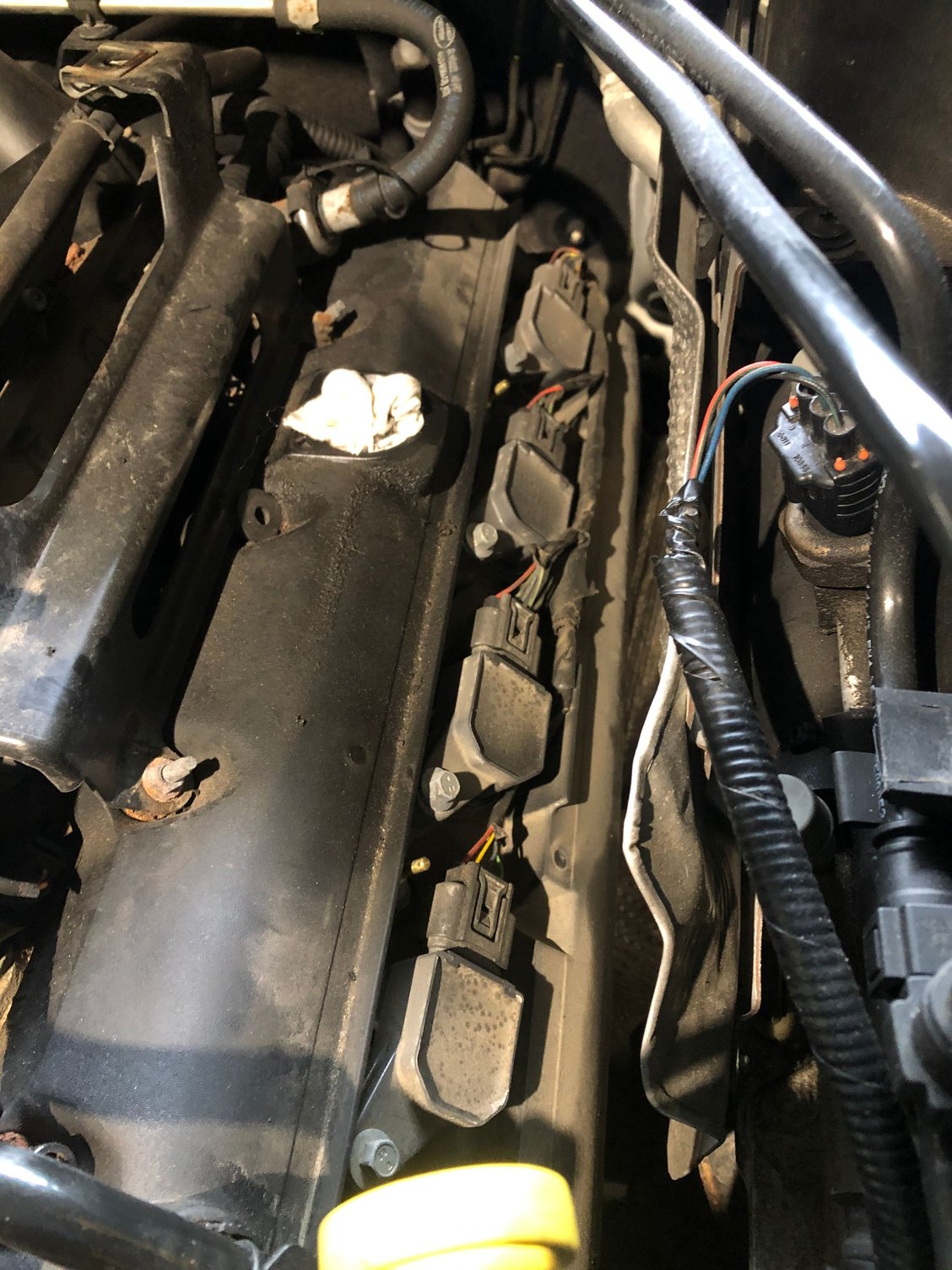

I’ve been busy with the old LR3. She’s got around 145k miles on her right now. Just started misfiring with a few cylinders. So I decided to go to town and change all the spark plugs and all the ignition coils. Turns out this is a super easy job. Runs so smooth and quiet now. Getting pretty good gas mileage now too. Around 11-12 in the city with A/C on and around 15 on the highway. I changed out the old K&N air filter for an OEM filter from Atlantic British. While changing the filter I noticed that the previous owner cut a 2” hole i the bottom of the air box. Why would someone do this?? Luckily air boxes are super cheap on eBay. Add this to the “To Do” rover repair list.
I also took out the blower for the climate control. I cleaned and lubed that thing up. Wow it’s so nice and quiet now. I changed the cabin filter too.
Recently I added a Curt bolt on towing receiver hitch. That was really pretty simple to install. Did it by myself too.
Rover is in access height and using a neighbors drop hitch. LoL. I ordered a 10” curt drop hitch so I can drive at “standard” height.
Old ignition coils and sparks.
So fresh and so clean. New coils and sparks
