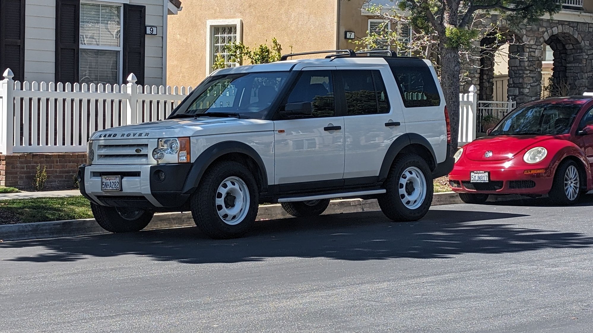

Default Got some new wheels and tires on
Saw a really good deal for 5 new Defender wheels and 255/70r18 tires. Jumped on it and installed same day. Used the Gap IID tool to raise the vehicle and increase the tire radius from 370 to 407mm (32" tires).
For some reason, the CEL came on, and codes with a P0501-00 Vehicle Speed sensor A range/performance (AA). No idea how that occurred.

There is a lot more to changing tire size than one setting. I wish GAP would develop a specific menu for changing tire sizes. I adjusted mine but read 2 over and in tight corners stability kicks in. So I am not quite right in the settings yet. Should be easy, its not.

Yeah...idk, though....these events might be independent. I switch between 30" tires and 32" tires; the former on 19s and the latter on 18s all the time. I don't need to do anything with my GAP tool. If you're worried about ODO and Speedo readouts, I think you're over-thinking it.

I don t want to side-track the thread, but tire calibration can be a bit important. On your average mall crawlers it would not matter most likely, but for those that off-road like you and I do houm_wa, a drastic change from stock size can have an impact on how the terrain response performs. Basically it comes down to math. Larger tire means changes in torque and other variables. Generally not a huge deal that will drastically change the vehicle's performance, but changes nonetheless. I would think that rock crawl mode would be the most impacted since its the most sensitive to slippage.

That sounds like a steering angle sensor or calibration issue.
