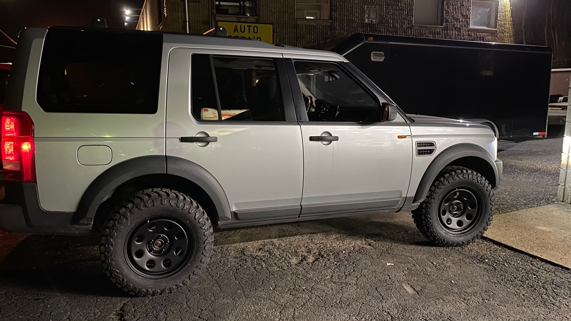

Default Finally mounted 275/65-18’s on Atlantic British steelies and 2.5” Johnson rods.
Old 19’s with gashes and a screw in the right rear I’ve been adding air to forever.
After! So happy it looks like a proper Landy

What tires are those? I like the shoulder lugs.
Old Nov 6, 2020 | 03:42 AM
  #1493
JOAT's Avatar
Joined: Nov 2019
Posts: 21
275/65-18 Atturo Trail Blade MT's

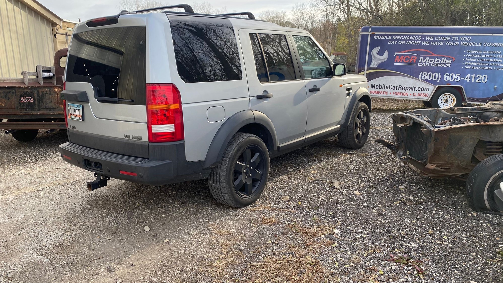

A little back bumper repair, referb, and mods: replaced a bad backup sensor, replaced broken body clips, bumper rust removal/repaint, added brake lights, and trimmed 2" off the bottom of the bumper skin
(This is at +1" OEM normal ride height)

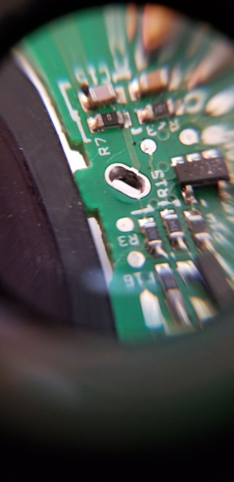

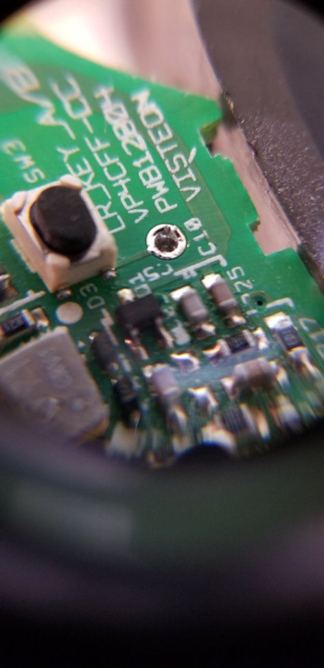

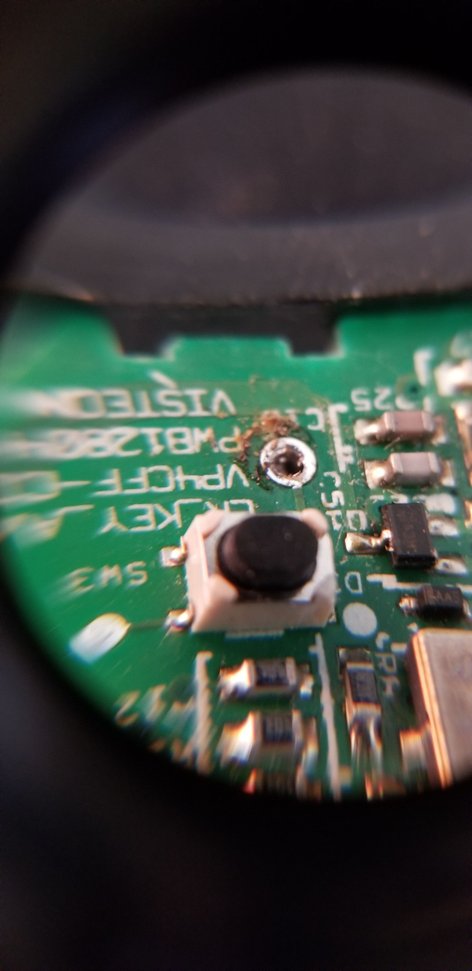

Today I removed the rechargeable battery from my key fob. It had started to act a little funny after replacing the housing, and I'm hoping the battery was just shot. It's not a terribly difficult thing to do with a decent soldering iron. New Panasonic VL2330 batteries should be here tomorrow. I hope this fixes the key fob. Fortunately, I have a spare that still works.
Here are some ultra-close-ups of the solder joints before and after cleaning.
