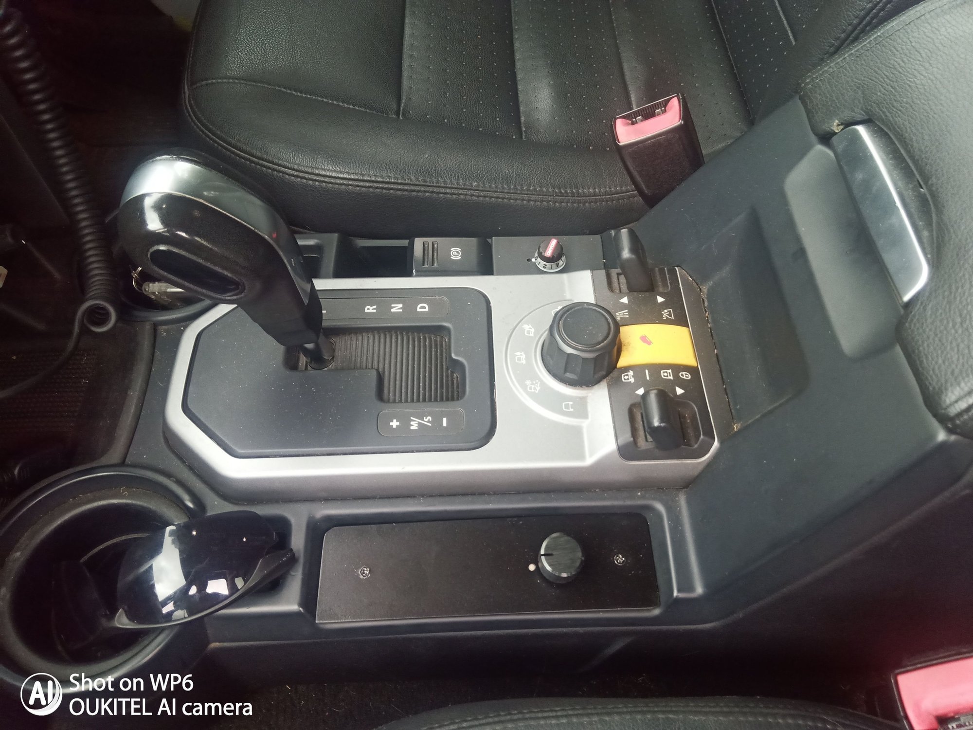

Made a switch panel for my electric brake controller but decided to move the llams suspension controller to it and put the EBC dial on my side.
