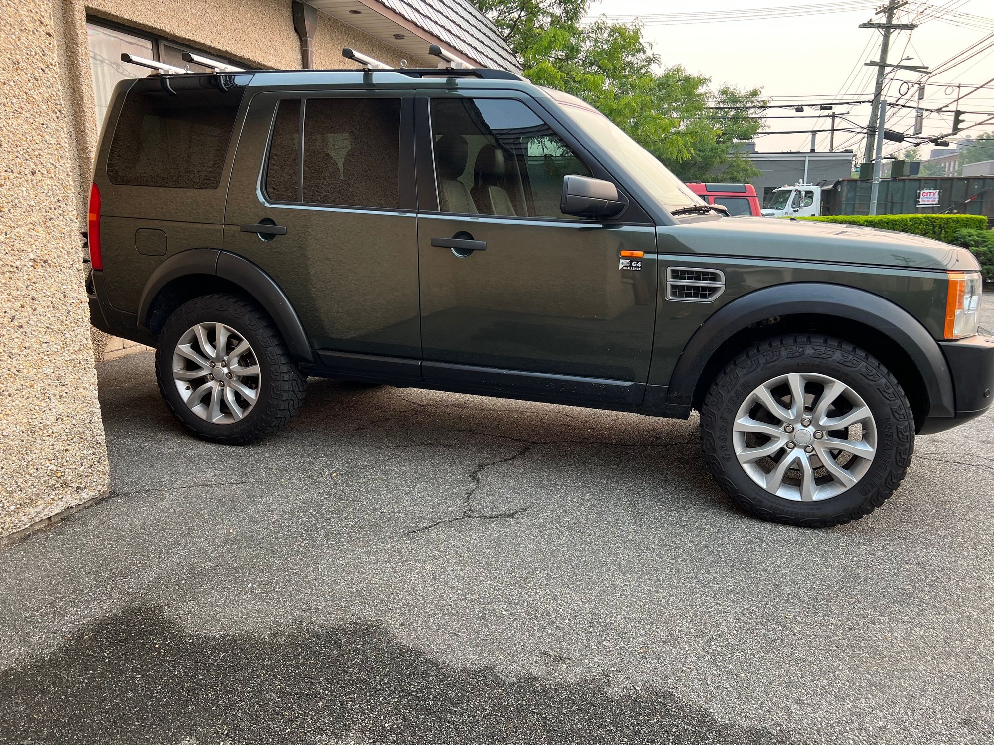

Hey there, LandRover Forums community! I'm DiscoRic, and I'm thrilled to be joining this fantastic group of off-road enthusiasts. A month or so back, I made the exciting decision to become the proud owner of a stunning white 2007 LR3. Since then, my off-roading adventures have taken off, and I couldn't be more excited to share my experiences with all of you. Friend took me on my first trail with his Disco II and my LR3 , Trail was a 4, not very hard, and in better shape than it reportedly was a few weeks ago. Had an absolute blast

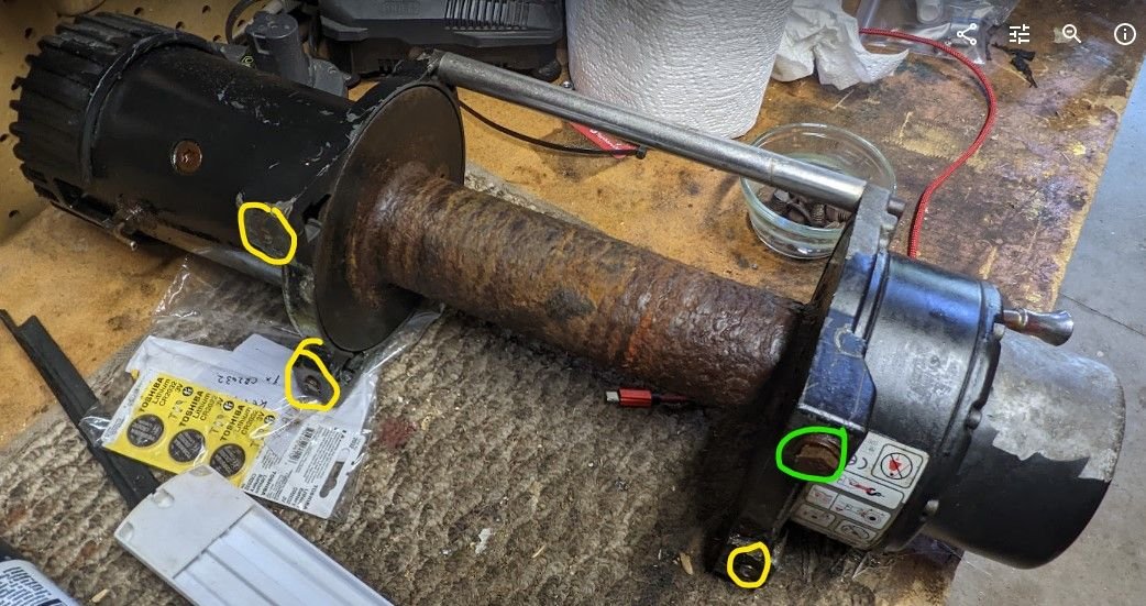

Hi Everybody, I am finally getting round to refurbishing the OEM Winch (Warn 9.5xp, factory installed option). I last did this about 4 years ago. I have taken it off and stripped it down - All internal gears, etc are very good, some grease is the original color, all grease is nice and thick, zero water or moisture inside the 'motor' end or 'gear housing' end, all gear teeth look excellent and fit together very well without any play, and there's just a few very small rust spots. Therefore I may choose to re-use the 4 rubber seals, since they have obviously been working well (new seal kit is part # 68615). There was one issue however - When removing the Winch from the winch tray (4 vertical bolts), 3 of them snapped (circled in yellow in photo below). Rust / corrosion. 2 bolts attach to part # 68606, winch drum support kit gear end, and 2 bolts attach to part # 68607, winch drum support kit motor end. If I cannot somehow get the 3 broken bolts removed, I will need to purchase these 2 parts - They are about $120 each I think. Let me know if you have any gathering dust in your parts bin... As part of the refurb, I will be repainting the entire winch - This will take some time, since I will need to clean, prep and prime it properly. Some of the metal is aluminium, and some is steel. May get a new set of stickers, if I feel like getting fancy.. I have a brand new synthetic rope and removeable hook. Will also be refinishing the A-Frame Protection Bar. And I will attempt to fabricate a decent winch cover, to protect it from UV / rain / snow.

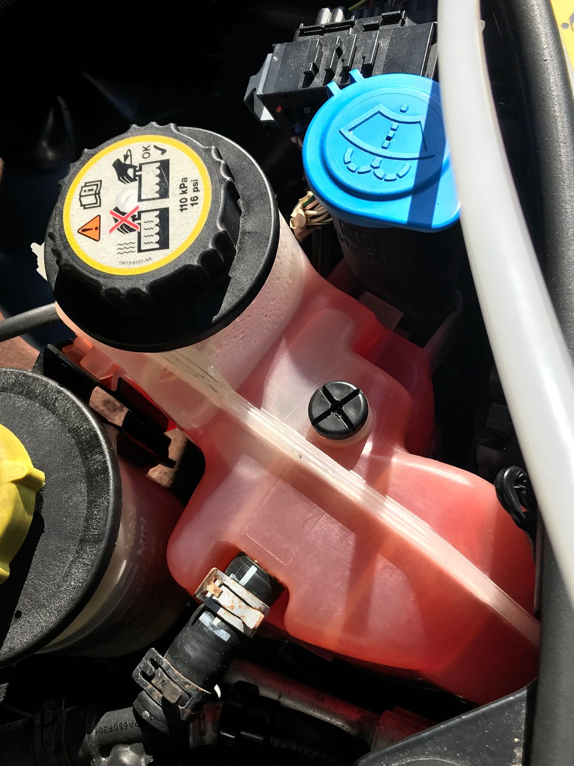

I managed to (briefly) get the LR3 on the road this week. The new tie rods are installed and I had the wheel alignment adjusted by a local performance shop. I decided to tackle some more of the preventative maintenance and replaced the coolant bleed valve Tee. I heard some air rush into the system when I disconnected the tubing so I decided to bleed the system. I'm glad I did this since I found out the bleed screw on my expansion tank was stripped out. The expansion tank also doesn't have the bleed screw in the same place as the OEM tanks or any aftermarket ones I see online.
Between this and the false "low coolant" warning i'm definitely going to replace the tank before driving. Does anyone have recommendations or warnings on aftermarket brands for this or should I just go for OEM? From what I have read so far it seems like Dorman, Uro, Britpart, etc. should be avoided but Mahle and Rein are usually alright and still less than half the cost of OEM.
