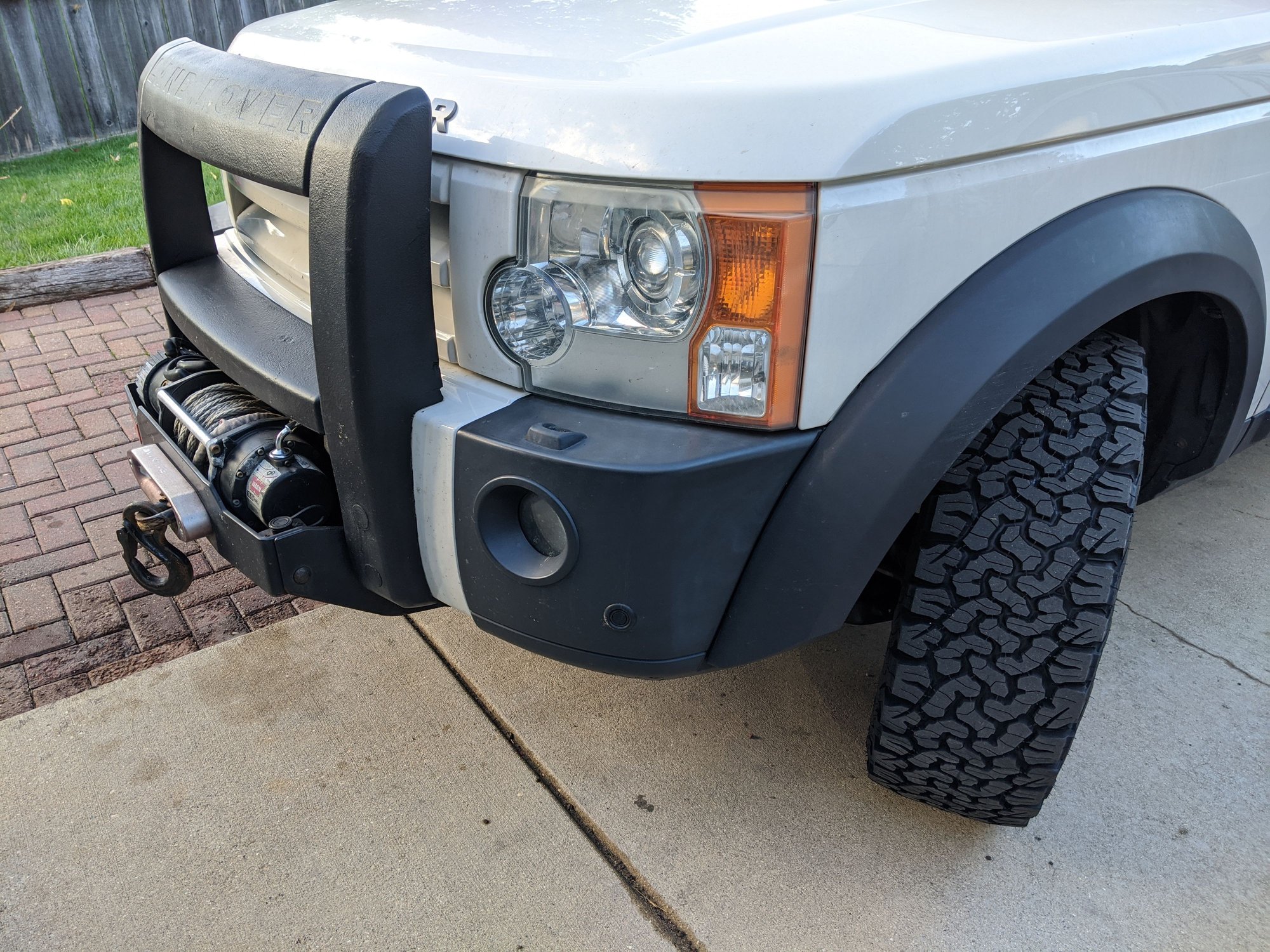

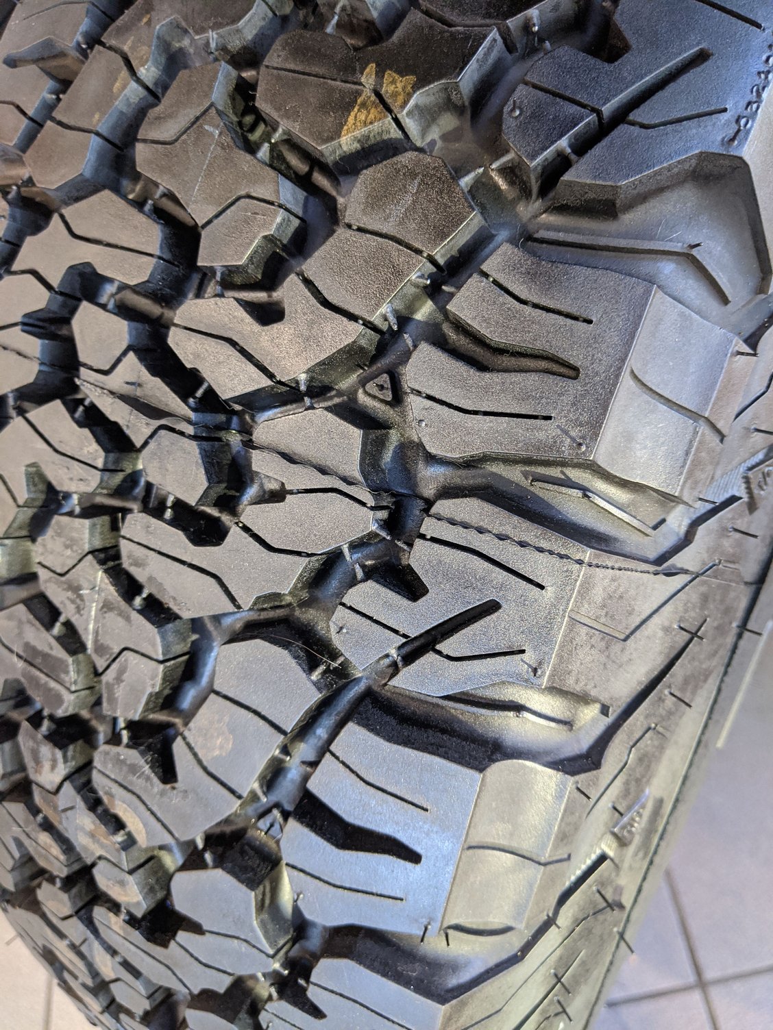

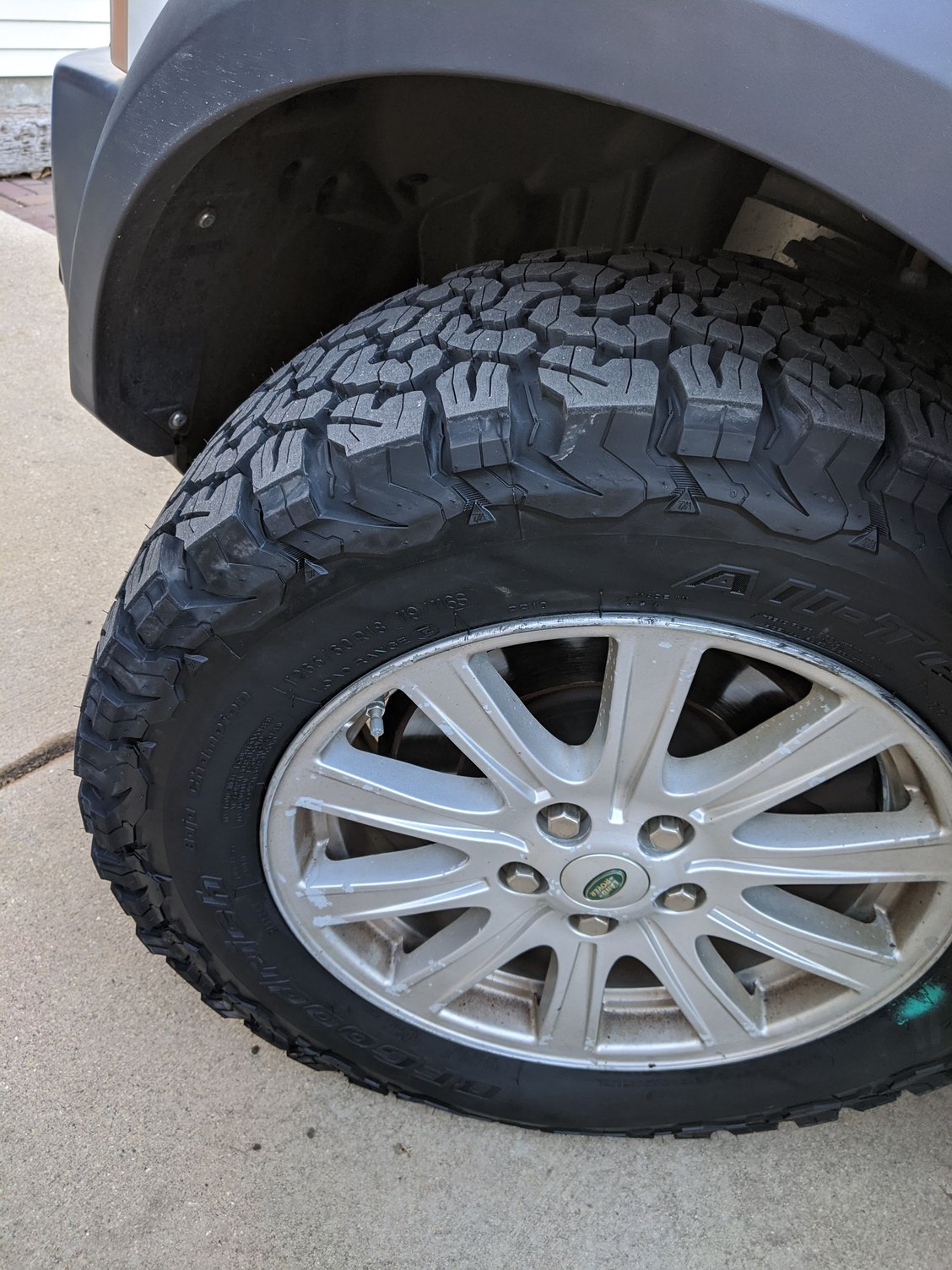

New shoes... BFG T/A KO2. 265 60 18. First impressions, at all speeds up to 70 for a few miles, extremely happy. Pleasantly surprised that they are as quiet as they are. Will probably not be going back to a less aggressive Tire, based on first impressions. Purchased Tires and installation from Discount Tires, including $35 per Tire 'replacement certificate'.

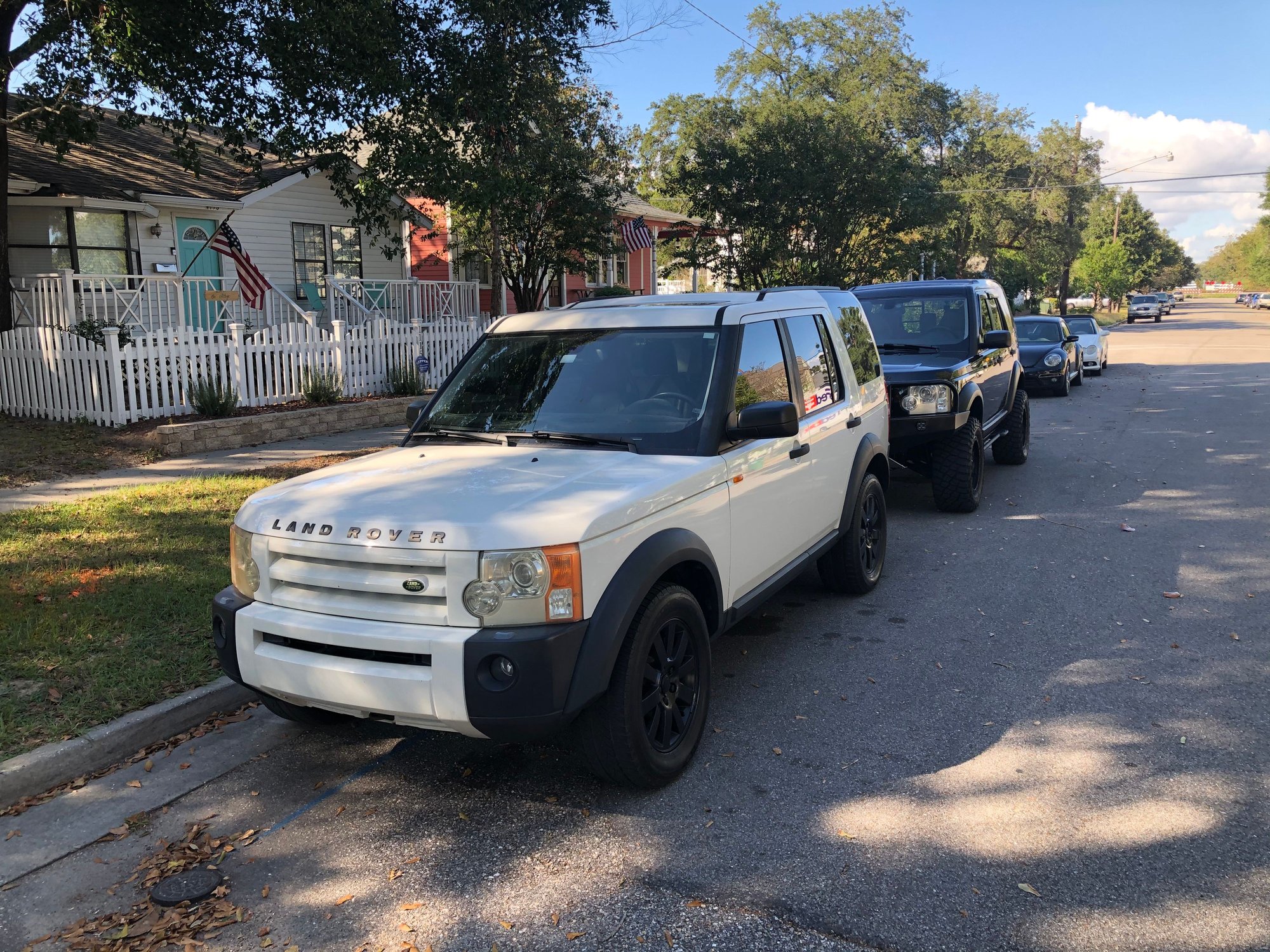

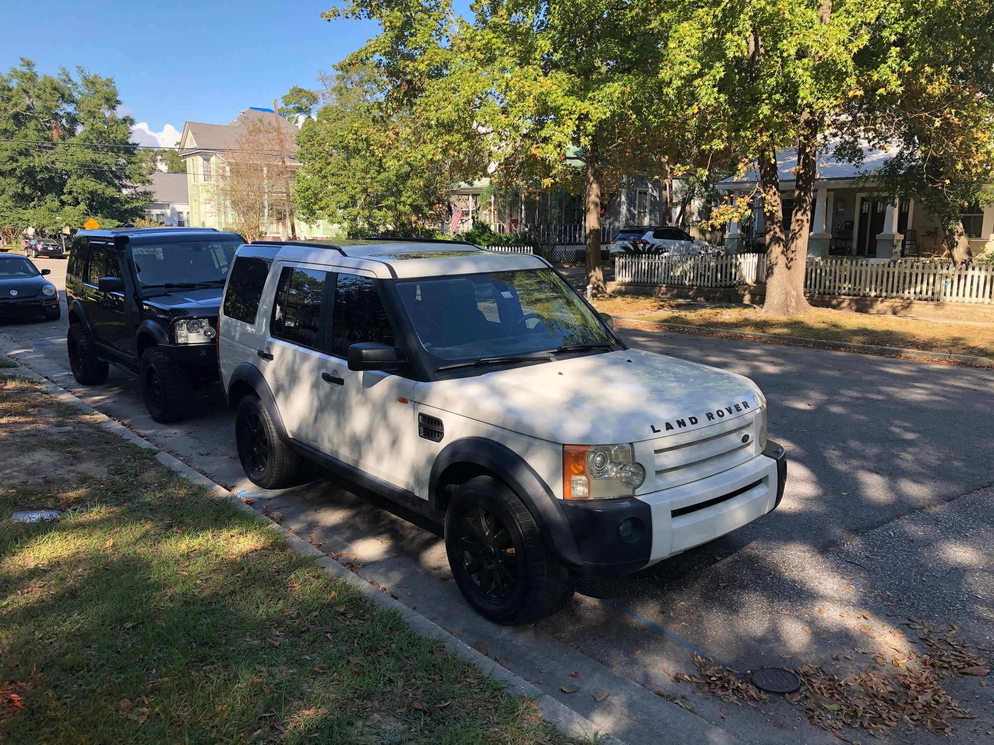

Picked up a new family member. My 17 year old son needed a car so I found a 2005 LR3 SE with low mileage. Being a dad I feel so much better knowing he is riding around in a steel tank compared to a plastic turtle shell. I’m going to detail it and give it to him this weekend. This is his first car I think he should be pretty happy. My first car was a damn 1986 Nissan Pickup

Washington, looks like a wonderful purchase! Appears like a warm place to be, we just had about 2" (5cm) of snow today and we are sharpening our snow shovels...I'm not complaining though...

Looks in good shape! Congrats...
...I bet you still wish you had the ‘86 Nissan pick up! They are doing well on BaT!
