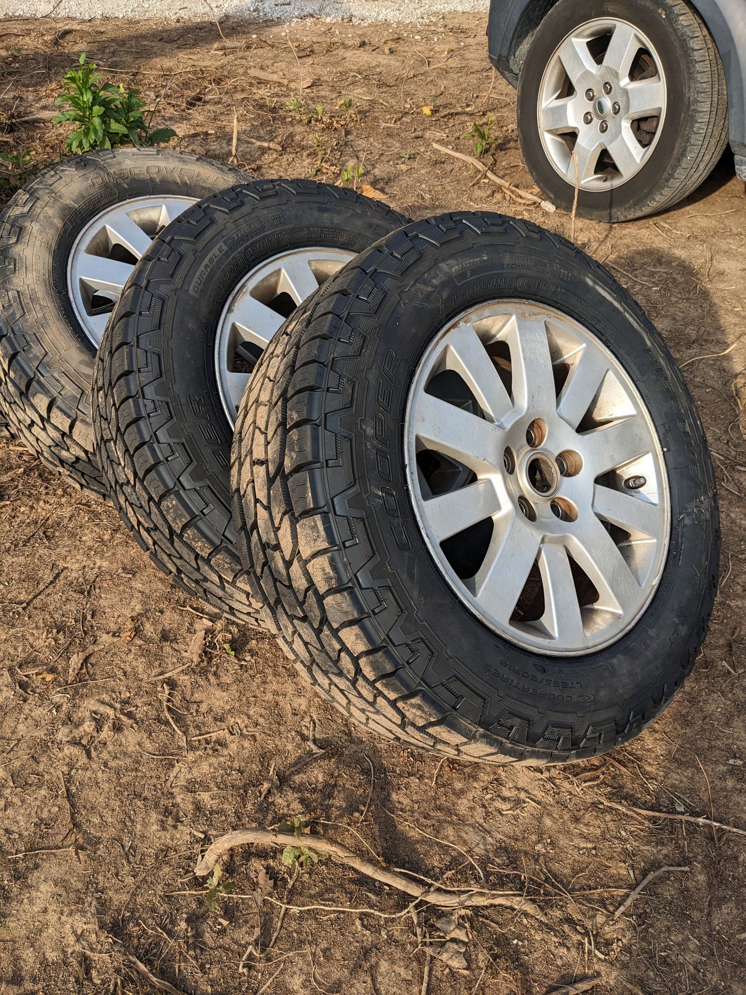

Default Put on new tires (again)
I had two sidewall blow outs in 8 days and I was forced to replace all four.
I had Cooper Discovery HT plus, and now I put on Cooper Discoverer AT3 these are LT 265/60R18.
Since I used the mall crawler to take the wheels in to be replaced, I have not had it off the homestead and out on the highway yet. But for off road work, they seem to be just fine, no rubbing or other obvious issues.
Tread seems a little more aggressive than the HT plus
