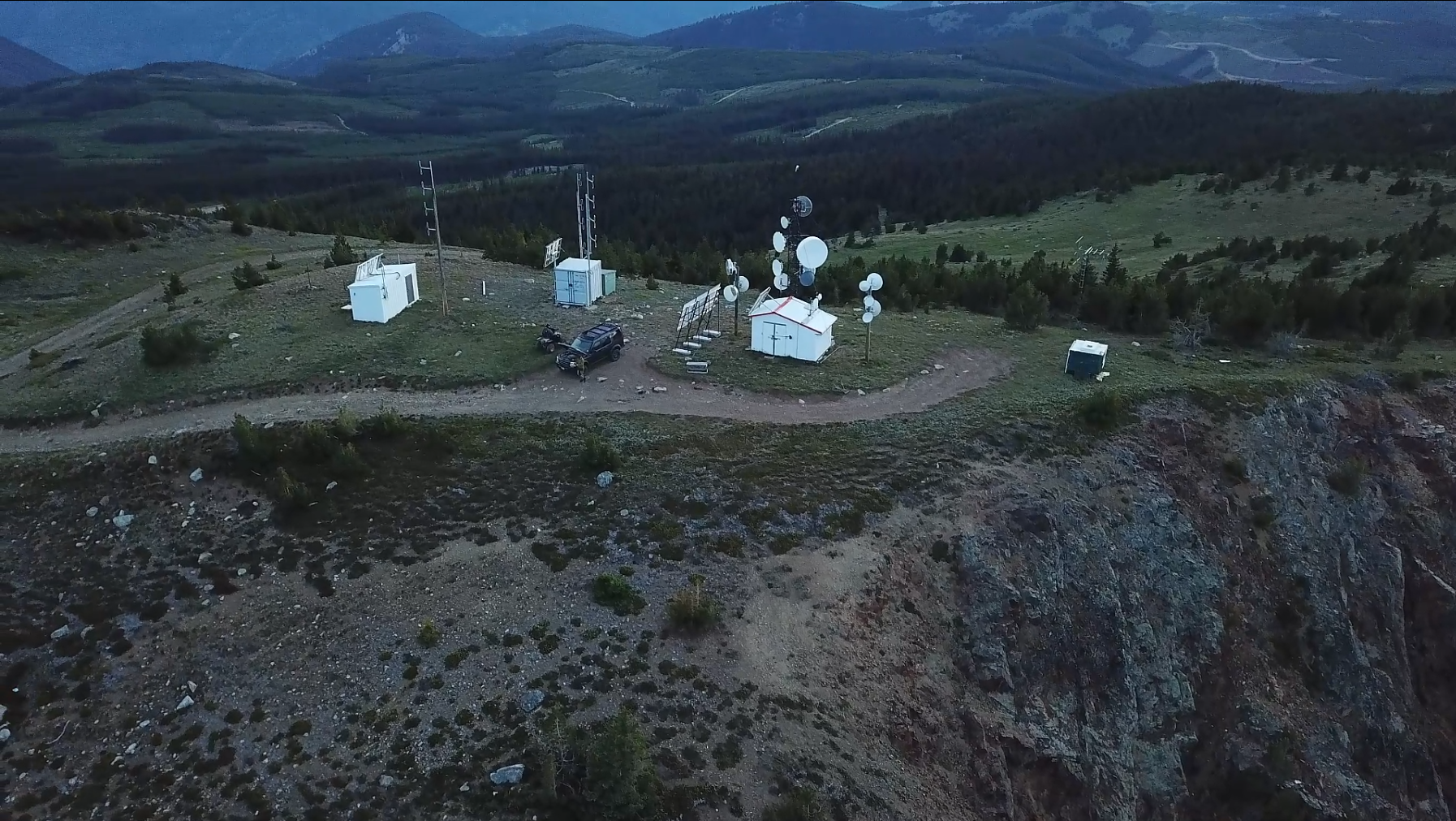

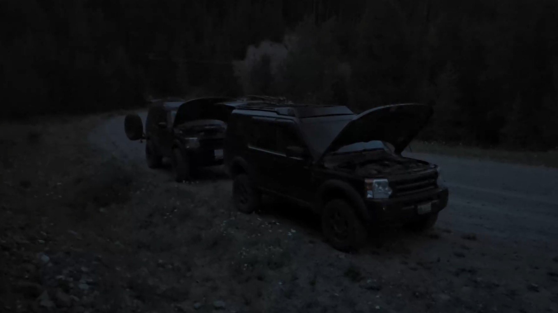

Had my alternator fail while on top of a mountain. Was running on 7.4 volts at one point! Check out the video to see something strange - at one point there were no interior or exterior lights or gauges at all, only a RED parking brake fault (parking brake worked fine though after replacing alternator) and the only other lights were the hard-wired steering wheel volume and cruise control backlights (I retrofit a 2011 RRS wheel into my 2006 and tapped right into 12v power in center console). Juggled batteries with a friend for a few days to get home. The whole ordeal made an already adventurous trip even more exciting!
low voltage, still going strong!
always bring a spare land rover?
convenient place for a fault, eh?
beautiful british columbia canada

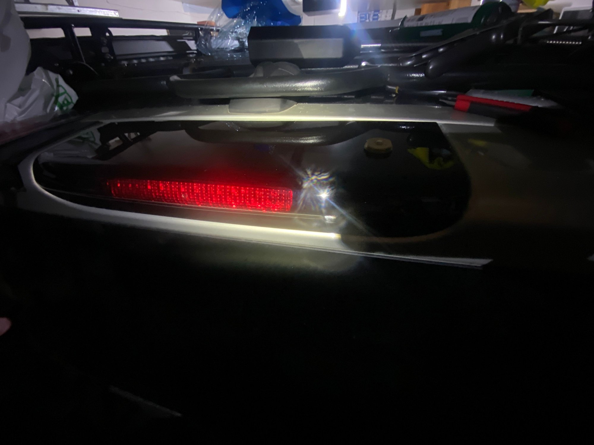

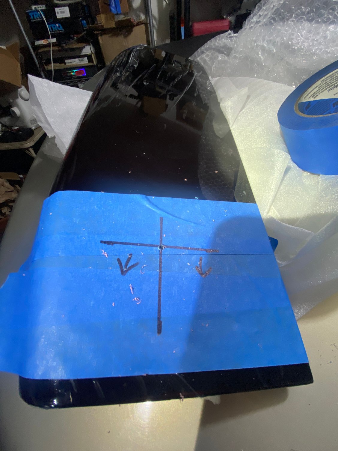

Finally replaced my third brake light. Bought the thing over a year ago.... Genuine LR part that I had to drill into for my GMRS antenna mount. Few things to know if you do this. You do not need to remove every last bit of the old sealant, the new stuff will bond to it really well. You need to make sure you really get the proper assembly, the LR4 one is apparently slightly different and will not fit right. At least the UK forums say as much. And you want to dry fit! There is a center locator that likes to ride up on top of its locating notch. So when installing you need to press firmly down and you slide it back and locate it. Once in place you should not be able to pull up on the edge near the sunroof panel. If you can pull up it is not correct and you will have a bigger gap along that edge. At the back by the LEDs there are two "pins" that simply make contact with the sheet metal, pretty much just stops. Make sure you clean any old sealant from those spots so you know they will land on sheetmetal and not a couple millimeters of old sealant. I used 3M windshield sealant at $20/tube. Removal of the old was a pain. I will be finding bits of this thing for years in my garage.
