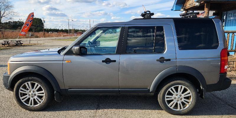

New to me '09 SE. Black with 155K miles. Dash is cracked so I picked up a cap on Amazon. I spent a few hours trimming, and probably should have done more. It fit pretty well and looked better than the original dash. Installed per directions and let it sit with weights on it for 24 hours. It was fine for a couple of days, then the Texas sun warped it near the windshield on the passenger side. Bought a carpet mat and stuck it on there until I decide how to take the cap off and try a better brand.
Picked up a 7" Android Auto screen for maps and streaming. Works pretty good with a wireless bluetooth adapter to the AUX input.
No CEL, and looks like all service is up to date from the provided records.
A couple of things I need to do:
Repair some loose stitching on the passenger seat. I bought a kit from Amazon, so I'll try that first.
Second sunroof shade has no clasp to lock it in place. this is Texas, So I need to come up with a fix.
Shampoo the carpet. Previous owner was female, and it still smells like perfume.
A pillars fabric loose, but may wait and have the headliner redone. There's a few places that it's starting to get loose.
Program a couple of more keys. I did one with my Otofix D1, and I bought a 2nd one since the original died.

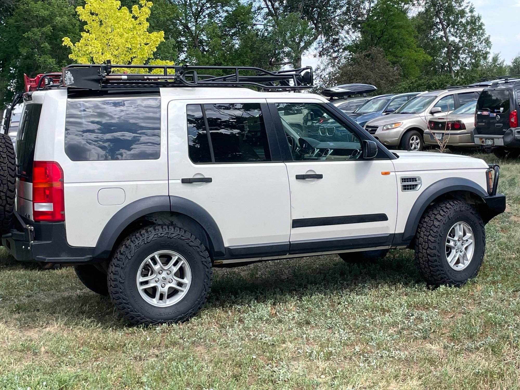

Moved to the 17" inch rims and installed a set of Mickey Thompson Baja Boss AT tires, in size 255/85r17 (34+"). Lots more sidewall for off-roading now. Rides beautifully on road and off, although I am waiting to reinstall my sliders before I do any serious trails (having them re-powder coated by a professional shop).

Sweet! How are you fitting those without rubbing?

The 255's probably allow them to just sit inside the guards but i would expect them to rub on articulation and forget driving if you end up on the bumpstops.

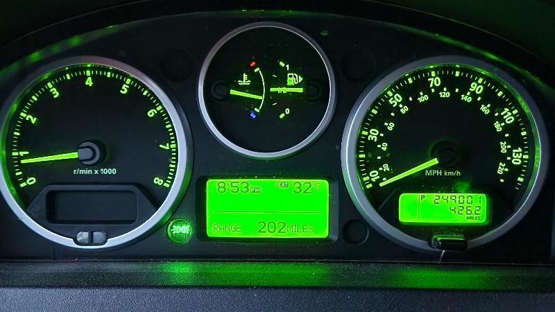

Just cleaned the MAP Sensor and just hit 249,000 miles. No dash warning lights

I installed a 2.5” lift kit and did work to remove anything that was rubbing (framehorns in front and moved heater hoses in rear). The 255 width is perfect for this truck.
