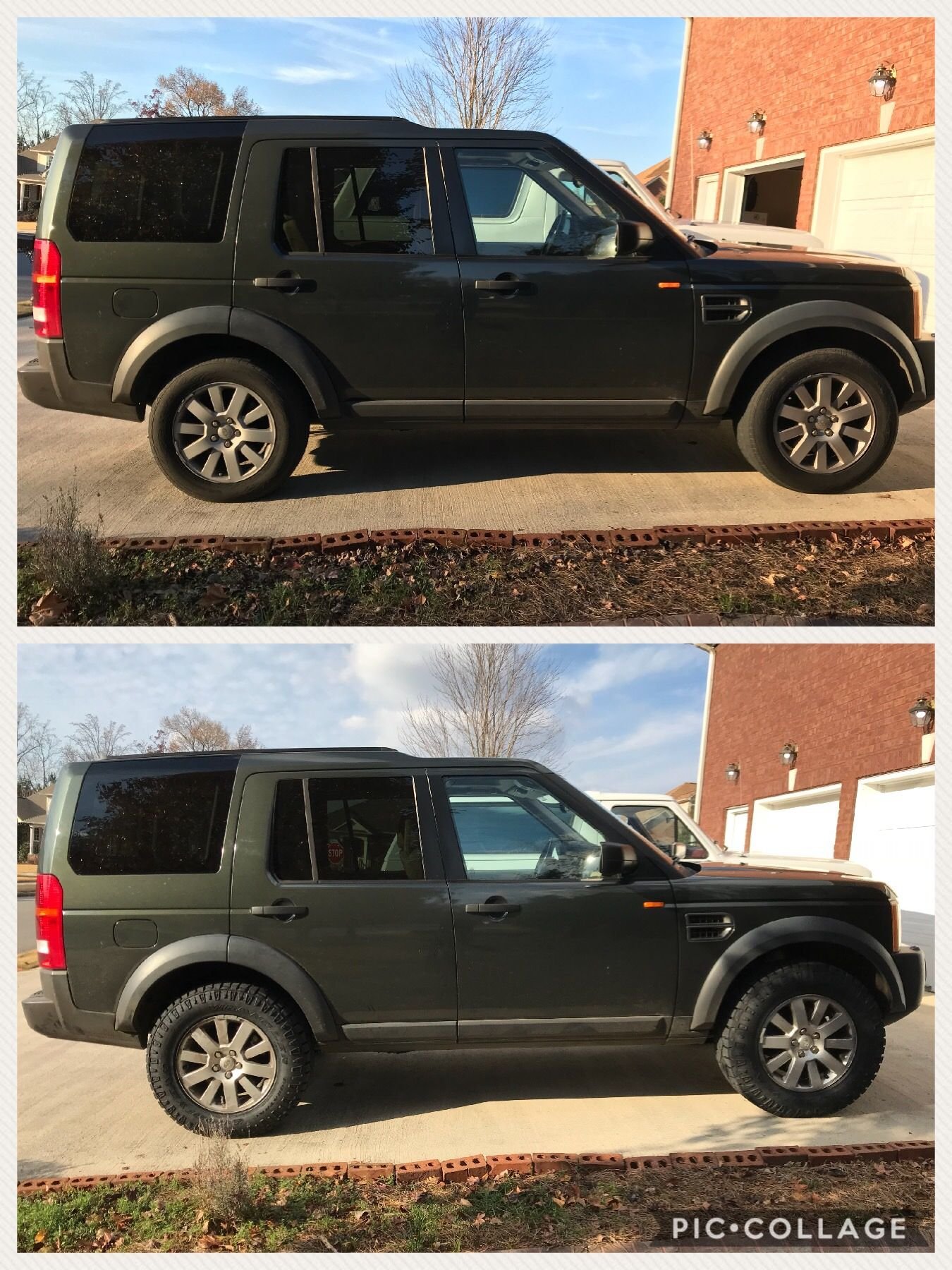

Went with the lift rods and Goodyear Duratracs in 265/65-18. Ride is great and road noise is minimal. Quite an improvement in the looks and stance of the LR3.

Thank goodness....at first I hadn't scrolled enough and saw the "before" pic and said 'wtf that looks like dog****' and then kept scrolling. Those tires make a huge difference! Nice job...

Hey guys.. I forgot to post the before and after measurements I took on my ride. The first set of measurements was with stock tires at normal ride height, the second is with the rods and new tires at normal ride height. I took the measurement from the ground to the bottom of the plastic fender flare centered directly above the wheel hub.
Before: Front 32" Rear 33"
After: Front 35.5" Rear 36"
If you have any questions let me know.. I drove it everywhere this weekend and am really loving it so far.

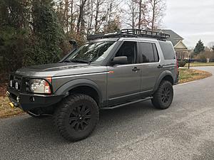

My LR3 is finally able to go off road and not freak out and throw a fault... replaced the reservoir EAS block which I am convinced had an internal leak, this causing pressure spikes which triggered a suspension fault.. not too bad of a job... the lucky8 slider is not too bad to take off.. once you do it 5+ times... I also fixed the AMK compressor mounts which were not right and modified the slider so it no longer touches the EAS compressor housing Quieting it down considerably... PAS as well, when you recalibrate the suspension with the Lucky8 2.5” bump-stop kit you need to add in the height of the bump stops/Rods to the calibration measurements...so + 64mm.... once I did that, I can use Access height mode again.. which was a big win too.. a quick test confirmed that I now have all three modes with no codes and it articulate without throwing a fault.
I totally failed at adding in Front heated seats (trucks not wired for it although it does have the temp sensors in the seats, not sure if its only the wiring from the Climate control module to the in side fuse panel/kick panel connector or more.. I gave up and reinstalled the non-heated seat panel and removed the option from the CCF via the IID tool. I guess I'll go after market for front heated seats, the rears seem to be add the switches plug and play if I am reading the inter webs correctly.
Oh and also changed the Tactical rovers rear jerry can swing out to a dual one.. I had a gift cert I won at the spring Uwharrie event which covered it so why not. Picture is on its high setting..
