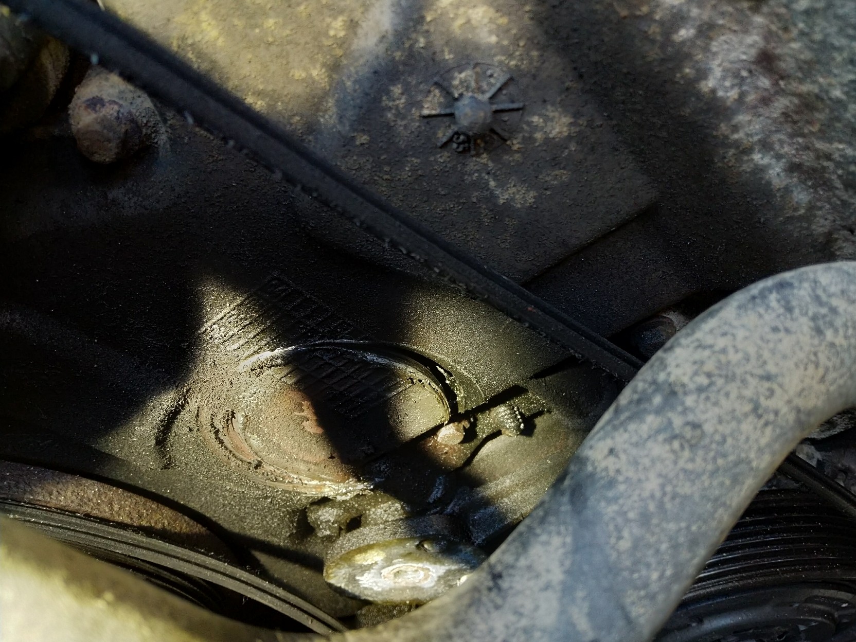

Got on the road to Winter Romp, around Staunton VA. The timing tensioner blew apart, lost the main belt, aux belt, thermostat housing and cut through the timing cover.
Got put back together at Land Rover Alternative in VA.

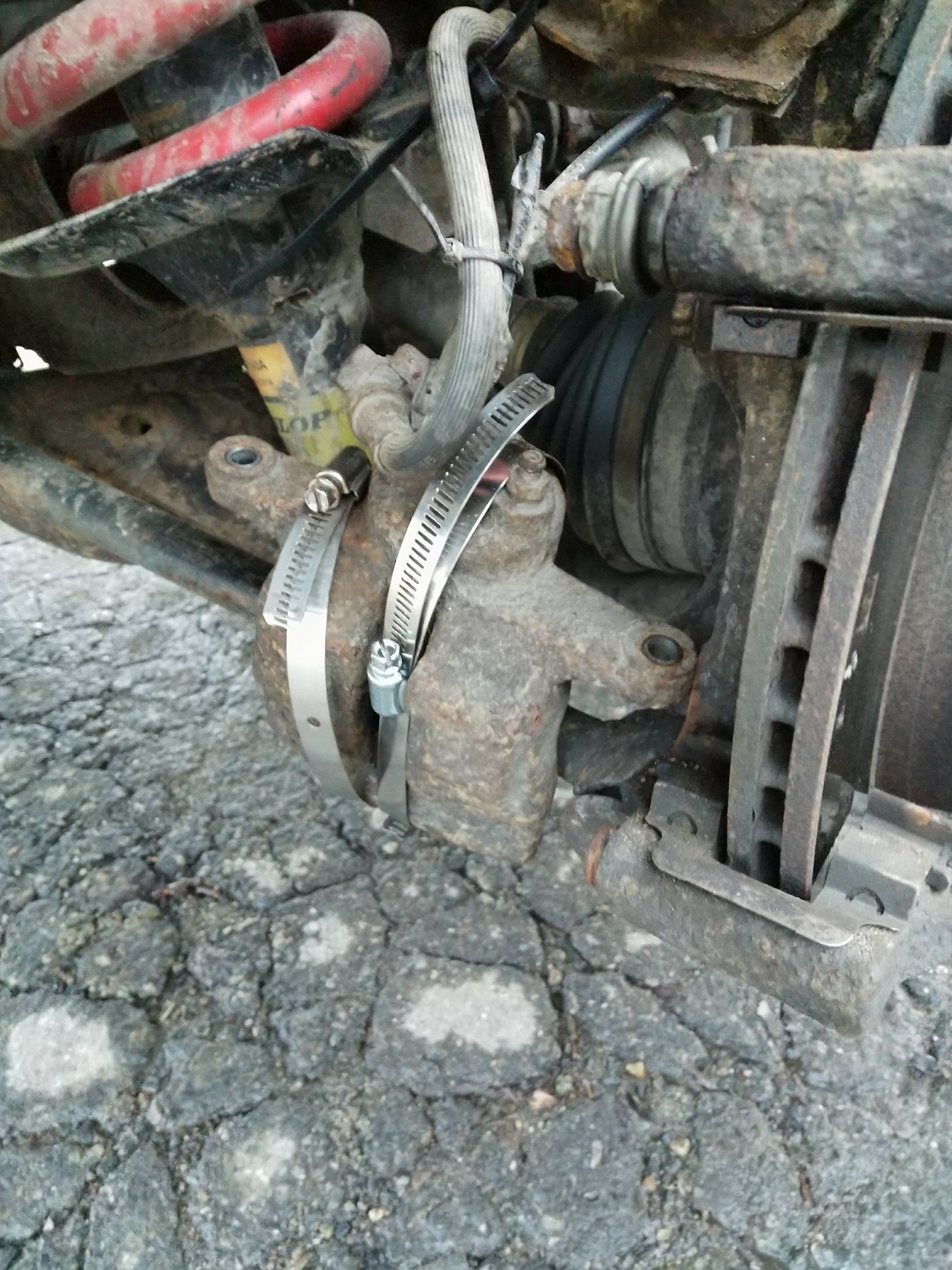

Saturday found out what the brake noise was. (see above) and how bad the damage was. Clamped the caliper to the lateral link and secured it with hose clamps (thanks Don owner of Anarchy Fab for the great idea). Also picked up my new to me Roof Top Tent and Warn VR10000s winch.
Made the run across to Lucky 8 in Buffalo, 30 mins later the brakes were repaired and I was back on the road to GA. Got home Monday late afternoon.

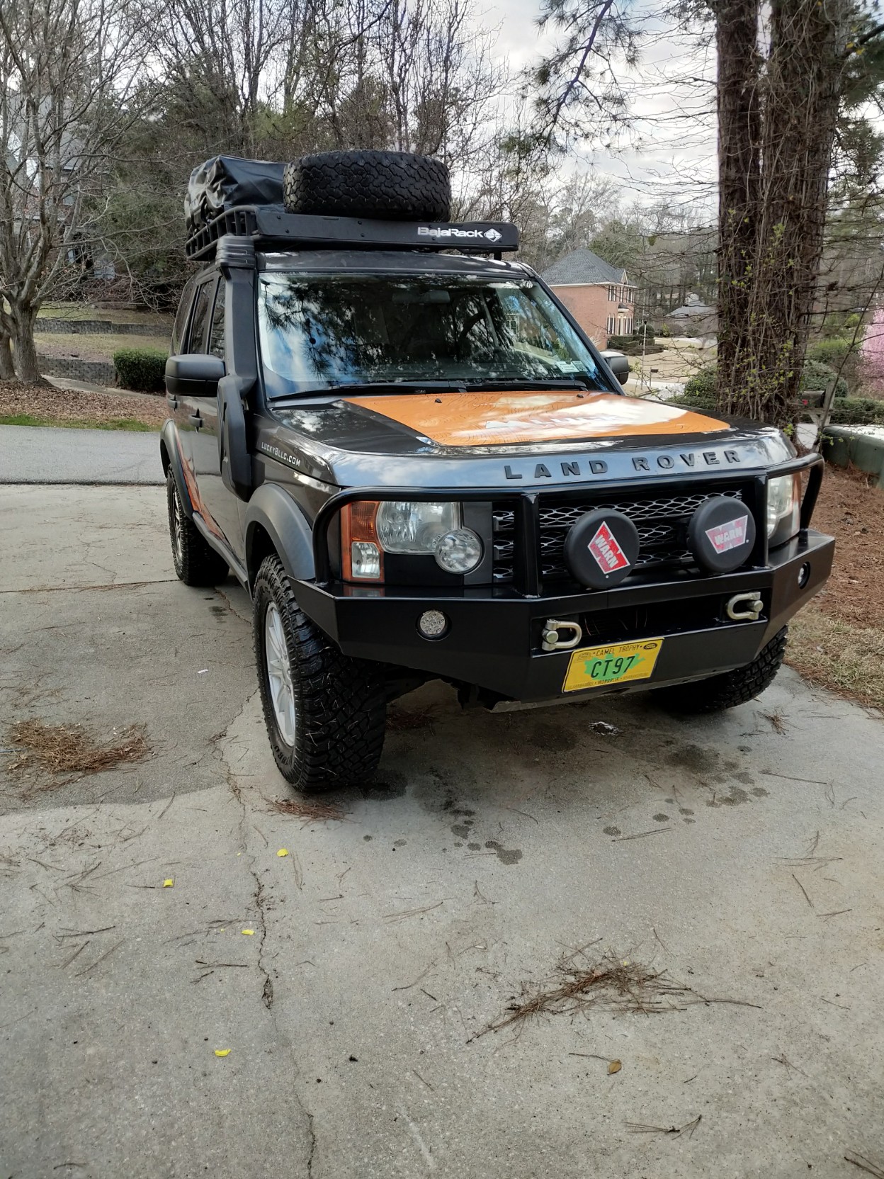

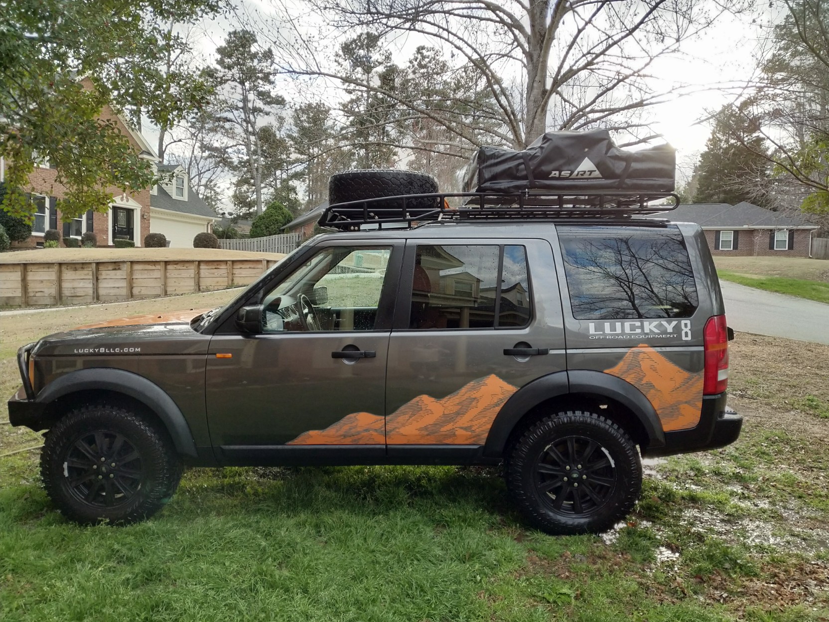

Today I cleaned the LR3 inside and out, fabbed up a front mount bar for the Roof Top Tent so no more ratchet straps holding it down. Mounted a spare on the front part of the rack. Added bonus is that putting the spare there cut the wind noise down considerably.

Abran, No got lucky just destroyed the cover all is well in the motor so far.
