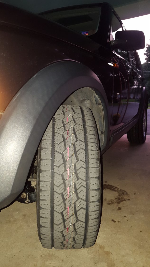

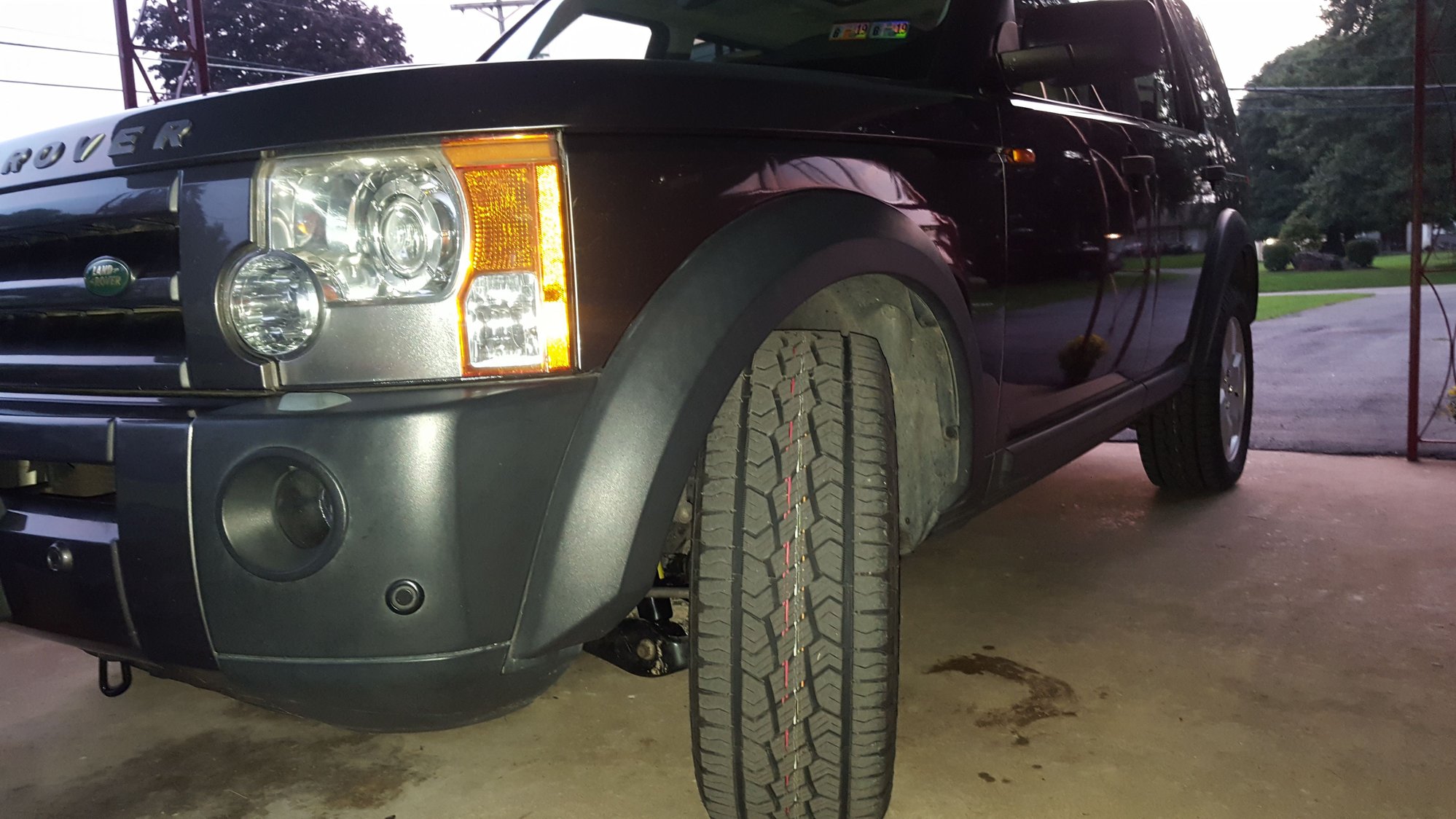

Default New shoes
Just got 5 of the continental terraincontact installed today, looks like they should preform pretty decent. Can't wait to try them out on a logging road on labor day.
