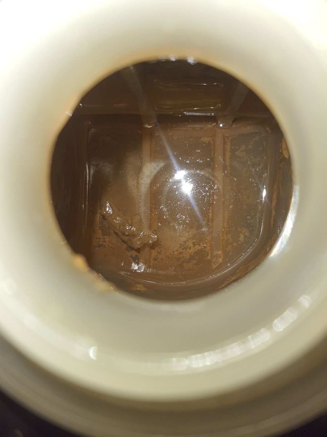

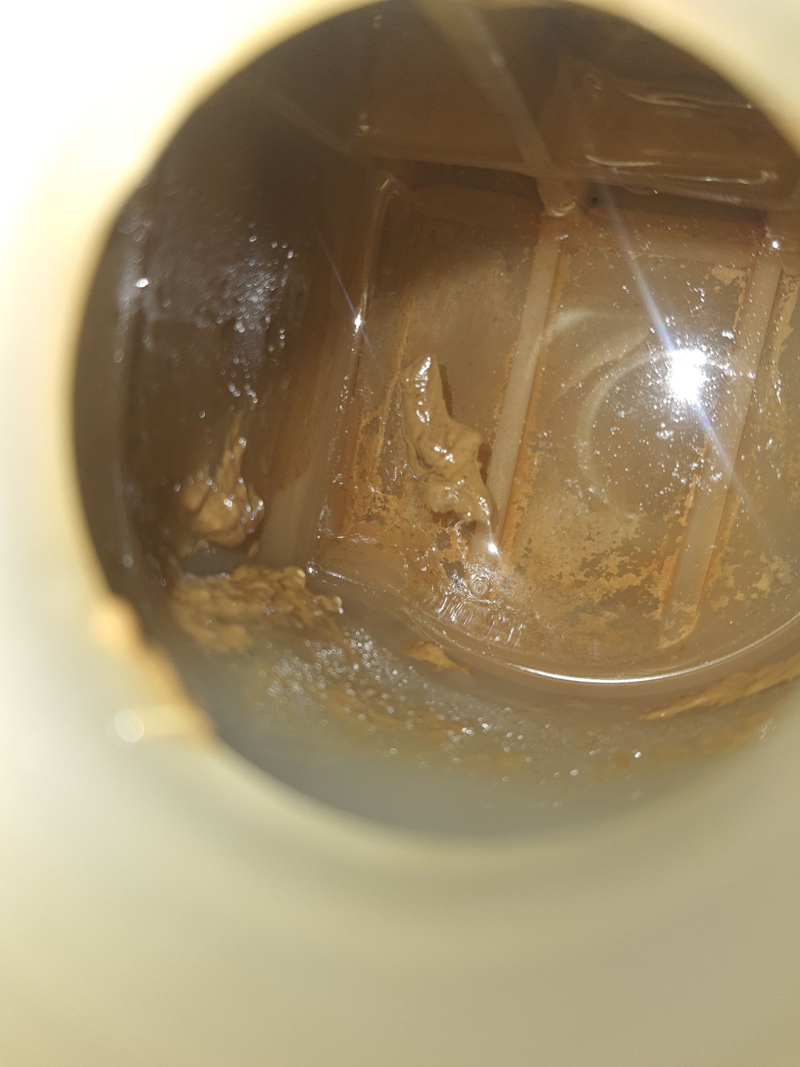

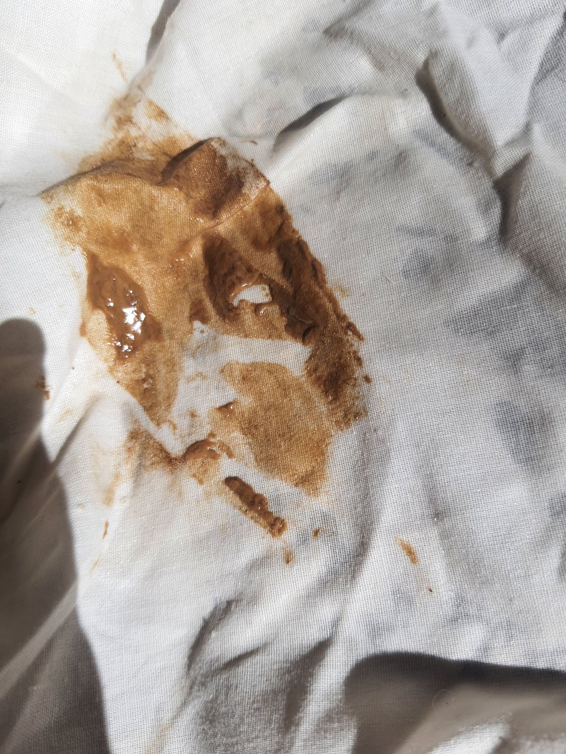

I checked my Expansion Tank level and witness something else in the tank I don't know what it is...
What is this in the coolant tank

looks like at some point someone mixed in the wrong coolant type. When my son had his LR3 in Germany he claimed he couldn't find dexacool and put another coolant in it. When he came back to the US, I drained everything and found something similar in the expansion tank and some of the hoses. We were replacing the waterpump anyway so just replaced all hoses and flushed.
