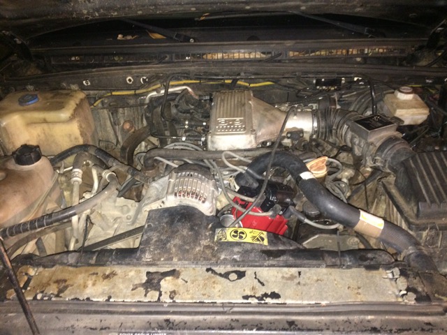

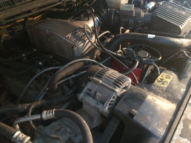

I am running an HEI dizzy with integrated coil in my 95 Disco 1. Best mod ever. Completely waterproof and the motor runs a lot better with it. Removed all the old ignition parts but didn't have to modify the wiring at all so can flip back to stock if required.
Fitted a connector on the +12V wire that feeds the coil and used that to trigger a relay with a new direct +12V feed from the battery. Ran a wire from the HEI back to the stock wiring for the fire indication wire that signals the ECU for fuel.
Had a local engineer trim down the shaft and fit the Rover drive gear onto it. Cost me $60. Had to remove the front lifting eye and modify the top radiator hose but didn't need to modify the PS pump at all.

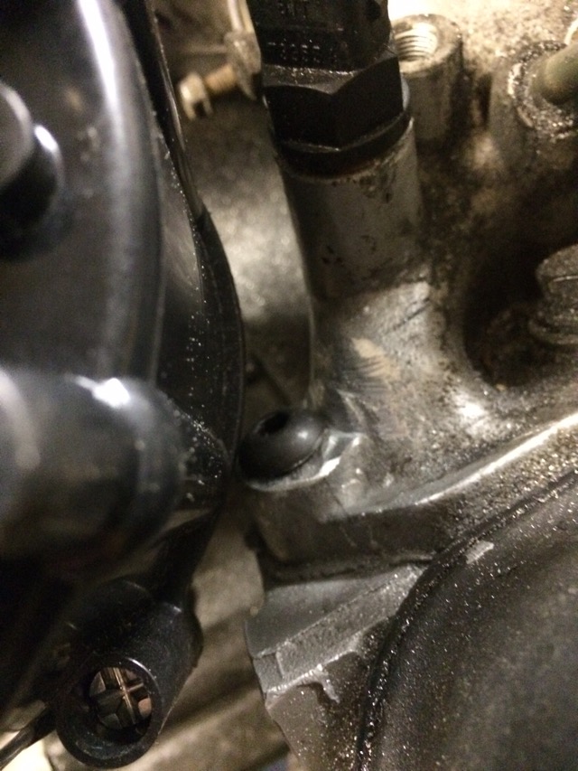

Did you have to mill the intake manifold? If not, did you have to do something to the upper radiator hose?
got a pic?
rover drive gear fit the 76 buick century distributor I used

I can't find the original purchase info for the dizzy. It's a SBC HEI unit, pretty sure it's a Mallory or at least it came with Mallory leads that I didn't end up running. Used stock leads and changed the ends to suit the new dizzy.
You can see the relay up by the washer reservoir. Ran a feed from the passenger side battery with an inline fuse up to the relay.
As you can see I modded the top hose. Very simple, bit of tube and some clamps. Going to rework the top hose spacer section and put a bracket off it to stop it from moving around.

manifold clearance required. Also PS pump, but I'm not using the stock one so no pics of that.
