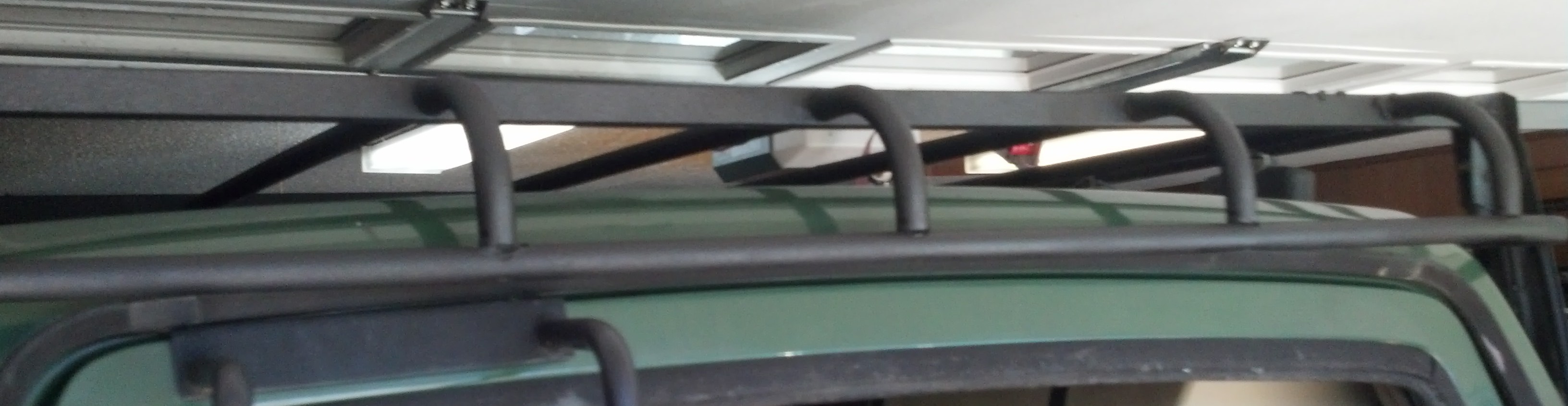

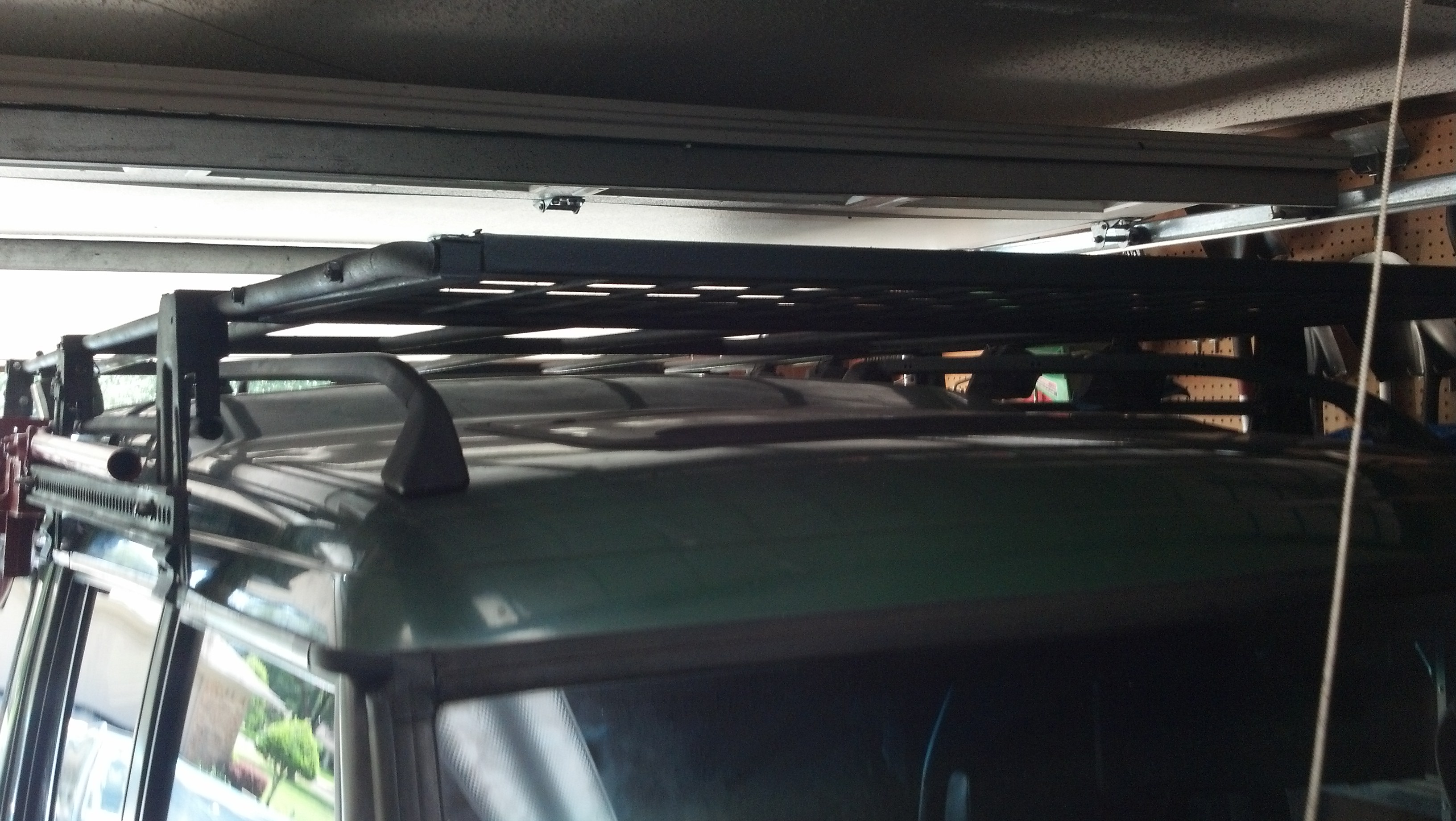

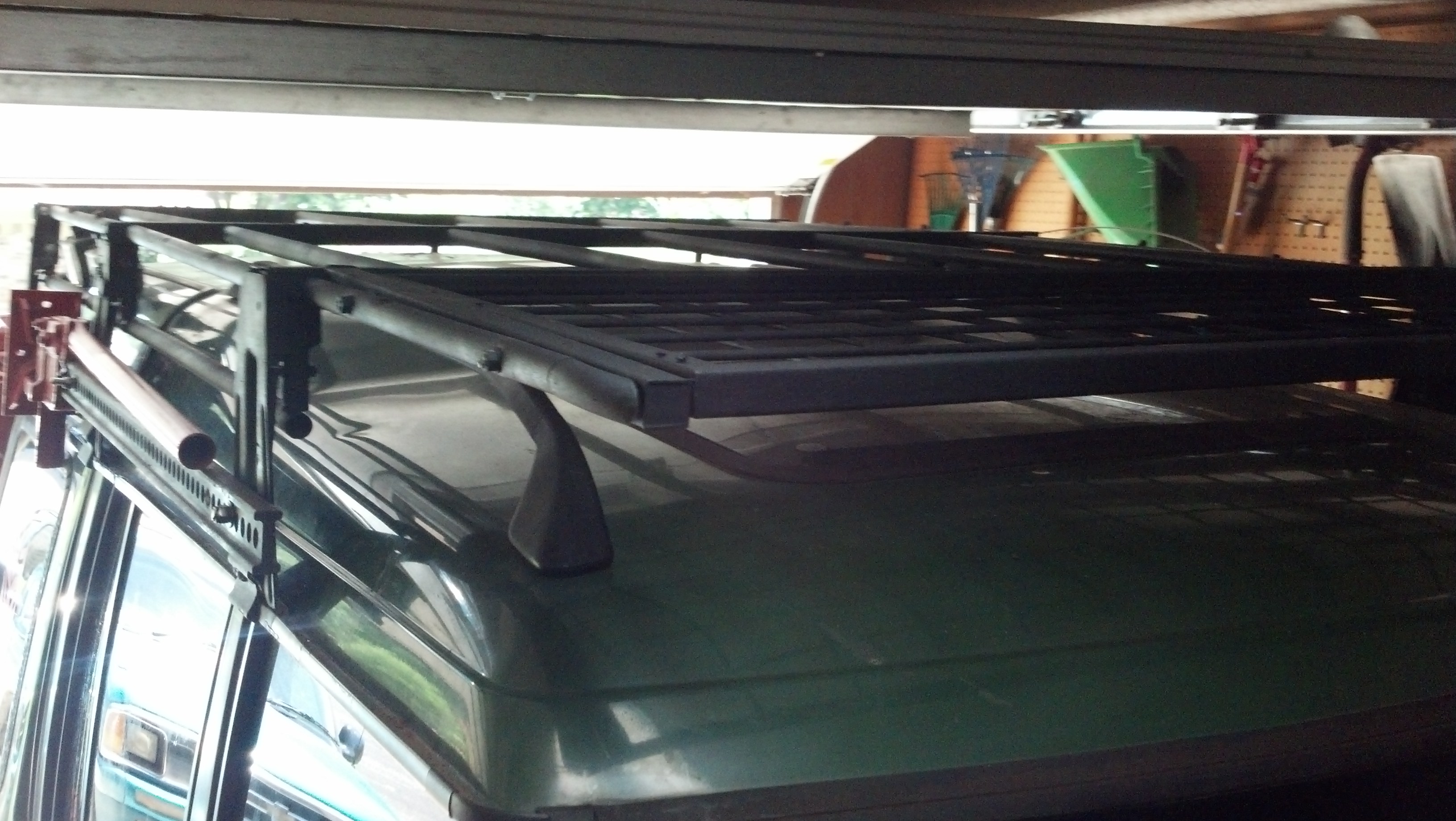

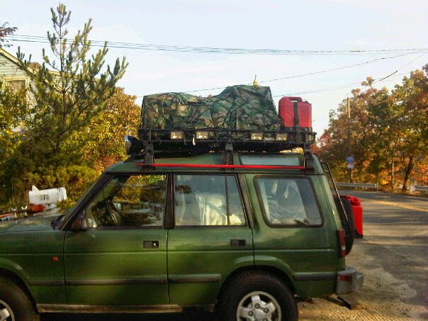

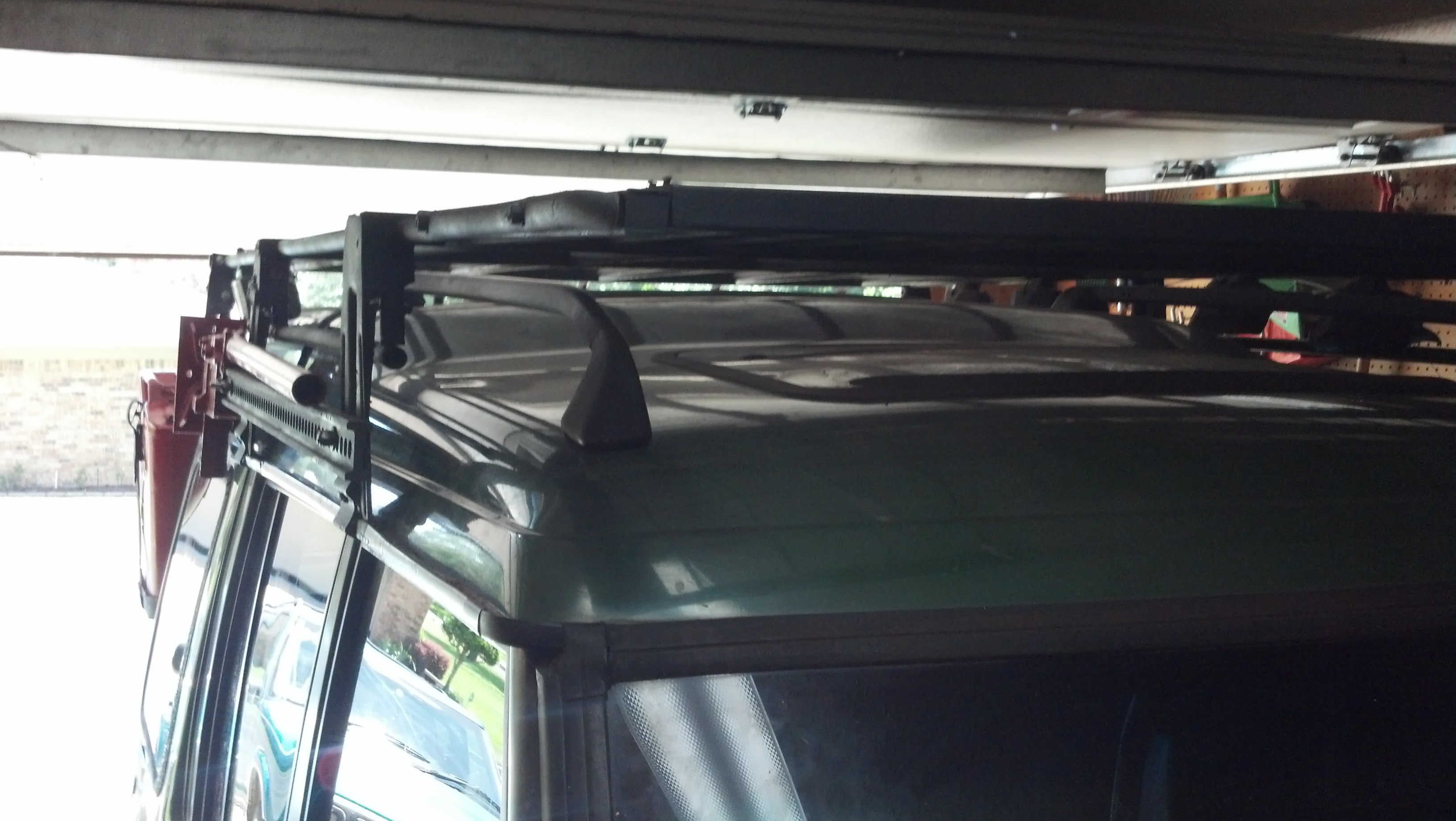

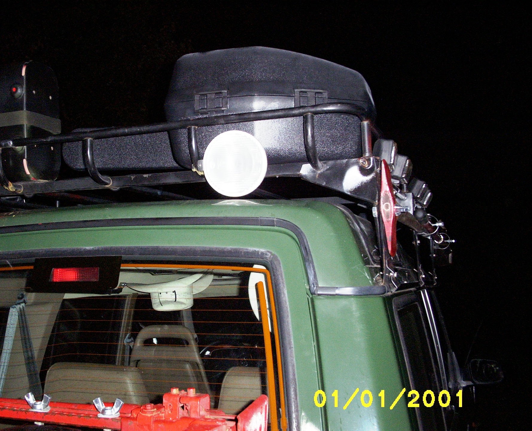

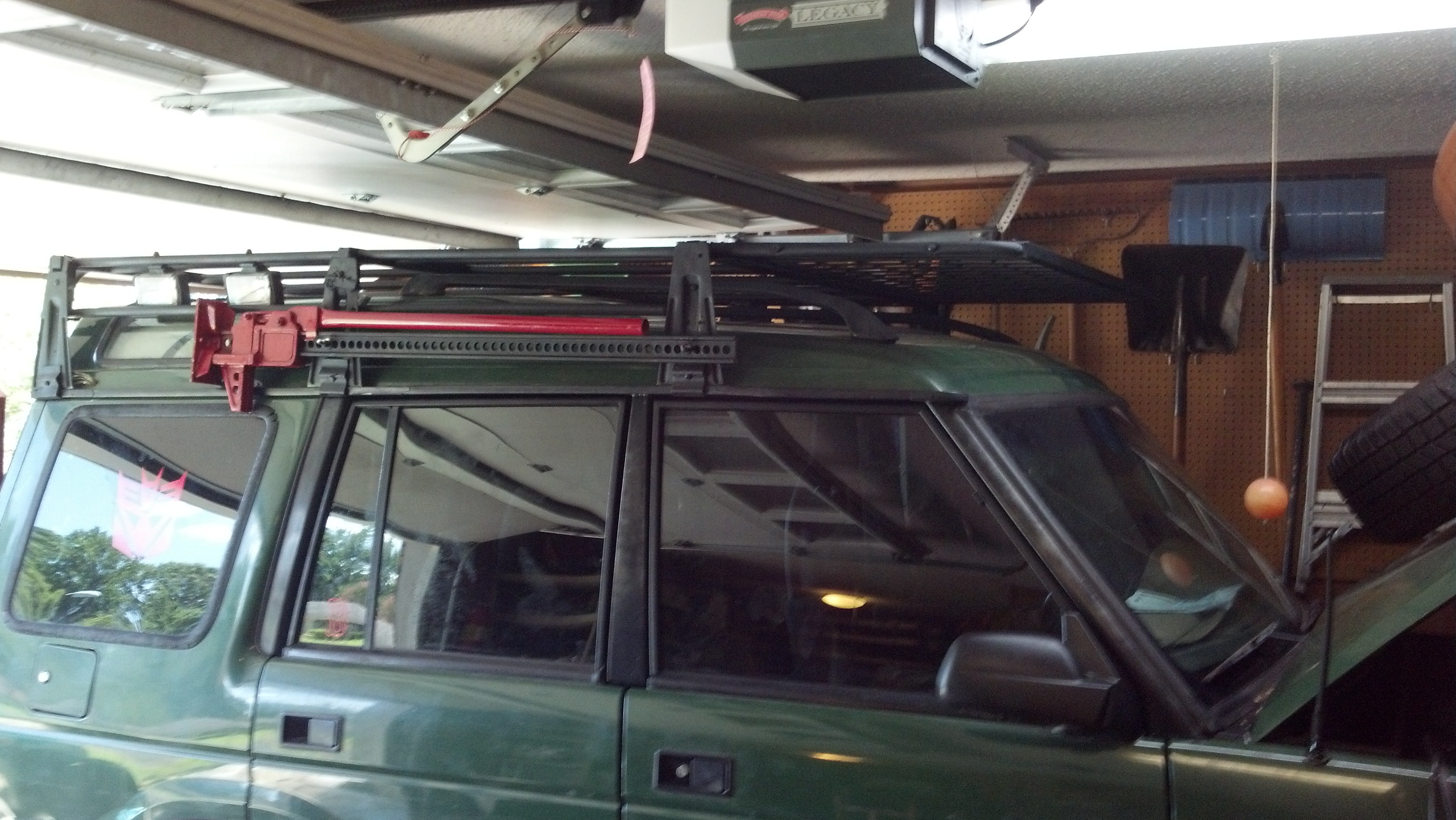

I have had this roof rack through 3 Dico's now and I wanted to either get a new one with better clearance or rebuild this one. Being cheap, I decided to to go with the latter.
I have daughters that live out of State and have to pick them up from the airport often a well as work in major metropolitan areas, that often require me to park in garages, thus the reason for clearance.
I originally bought this used down at the cape for $100.00. It has served it purpose well.
Here are some original pics on the other LR's (Below)
I removed and/or cut off the leg supports and then measured about 100 times for clearance of both the garage and clearance for the two sunroofs. I then added a steel panel to the front of the rack for complete coverage of the top of the roof, adding another 2 feet. The additional rack was made from an old shelving unit that I had built years ago for my kitchen at the time.
The clearance is exactly 81 1/2" with the tires at maximum pressure. The rear sunroof has a 1/2 clearance from the rack itself. I used Permatex under- carriage coating on the entire rack.
