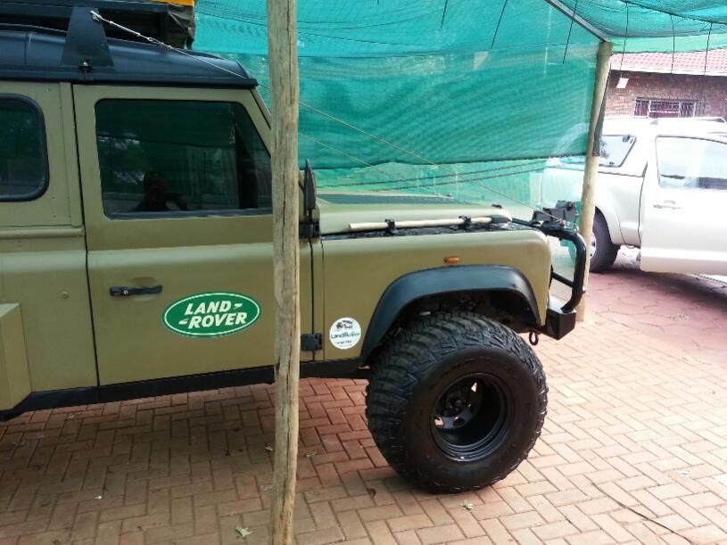

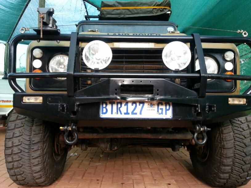

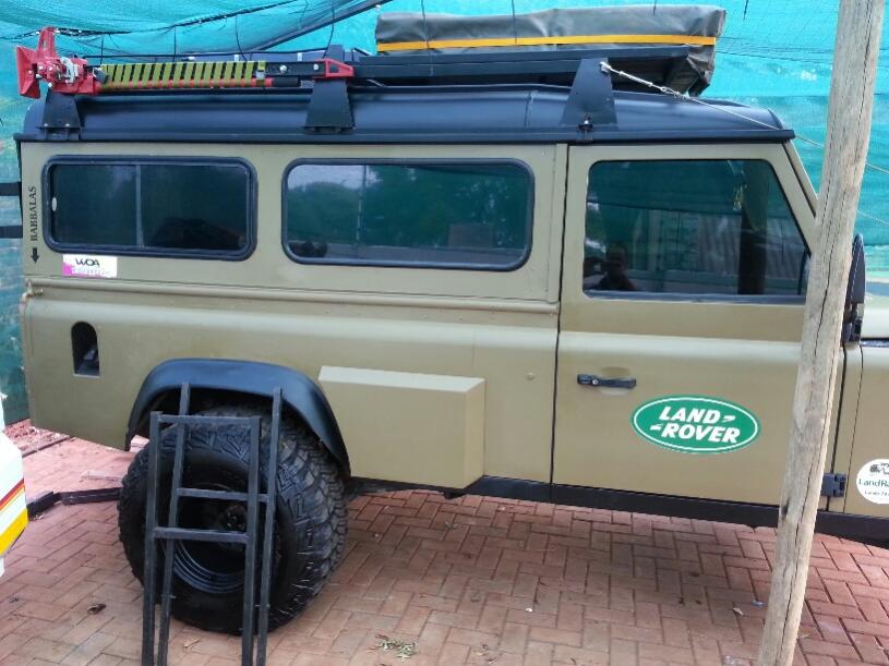

@ SB....I'm in SouthAfrica Gauteng...some pics attached
Attached Thumbnails Speedometer convertion kit-20131209_070215_resized.jpg   Speedometer convertion kit-20131209_070433_resized.jpg   Speedometer convertion kit-20131209_070436_resized.jpg
