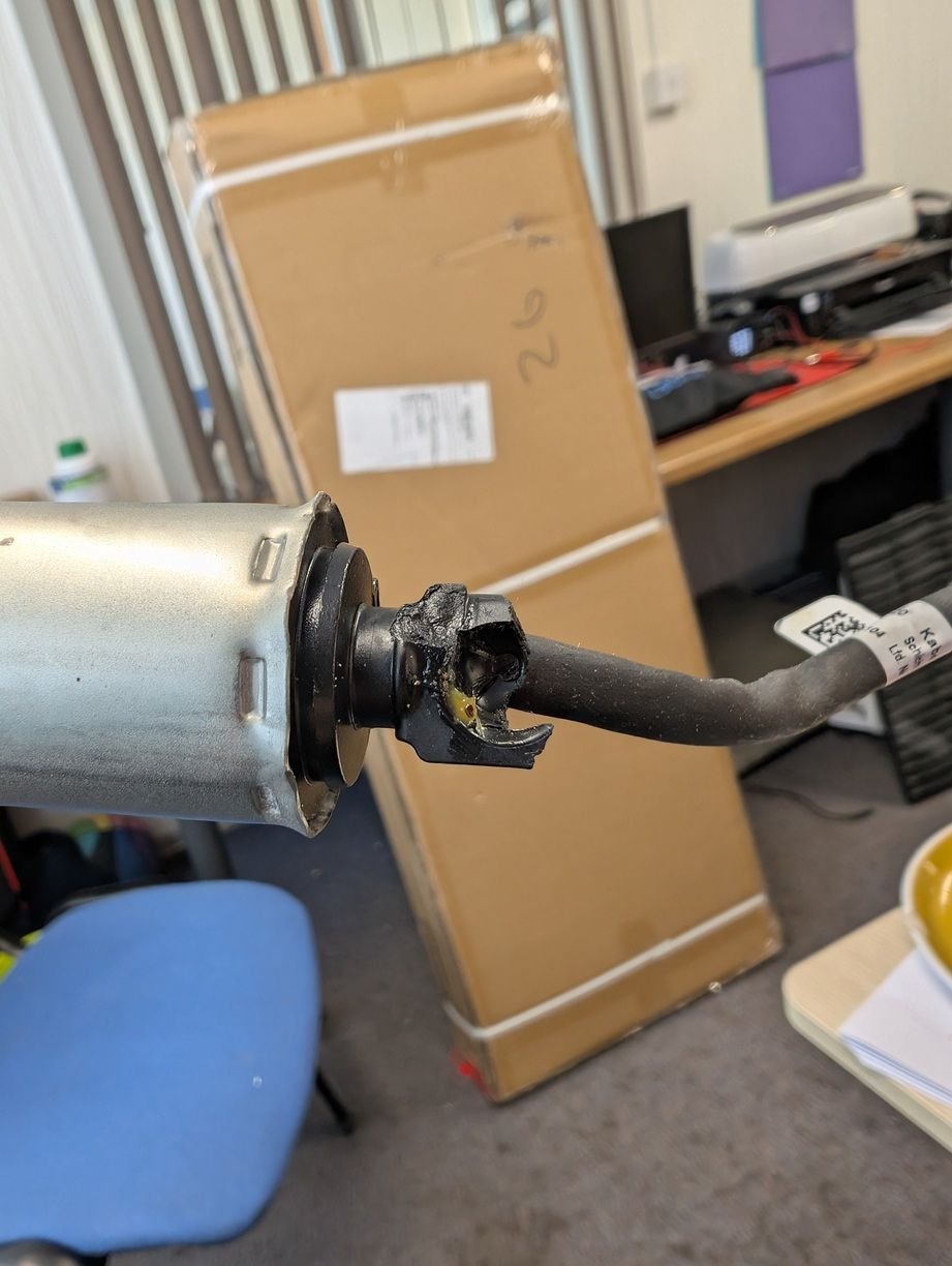

I stripped down the boot to look for the modules, and noticed the electric ram that operates the internal boot flap was broken! The ball socket connection on the ram was snapped and the ram itself was seized in the open position.
After a quick look on ebay for replacements, I managed to find one local and collected it this morning rather than waiting for delivery.
Plugged the new ram in and now the boot opens perfectly fine on the remote!

That makes sense. The lower tailgate flap only lowers when the fob is used. I'm sure if you open the tailgate with the exterior/interior button and then pushed the button to drop the flap the truck would probably complain as well.
I wonder if this is the result of overloading the cargo area and obstructing the flap as it retracts.

Yeah I was thinking of how it could of broken the ball socket. I did think maybe the ram seized once it reached the open position, then the previous owner just forced it shut and snapped the ball socket? Or as you mentioned, overloaded it then tried to shut it.
