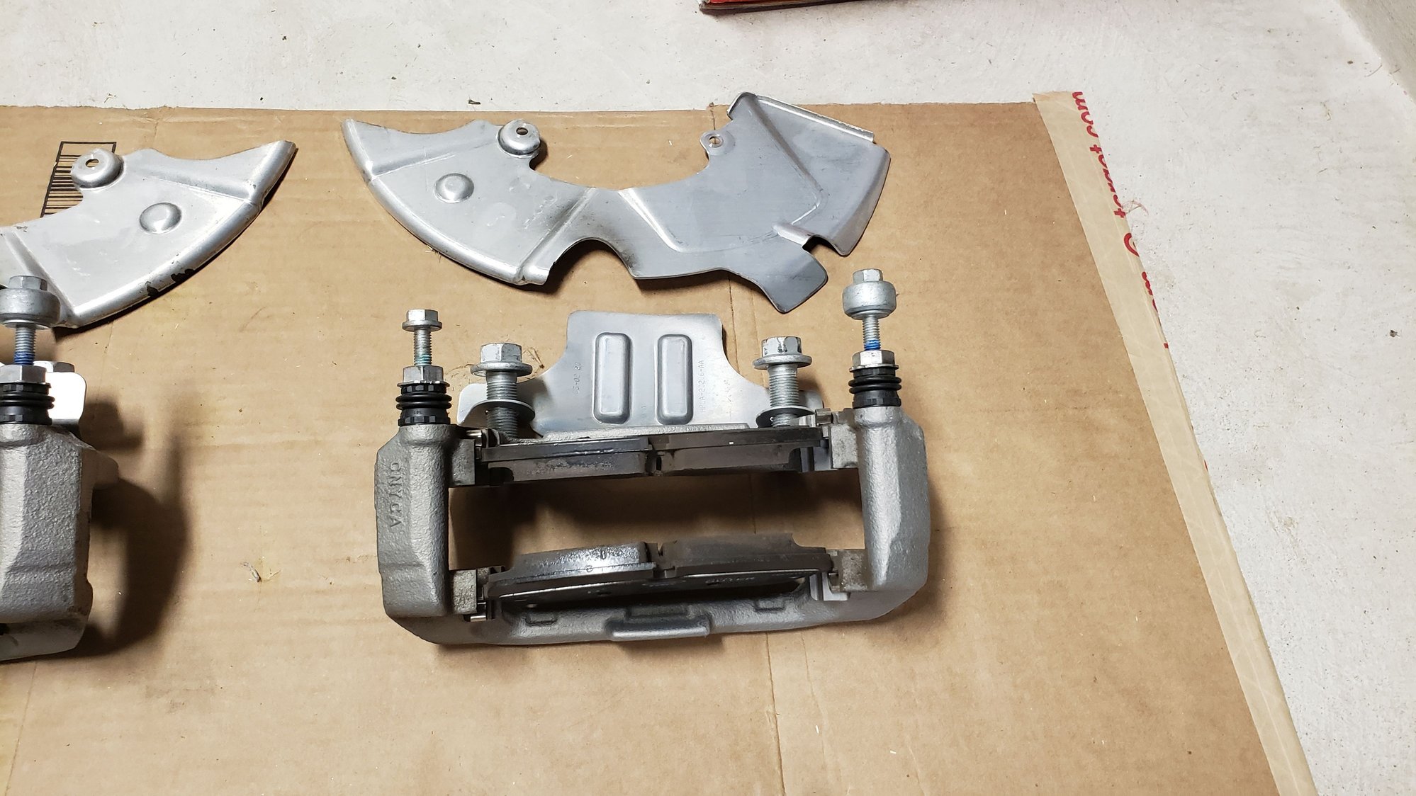

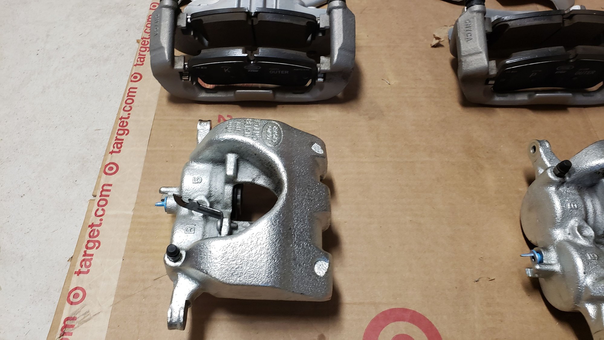

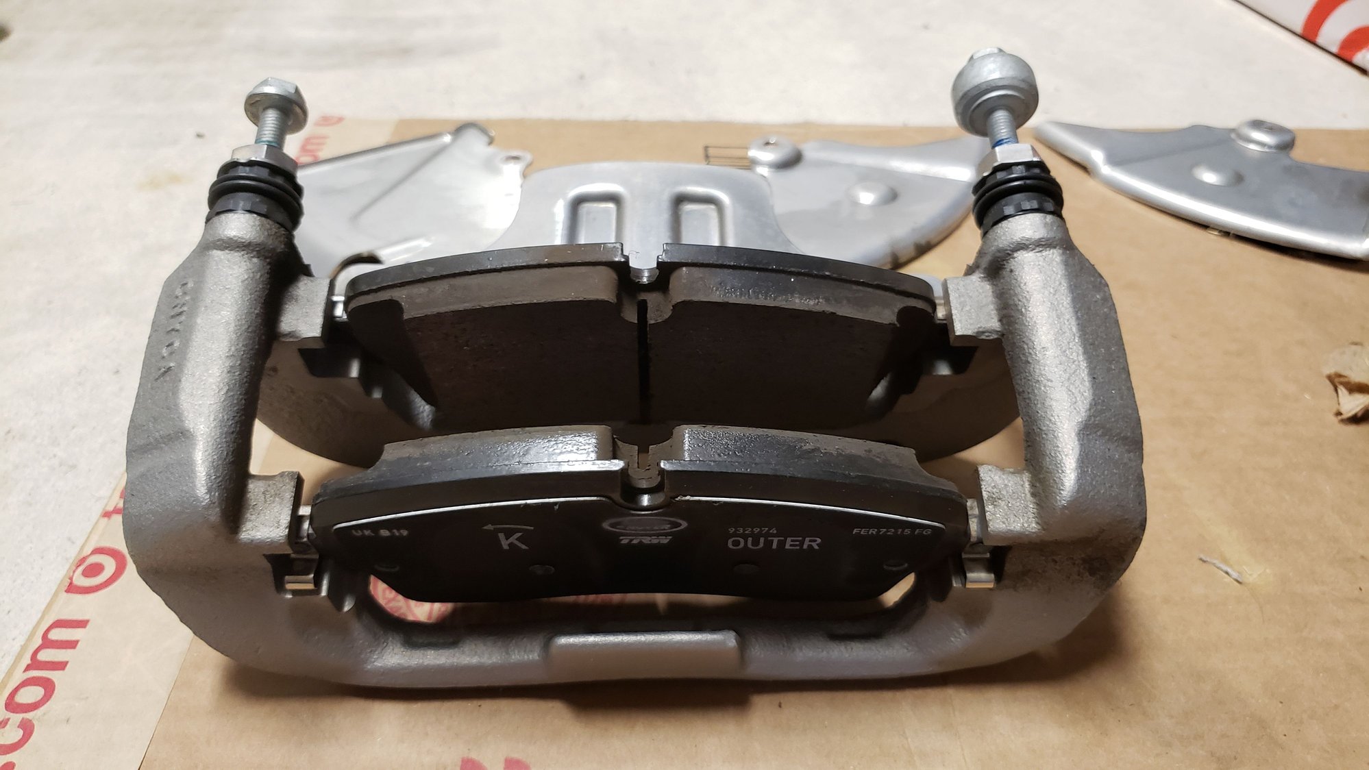

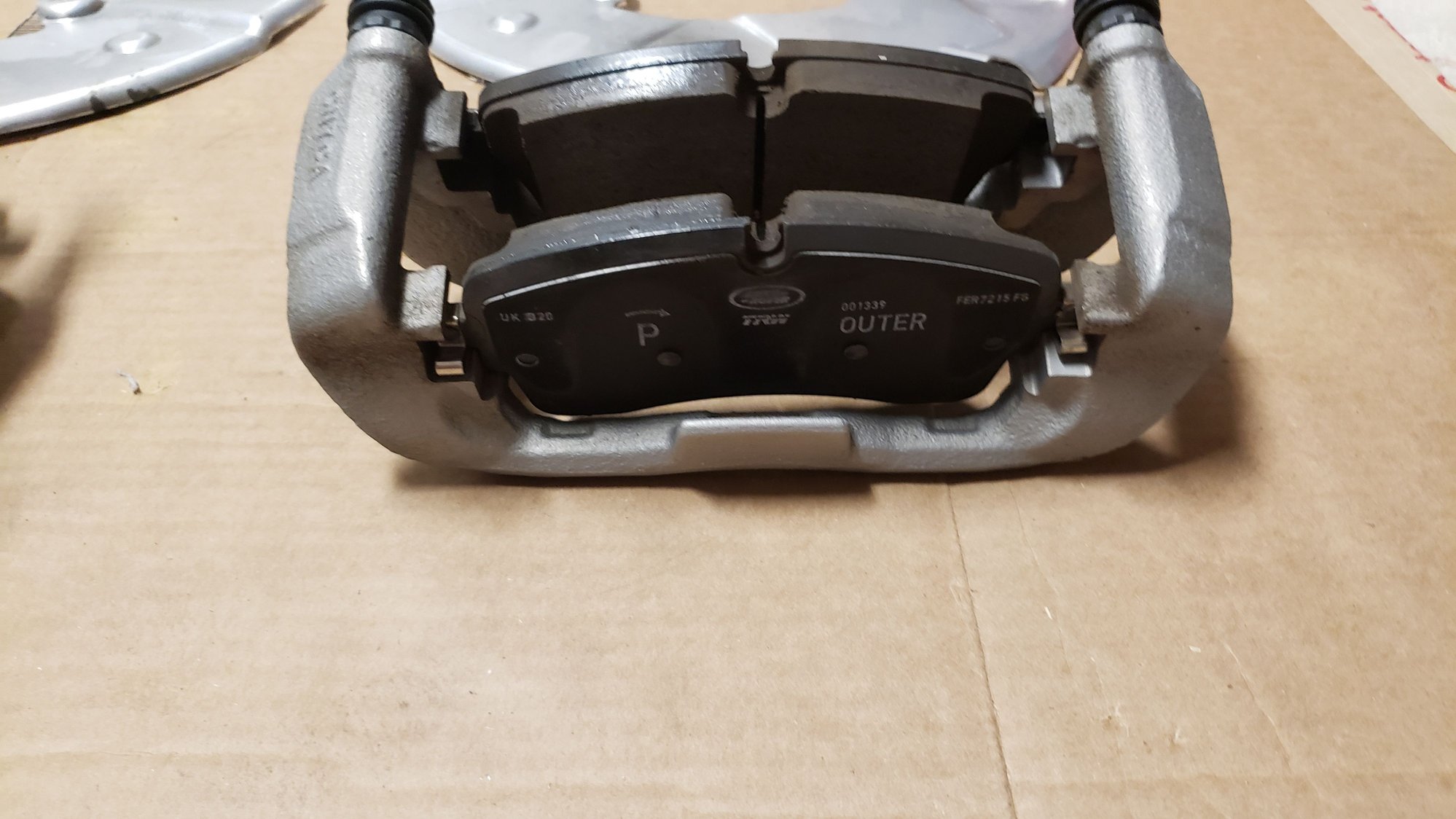

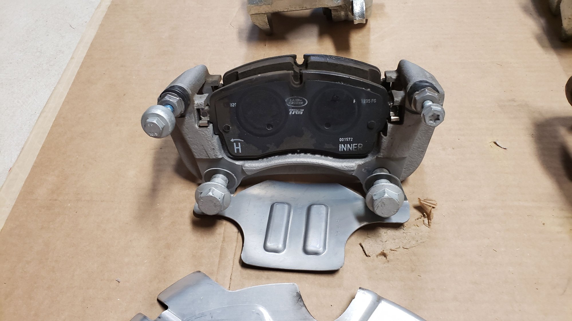

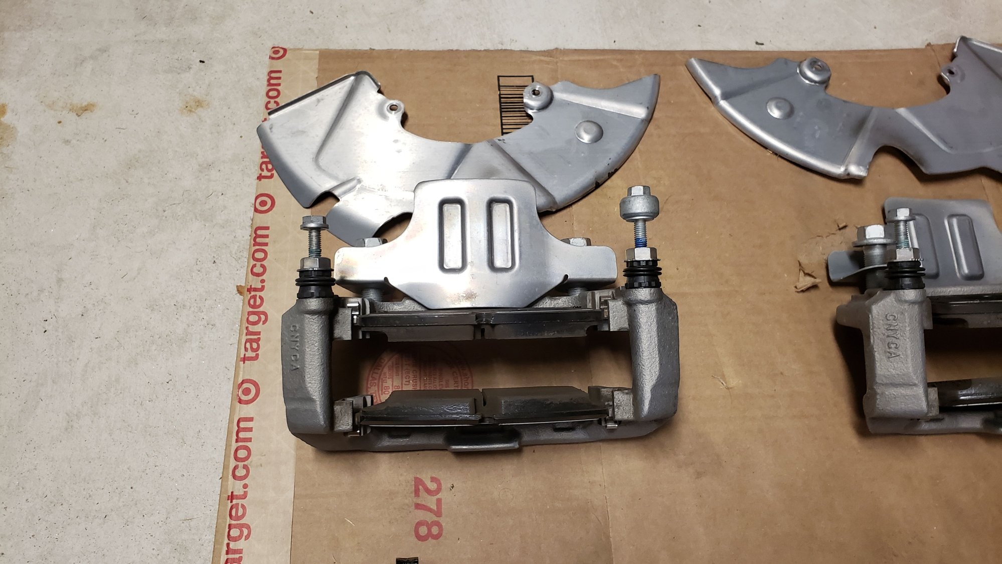

Yup, they just go straight back. Here are the calipers and pads from my 2020 Td6 that I removed at around 775 miles. TRW two-piston, floating caliper.

I thought I'd replied but I don't see it. Thanks very much for the pictures and answer.
