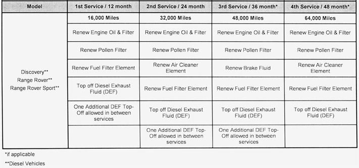

Another question for all: this service was at 7K. After resetting the service interval, it says next service is at 15K. What’s the deal. 7K for first and 15K after? I’m thinking 10K...

Does anybody have the part number for the Fuel Filter Element? "Refreshing" the Fuel Filter Element is part of the first pre-paid service ...the rest is basically just oil and filter change. I have the filters, oil, and even DEF to top that off, but haven't found info on replacing/refreshing the Fuel Filter Element or what that entails.
