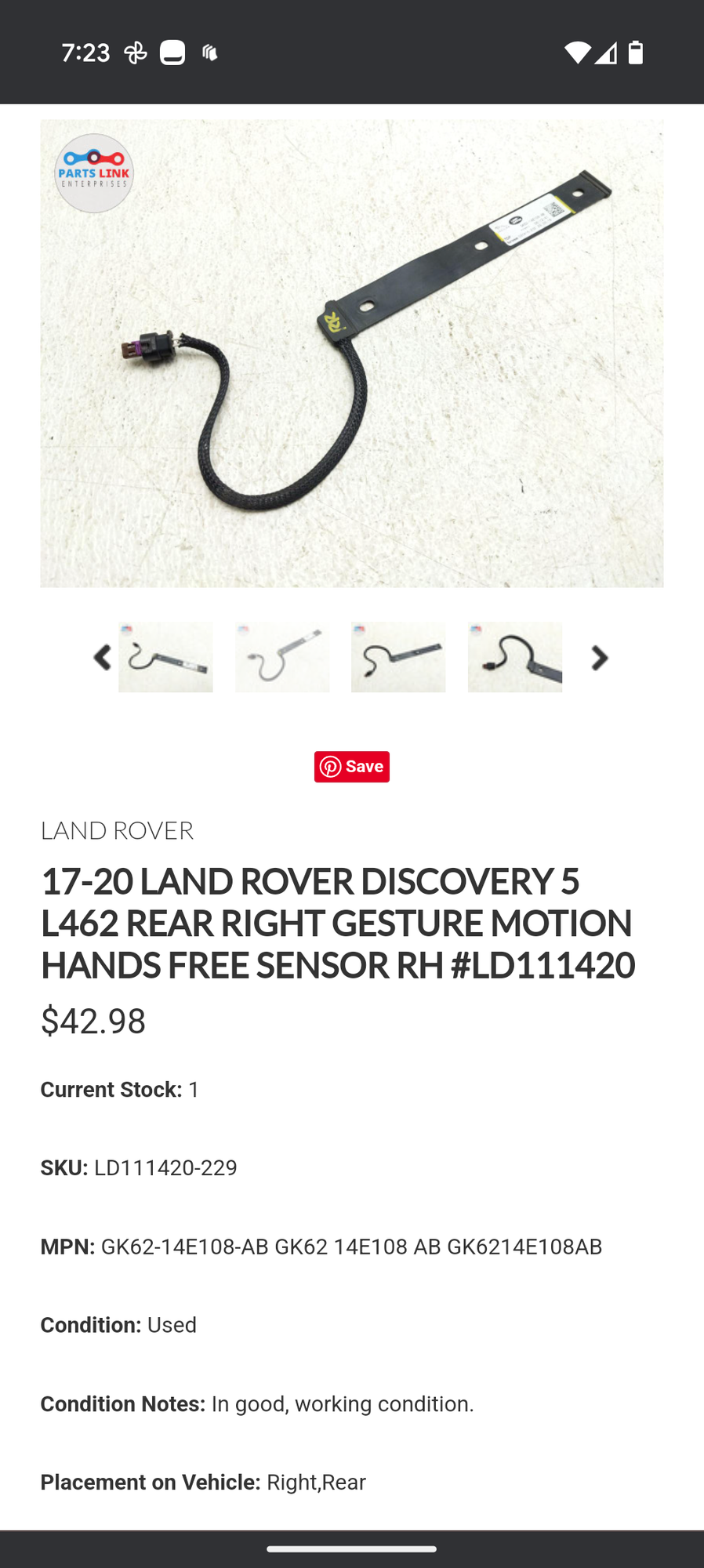

Can you unplug the sensor?

That sounds like it's worth a try. Maybe just one side and see if my issue (unwanted closing upon my head) goes away.
I've looked underneath and never found the sensor but now that you've included that picture I will look again.
If it does fix the issue maybe I will swap my left and right sensors and see what that result is.
