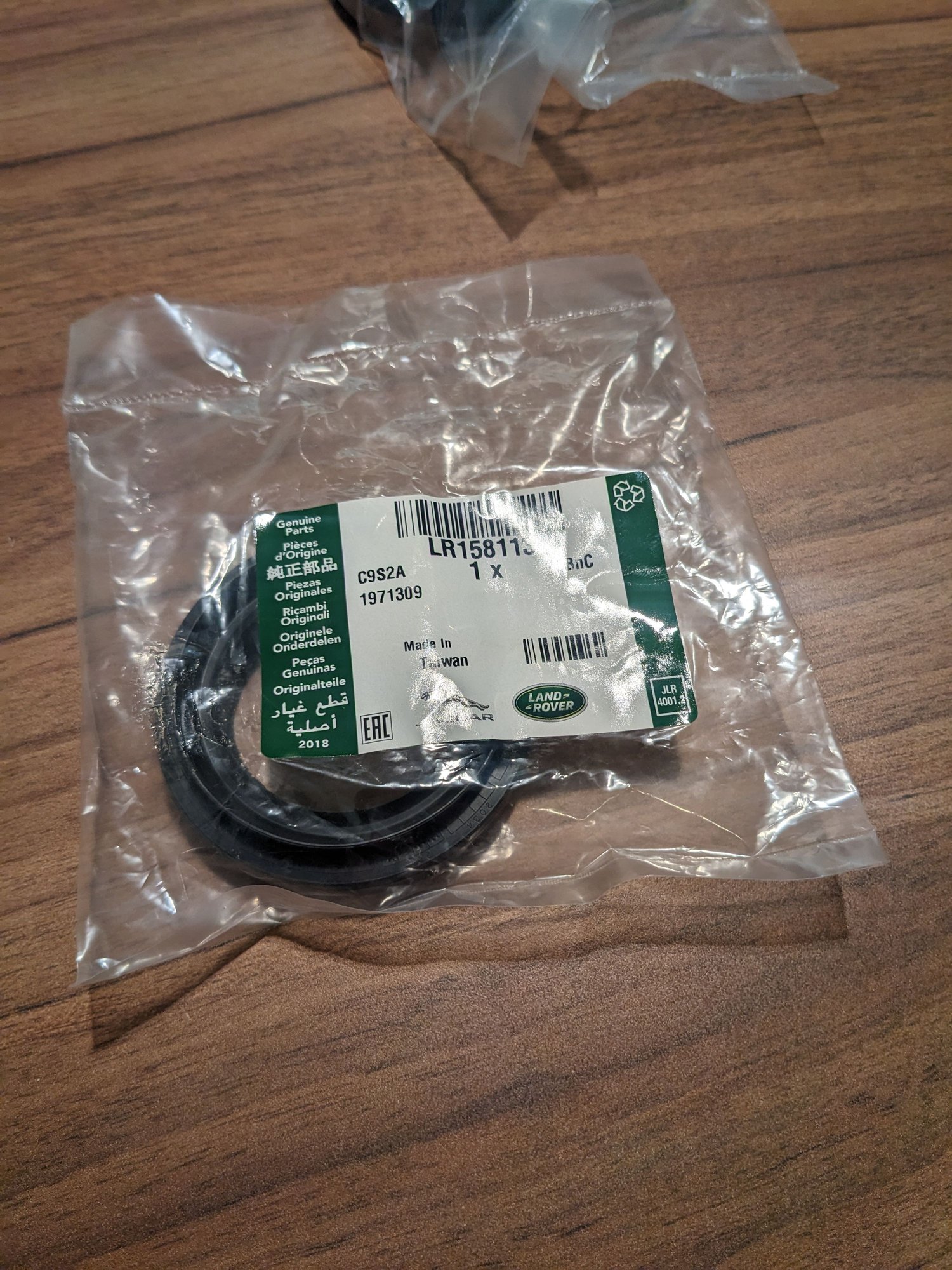

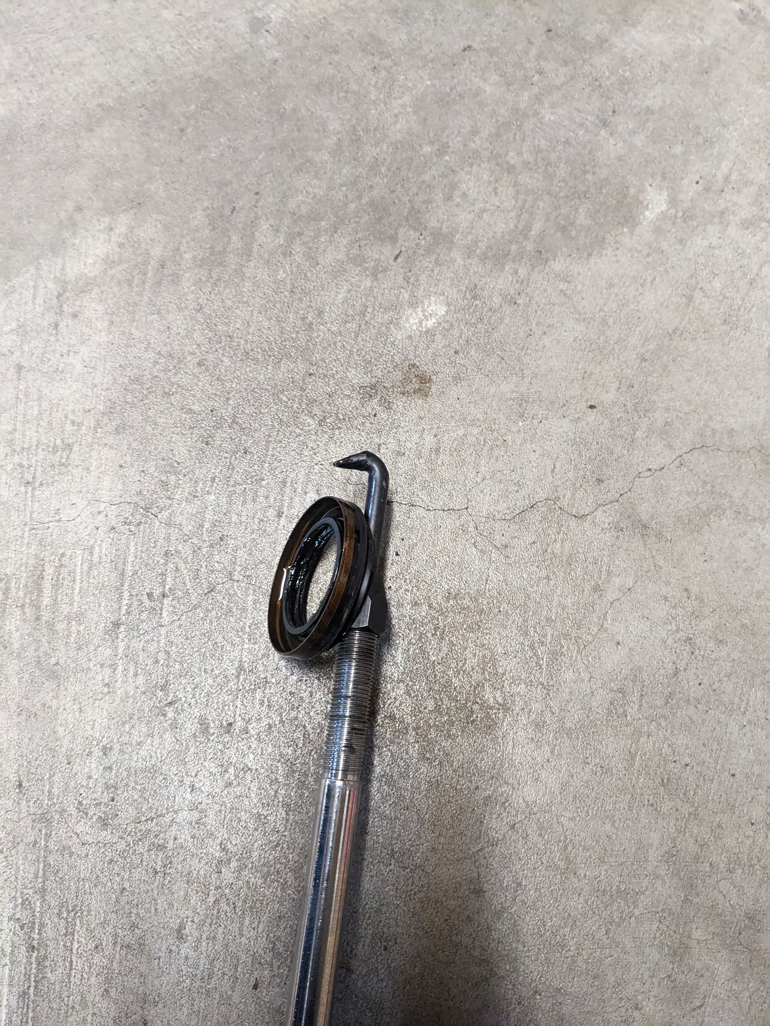

I did the passenger about a year ago because I tore the boot doing the control arms. I wouldn't do both axles because of a boot and failure on one side. I'd prefer to have the factory units where possible. Process would be the same as L405: range Rover linked below.
I also replaced the differential housing seal while I was at it. Just to keep new axle to new seal.
The guy in the link above was lucky that his axles slid out. Mine wouldn't budge no matter how hard I beat on it. I had to buy a puller from NAPA.

Thanks @RyanLR3 for that video and the pictures! I really like that idea of only pulling the lower control arm bolts and tie rod end to gain access. Good call on the seal, I completely spaced that off.
