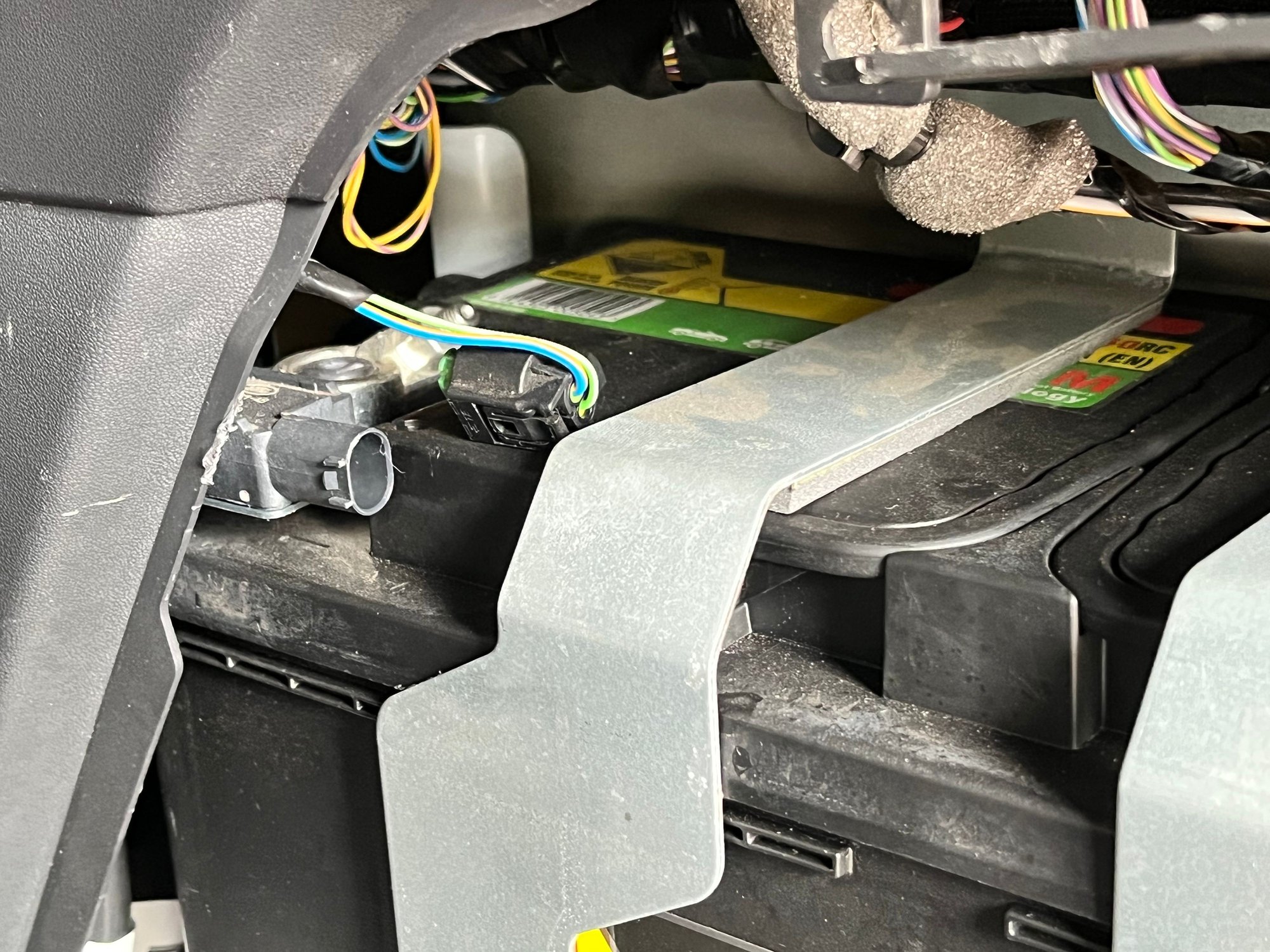

Old May 21, 2022 | 08:10 PM
Fpv330's Avatar
Joined: May 2022
2017 HSE td6. I can post a pic later. It is the same connection that I have on VW petrol from 2020 which of course does the same thing to disable the s/s. It does not affect anything else. It is the only connection on the neg side of the battery, easy to locate.
The plug here that is on your neg terminal
Old May 21, 2022 | 08:50 PM
ponderosajack's Avatar
Joined: Oct 2018
Posts: 945
Likes: 311
From: Colorado
Mine's a 2017 HSE Si6 so I will have to see if it's the same.
I have had my auto stop disabled for a couple years with by disconnecting the voltage quality module connector as shown on this forum with no ill effects.
But if I have that connector that you have, I might reconnect my voltage quality module and try your method.
I've always felt there must be a reason they installed a voltage quality module and that without it I have lessor voltage quality somewhere.
Thanks. I'll wait for your picture.
