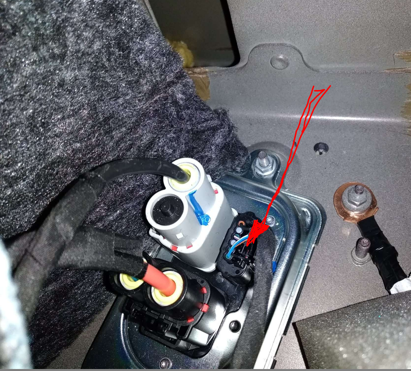

I think I found it and disabled it for good.
open the small compartment on the right side of the trunk , where the jack is stored and find the connectors on the bottom and disconnect the small back plug.
please test it and confirm here.

Chouk: Is that disconnect still keeping the auto stop start from kicking in? Have you found any side effects?
Has anyone else tried the above fix (removing that connector by the jack)? I haven't been driving my D5 so I haven't tried it yet. Was hoping a couple other readers would try it and report back.
works like charm, no side effects.
Same as confirmed for RR and Jags in the link above, apparently all have same plug.
On the display you see Crossed "A" in a circle when you stop on light and normally the engine would be killed. this is another indication that it is correct plug and it does affect what we need,
