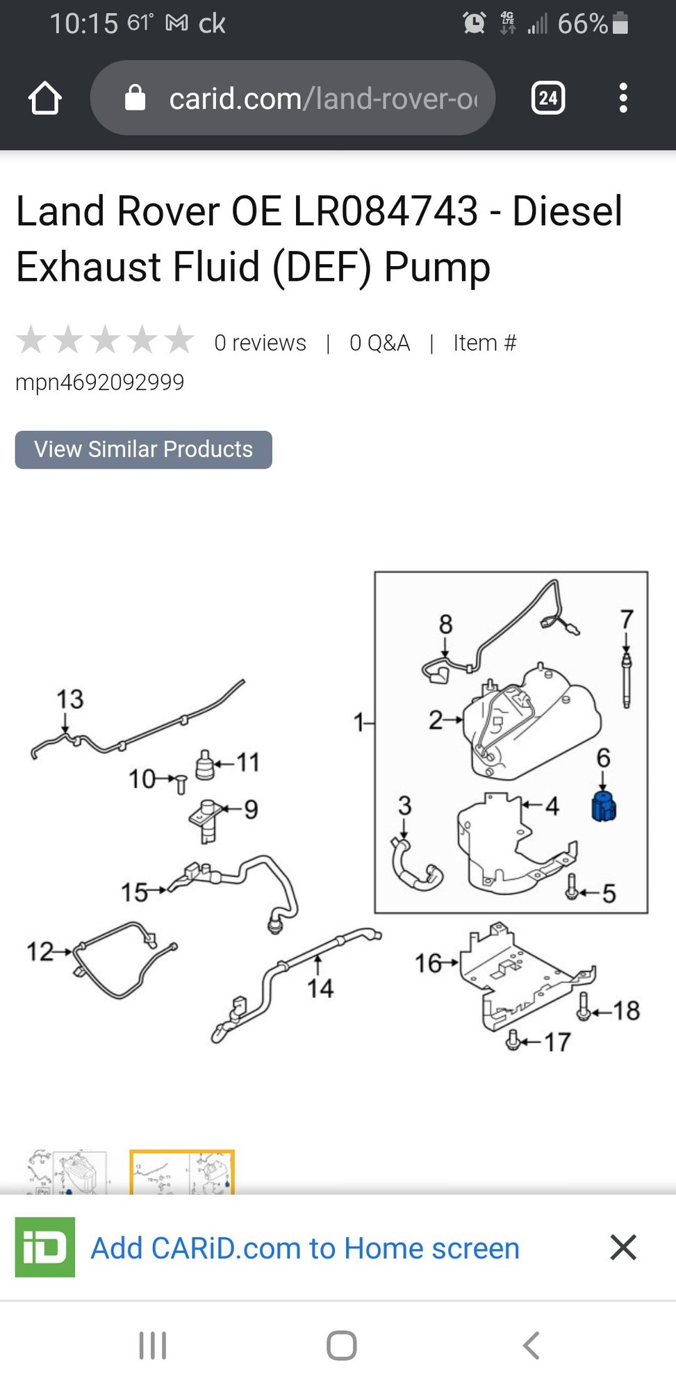

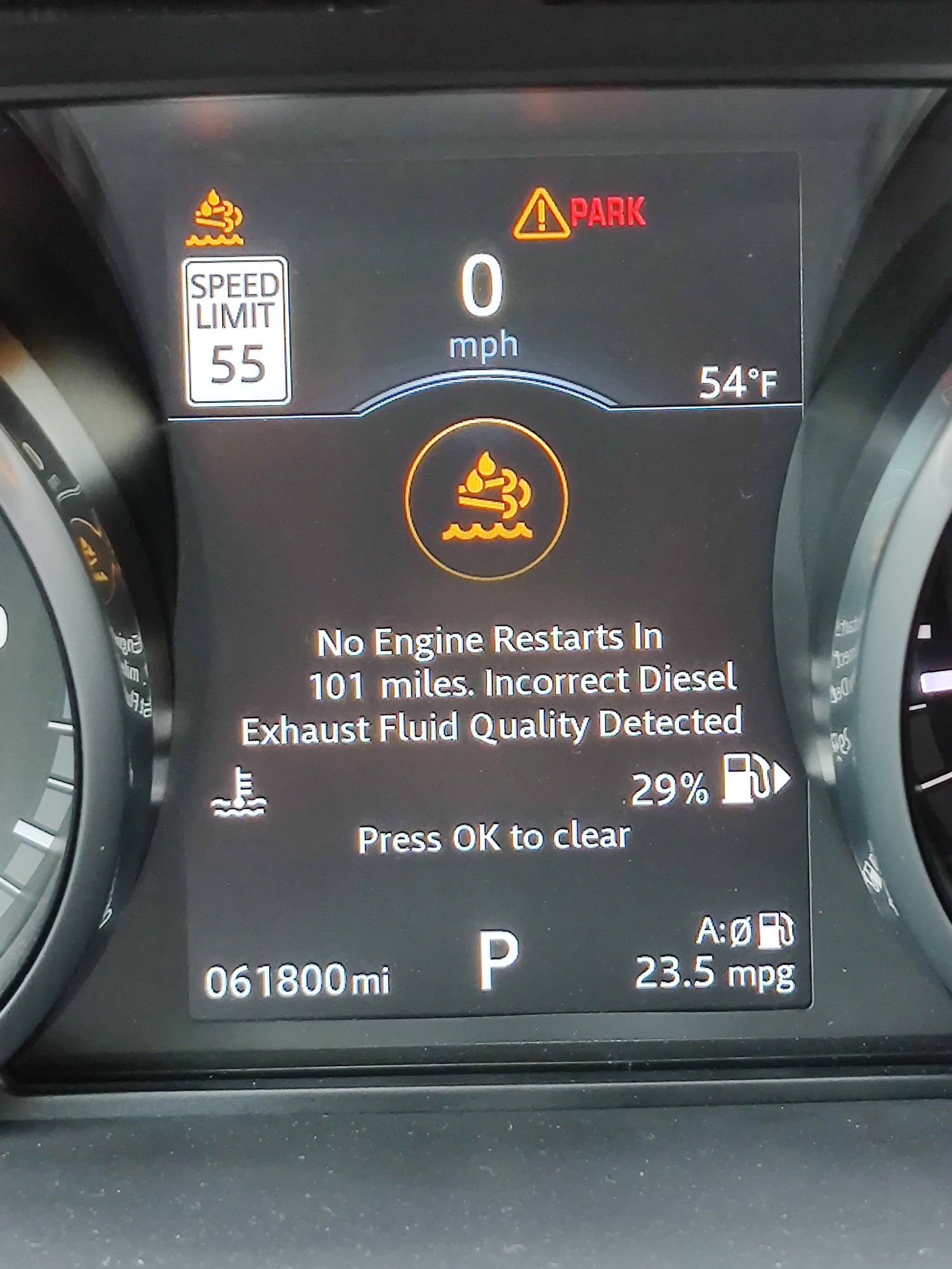

I had this come up:
incorrect diesel exhaust fluid quality detected no start
Took it to my mechanic....... Bad Def Fluid Pump (LR084743) Parts and labor $ 954
I thought I would share.

Originally Posted by geekinc
Maybe the extended warranty, but factory warranty is up at 50k, this Disco is at 61k miles.
What I'd like to know is how difficult the replacement would be at home?
Not difficult. Driver side, remove debris shield, pump is is at DEF tank. easy.
