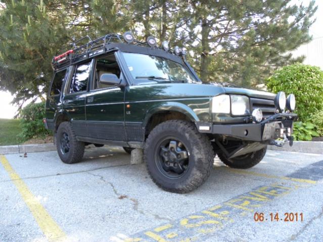

this is what I started with.
A 98 Disco 1, 4.0 GEMS V8 auto.
the typical full power option NAS Disco.

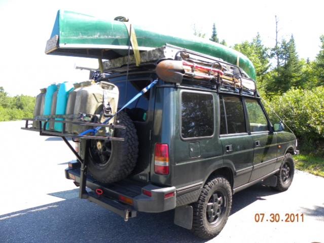

This is why I decided to do the diesel swap.
Last year, we did a trip to northern Quebec, into James Bay, and onto the Trans-Taiga Trail.
I had to carry 5 jerry cans of extra fuel. That's an extra 100 liters.
We were paying as much as $1.81 / L , up there.
So to fill the truck $181... and another $181 to fill the cans.
I still couldn't get more than 850km with all that fuel.
I don't even want to think about that the total fuel cost for the trip was!
