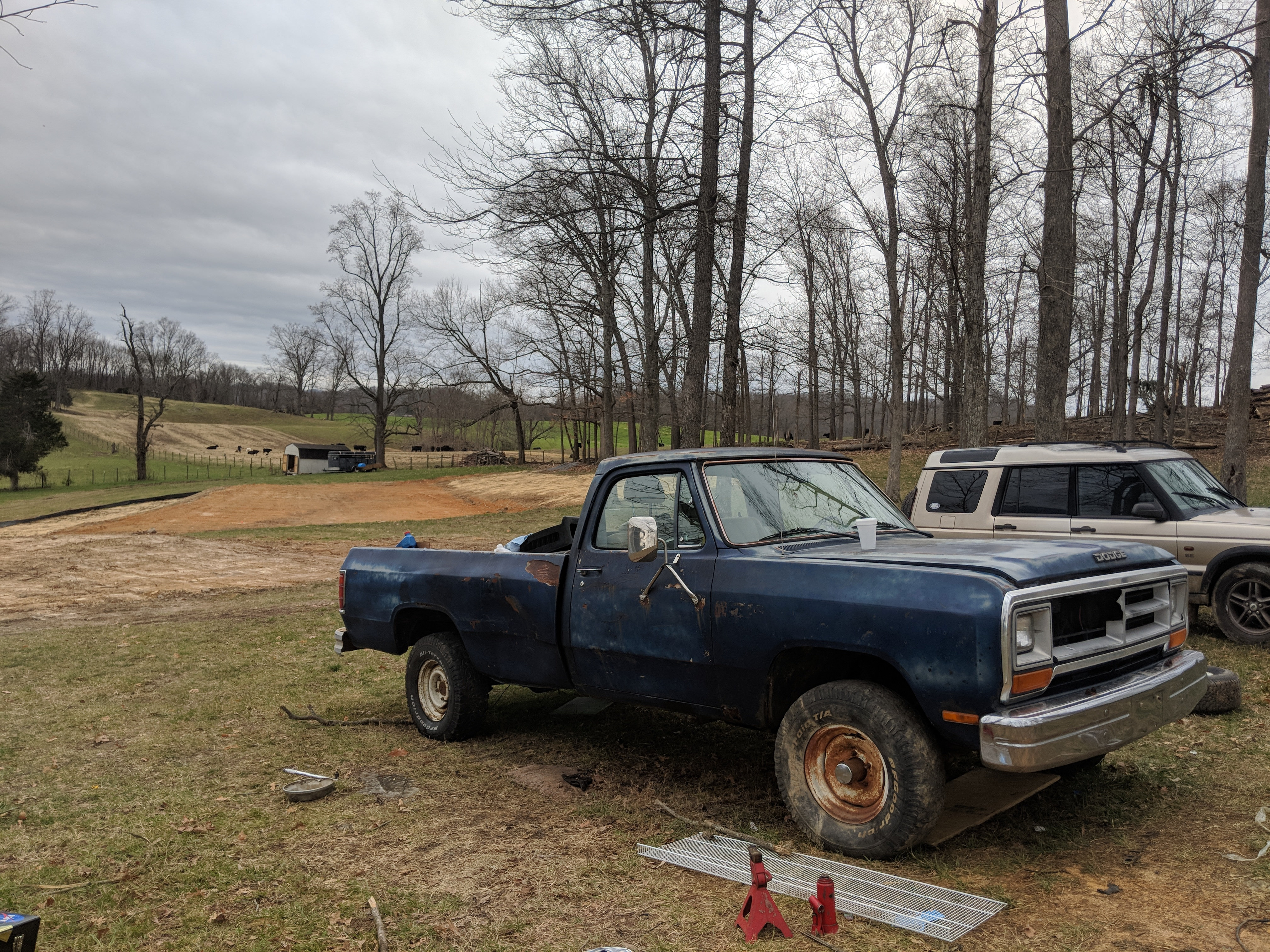

Alex, I love that truck, it's oozes 'character', if you ever want to get rid of it I'll take it off of you for the right price, all you have to do is ship here. It's pure magic IMHO.
Just imagine driving it down to Super U and frightening all the French, they'd run a mile lol.
Haha, thanks France! Trucks like this are pretty common around here, but i:'ve got to admit that there's something a little different about this one. Part of me wants to fix the rust holes and paint it. Another part says leave it exactly how it is. For now I think I'm just gonna power wash and scotch Brite it to take some mold and stuff off. Probably a set of Cragar v-5 rims and some 33" tires once I really get it on the road.

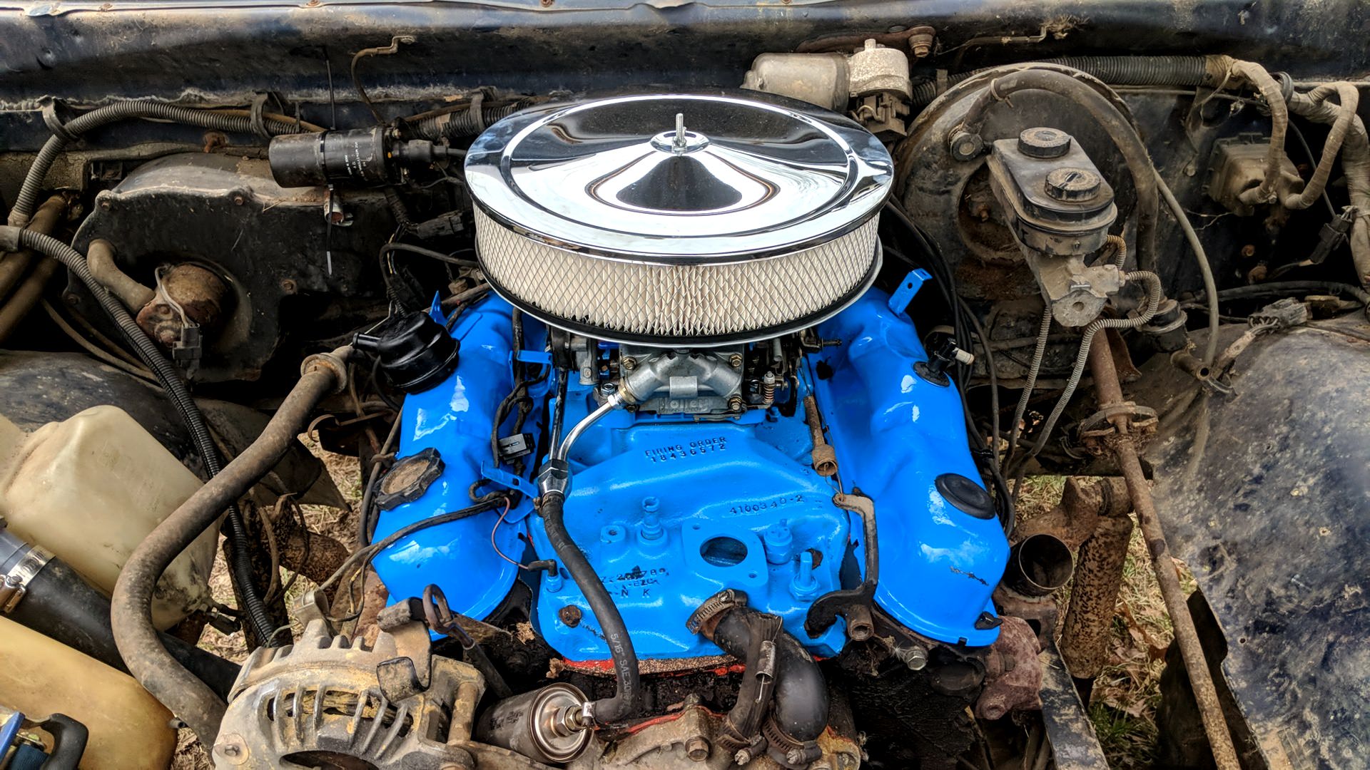

I did finally get the 4 Barrell intake and Holley 650 installed.
Started it for just a minute. Then I installed an HEI ignition system and the starter motor died before I could even test it. Tried beating it, rotating the armature, everything. Starter is totally dead. Bah!
That said, it idled fine with the Holley. A little high, some tuning to do. Backfired through the exhaust and occasionally through the carb around 3k rpm which I felt was an ignition issue, hence the HEI. We'll see once I get a starter.

Alex, it looks a nice job. No, no, don't paint it up, it looks excellent as it is. By all means fix any rusty bits and fix any frame rust but it has real 'character', I really think it looks great as it is.
Replaced the starter with a more modern gear reduction unit and bypassed the neutral safety switch because both died at the same time. No, it wasn't just the NSS, I tried just bridging the contacts to bypass it on the old starter.
She cranked right up! Quicker than my DD Disco does. Idles a little high, but the HEI seems to be working well. Still have some tuning to do on the carb, I think to the accelerator pump and maybe change the jets. Otherwise she ran fine for about 5 minutes till the battery died. Alternator is dead. That's fine, I'll probably just rebuild it.
