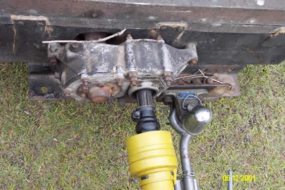

OK i am really going to display my ignorance here - I have a Series 2a and was wondering what are the holes in rear bumper and the main crossmembers for, the big 3-4" holes???

Perhaps for an optional PTO shaft - see attached from options brochure. Not a lot of HP for a bush hog or finishing mower, but a Rover would impress the neighbors while cutting the pasture.
Now what to do with those holes? Slip in a pipe and use it to hold fishing rods, pry bars, pipe for the still, survey gear, tent poles, etc?

Bingo - I believe you hit it right on the head! THanks

Yes, the holes are for PTO shafts.
