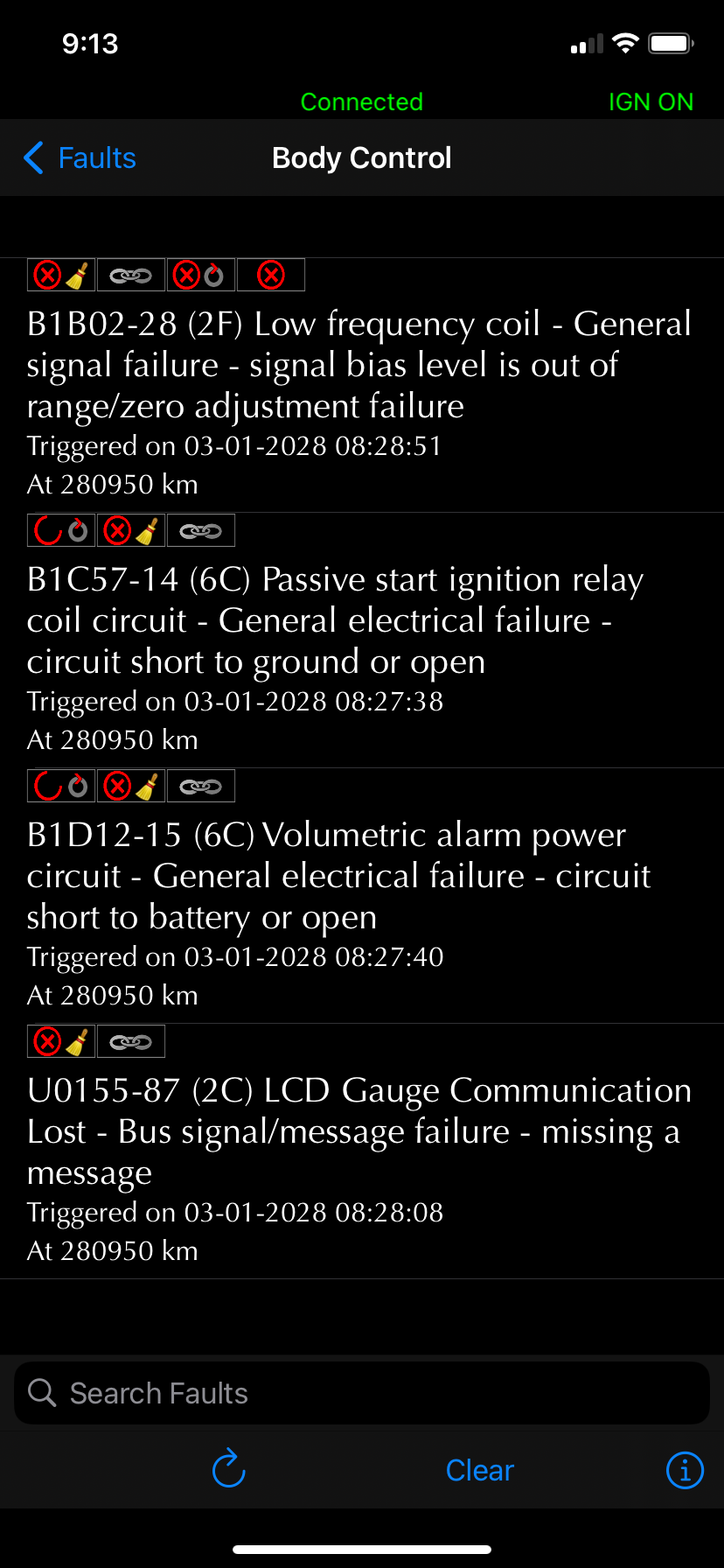

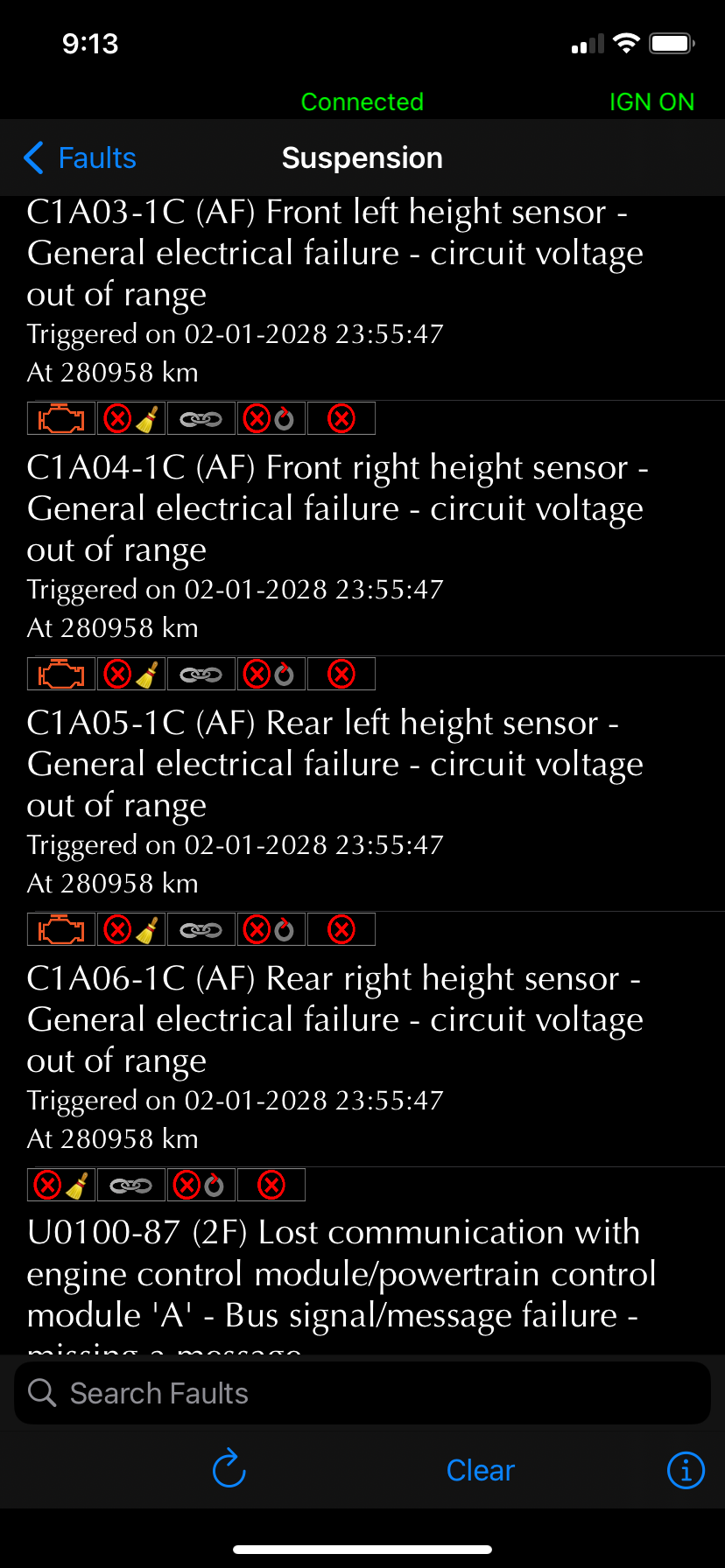

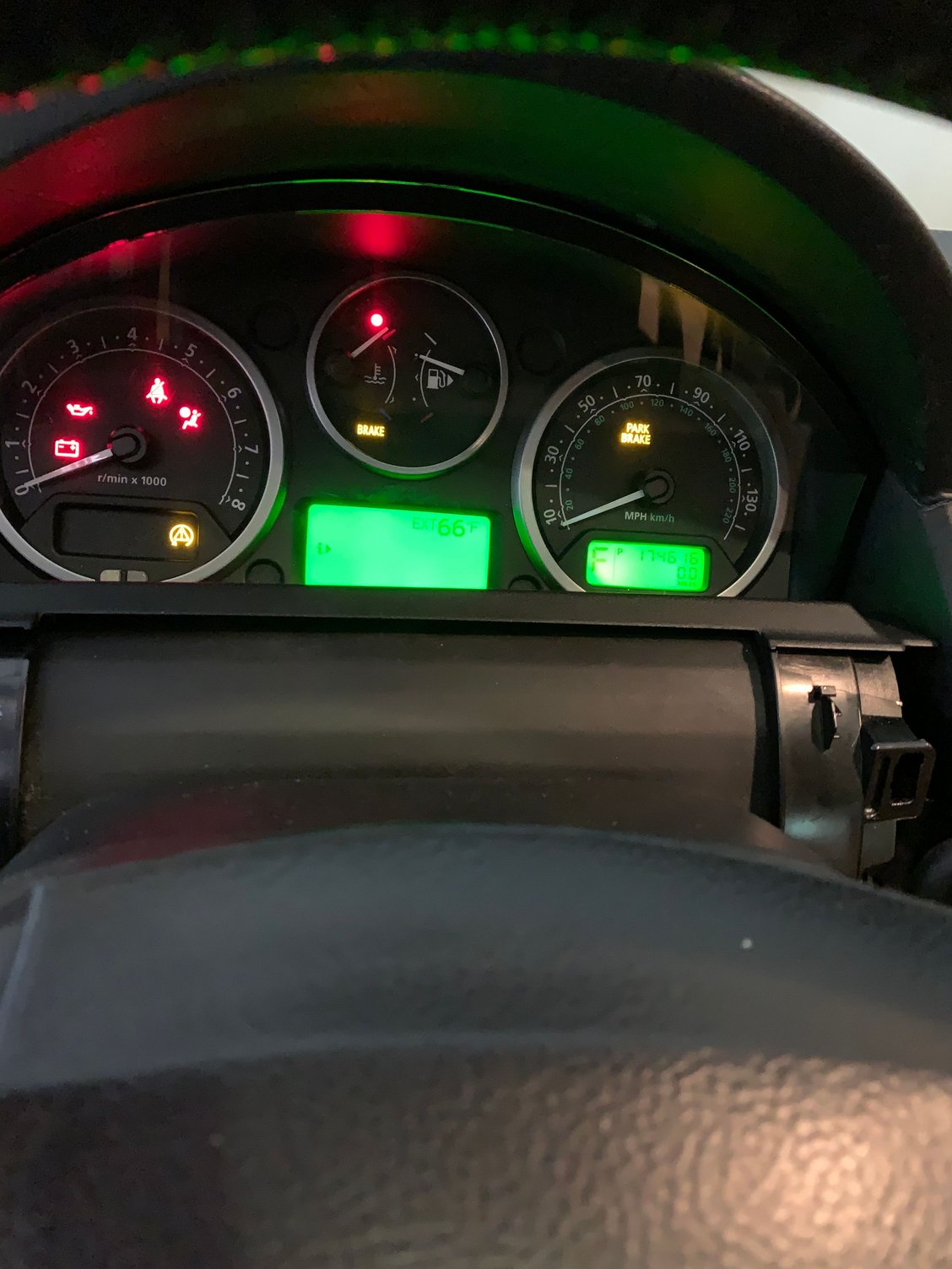

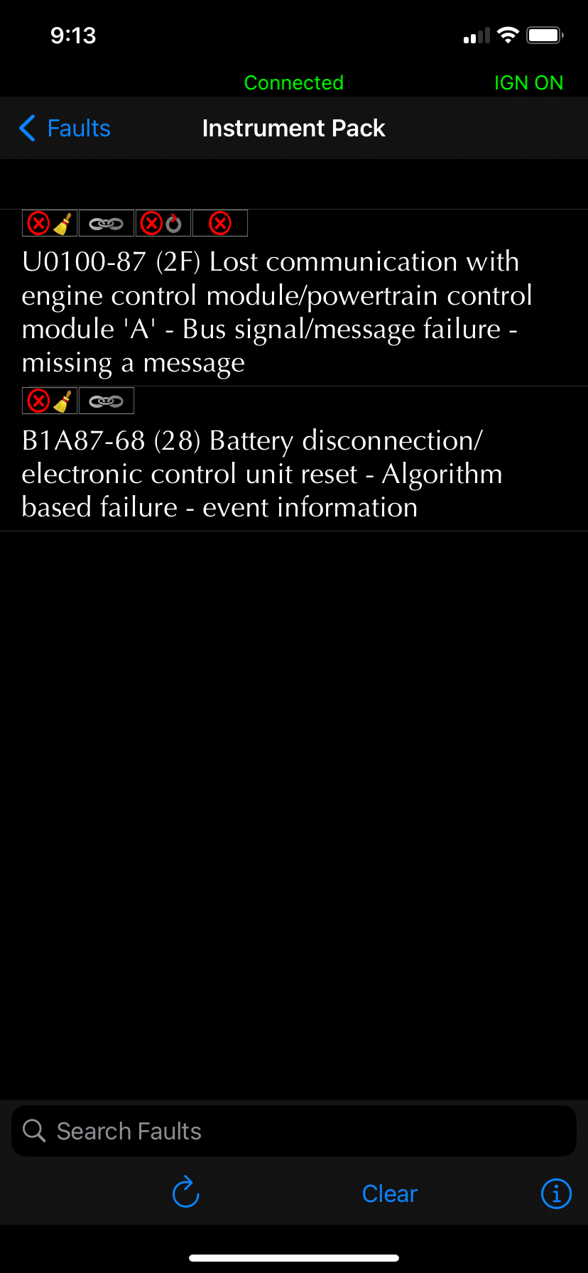

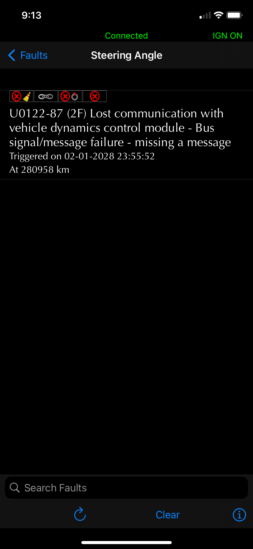

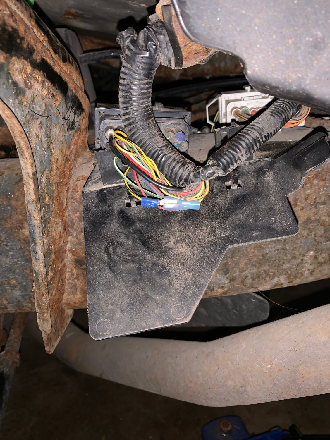

Ok. I’ve got an update. I finally got my LR3 back home in my garage which is so nice. Much easier to work on. I was in the process of taking the back left tire off to check the connection you had mentioned and as soon as I got the tire off and opened the compartment that connection is in, I noticed a broken wire at that connection. I have attached a picture of my temporary fix( will fix better later). I repaired and put a battery in it and most of my problems went away. No more flashers, no more locks locking and unlocking. Still won’t crank, and I have not only a few errors that pop up. Suspension fault( I’m converted to coil springs), transmission fault and park brake fault, and now instead of an “E” on the transmission selector I have an “F”. I pulled the new battery and checked across pins 6&14 again and still got a 41.1. Hooked the GAP to up and got the following in the pictures below. Much less than before. I am able to clear all of them except for the 4 corner suspension sensors( coils springs), but when I turn off the car and back on they come back. Used the GAP tool and did a reset and still a no go. I feel we are getting closer.
Also the temp gauge is maxed out which can be seen in the pic, and I did not see any corrosion on the connector with the bad wire I spliced.

Can you check and see what modules are offline? You still have a CAN issue if you have 41.1, and that wire you repaired looks like the high speed CAN you are having issues with. I would take a really close look at that area and the connector area.

I will try and communicate with the other modules. I looked around at the male end of the connection and that looked pretty good other than my temporary splice. I can’t see the female wires very will but will try and get under it tomorrow and get a better look. Do you know what other wires on that connection that would be critical or causing my issues? I spliced a yellow/black wire.

The circuit you are having issues with is the high speed CAN and it runs pretty much all over the place, so yes it goes through the passenger side floor rail. The wire you repaired looks to me like it is one of the CAN wires, and that would explain why you got the readings of no change earlier. I don't like that you only don't have coms with the PCM. I would do this in this order, since you are at the connector in the back let's just check and make sure the CAN going to and through the parking brake module is ok so check C0376 male 7 to same connector male 5
C0376 male 6 to same connector male 4. If you get no readings then do the same pins on the female side just to be sure. If that is good then reconnect everything to normal, battery still out, and disconnect the PCM. Take the readings on 6 and 14 again see what you get.
