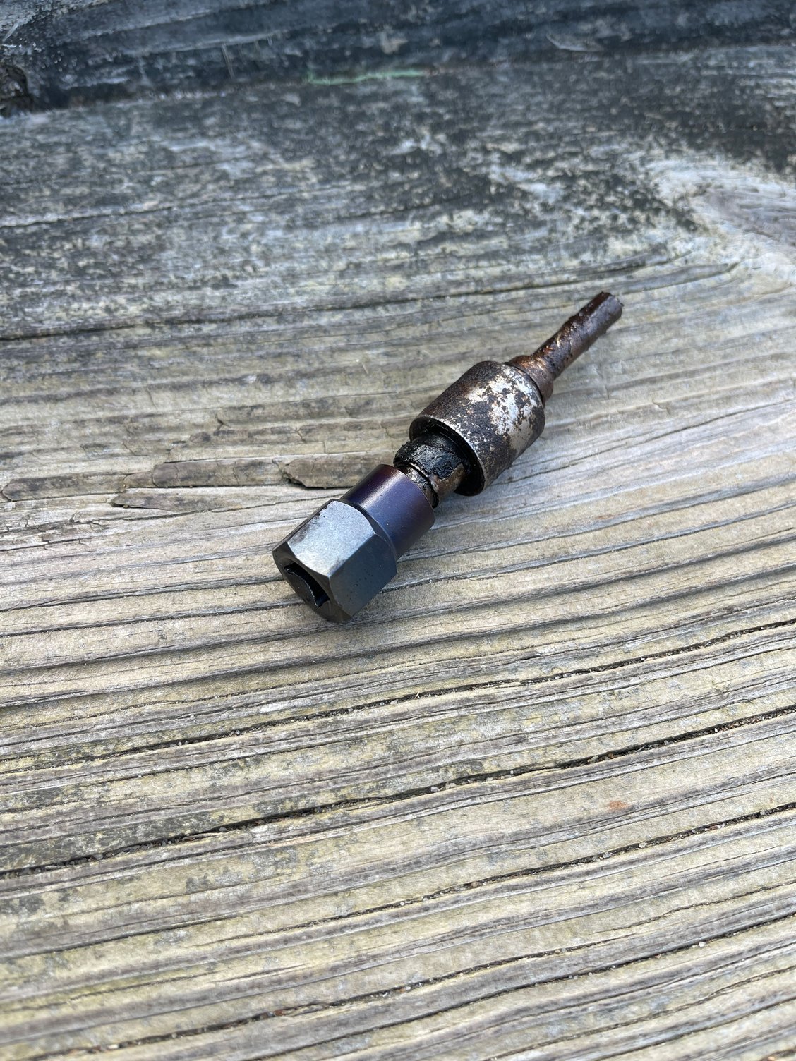

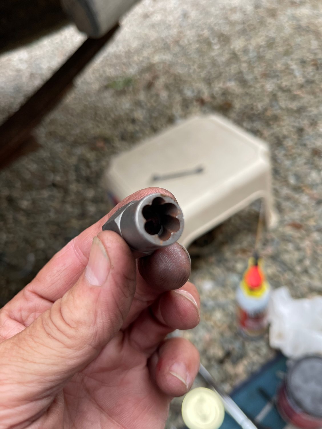

I wanted to pass on a trick I used to remove an absolutely frozen/stuck fuel injector while replacing valve cover gaskets on a 2011 Range Rover Sport with a 5.0 V8 (normally aspirated). I got 7 out of 8 injectors out with little trouble, but the number 6 injector was frozen. I had soaked it in PB blaster and many other penetrants for weeks and it did not budge. I ended up breaking it where the small tube meets the larger end of the injector. I was able to fit a 10mm nut extractor (female version of an extractor) on the piece remaining and rotate the injector. Once I did that, the pb blaster was able to soak in better and the injector came out!!
The advantage of this is that there is no need to drill a hole to accept a male extractor.
If the injector will not turn/twist, it will not come out. So in the future, I would try to turn a stuck injector. If it doesn't twist, then break off the injector and use this extractor tool to twist it. Once you get it to turn it WILL come out!!!
This is what was stuck in the head
This is the 10mm extractor I used
This shows the extractor on the remains of the fuel injector

@dwbursch I have the same issue, how did you get the extractor on the injector and what did you use to pull it out?
Old Mar 26, 2024 | 09:45 AM
dwbursch's Avatar
Joined: Dec 2023
You need to break off the injector where the small tube connects to the larger part of the injector. Once I got the extractor on, I was able to turn the injector counterclockwise; the teeth on the extractor are designed this way. This allowed the penetrant (pb blaster) to soak in more and it came out the next day.
