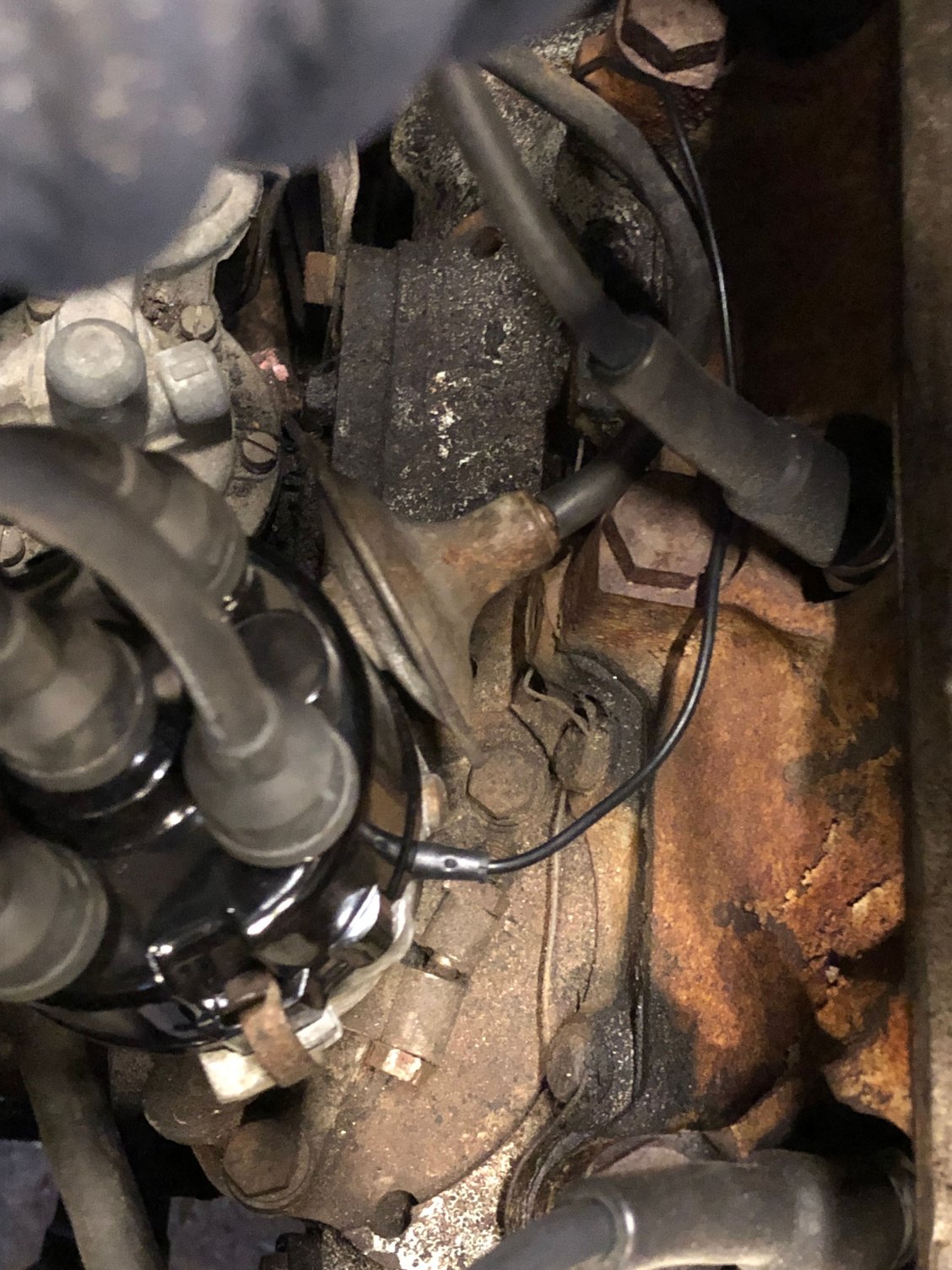

The ignition is set to approx. 3 ° BTDC and I can not set it earlier because the vacuum diaphragm on the distributor hits a screw head on the cylinder head. See photos.
Ignition is measured with ignition strobe light, 800RPM idle and without vacuum connected to the carburettor.

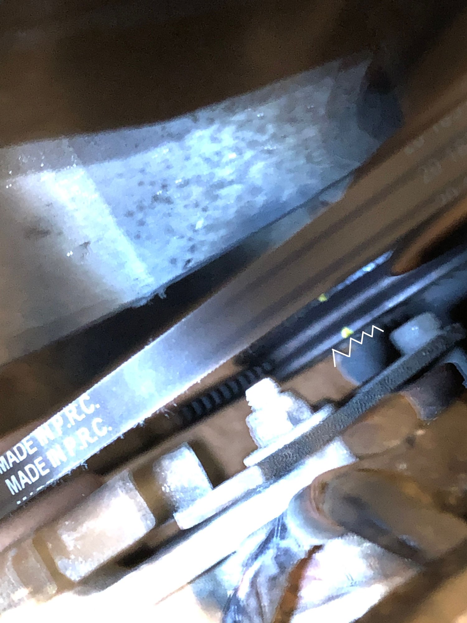

14.1 V voltage across the battery (wondered if the sound could be from the belt)

Pulley marking in front of 3°BTDC @800RPM and no vacuum.
Vacuum diaphragm hitting a bolt head.

The (very odd) noice was actually from the belt.
It was a brand new belt fitted and the tension was lost shortly after installation, I'm guessing that because the belt was folded in it's shipping packaging and had some sharp fold marks. Usually belt noice comes from old belts and are a lot more "screaming". I'm happy that it wasn't something more serious.
And the distributor could be turned 90° counter clockwise and the cable could move one step clockwise in order to correctly set the timing to 6°BTDC as stated in the Haynes manual.
