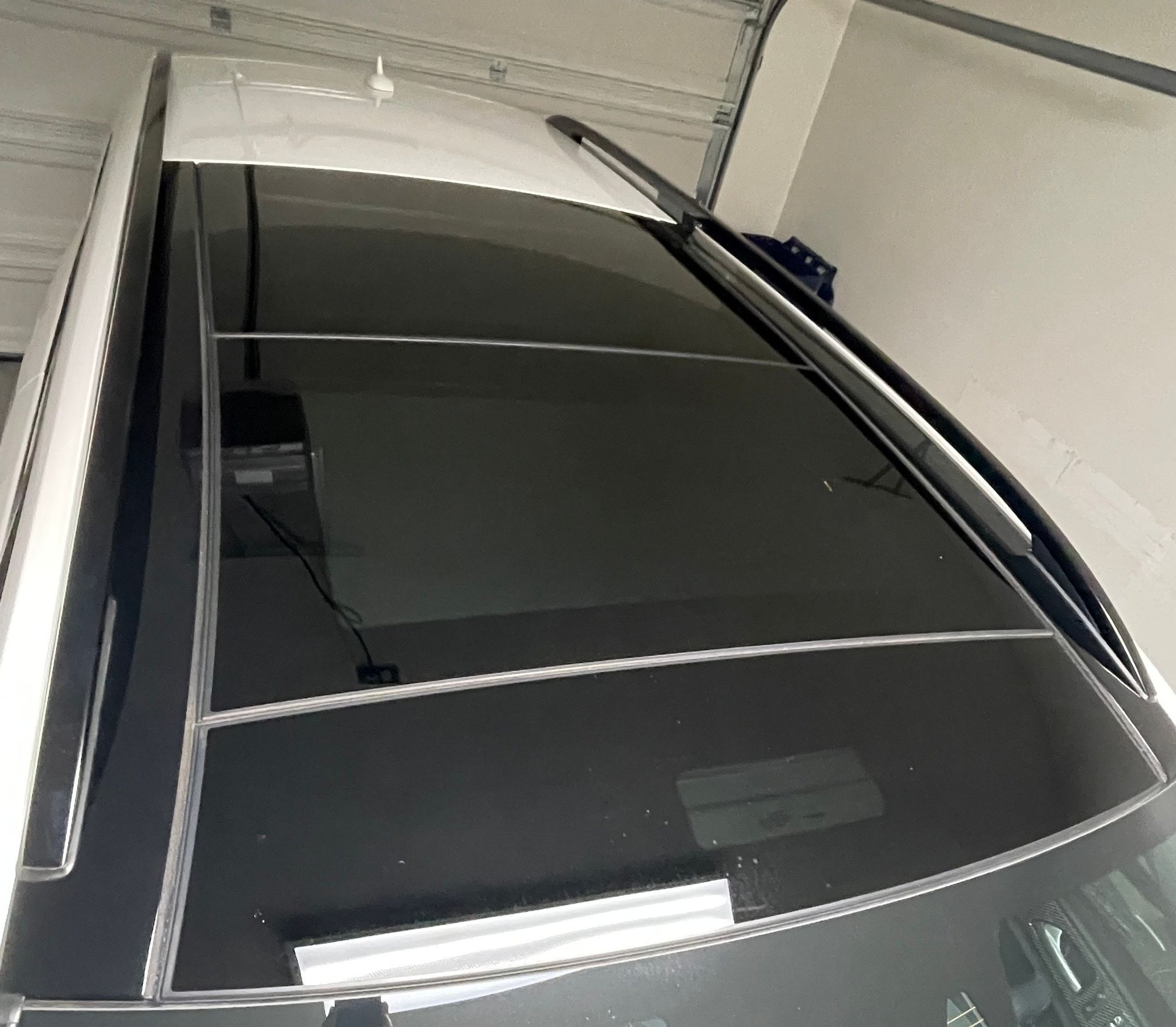

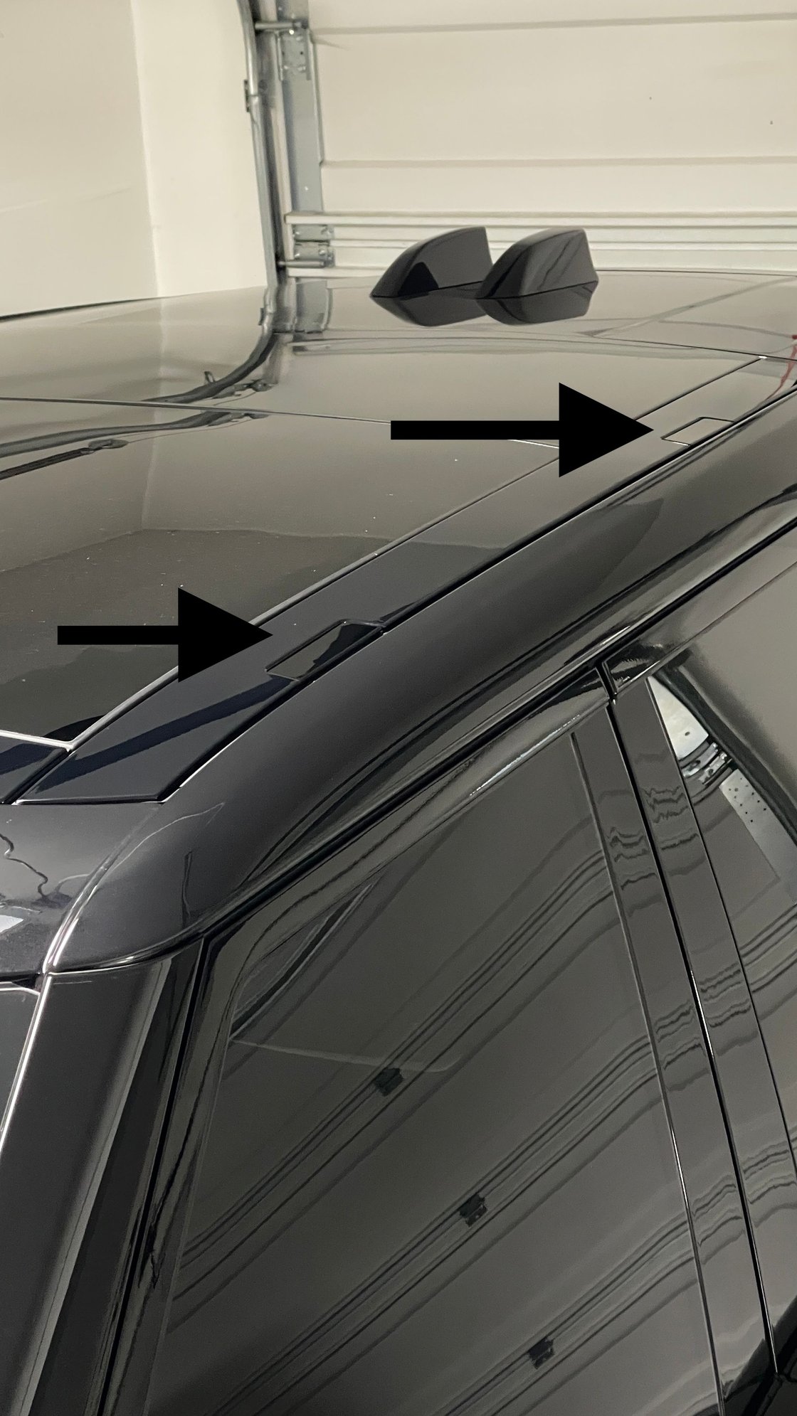

I didn't know that but perhaps it's a different design as for me it has been trouble free for many years now. As for the boat hull comparison, not very fair as cars aren't boats and they don't stay on water all the time. We're talking rain....
For illustration purposes here are pics of my RR and GLS63 roofs. Very different designs as the RR has these openings covered by plastic tabs (4 total, two shown at arrows) - water WILL get in there, they're not a tight sealed fit, I can wiggle therm around with my fingers.
Range Rover L460
Range Rover L460 ⬆️
AMG GLS63
AMG GLS63 ⬆️

Mr L460 you’re killing me.
An education on how the water is managed up there:
Those 4 rectangles on your L460 are for roof rail attachment points. . https://accessories-instructions.lan...A/460/G3191634
You don’t have roof bars on your L460. So. If you want them, you remove those and put them there.
Your M-B on the other hand, does have the long roof rails. In the picture, I see them. 3 attachment points on each side They have to mount somewhere, and there are 3 holes in the Mercedes roof on each side where those bolt in. Similarly, on the L460, all those 4 things do is provide a point to mount a roof rail on. In no way are they letting water into the cabin. Just the same as those 6 holes in the Mercedes roof are not letting water in.
Then -- Those long black strips on either side of your L460 are removable that those 4 rectangles that trouble you are in are removable. The sunroof drain channels are in those areas...with drain tubes at the fore and aft ends. Underneath them. If you look at my post here it’s the exact same thing on the L663 Defender. https://landroverforums.com/forum/20...-110-x-120658/. It’s actually quite a good water management systems, that’s less prone to mucking up and clogging -- far better than old systems.
LOL... that proves how much of a newbie I am to Land Rovers. And evident as well when looking at the number of posts we both have.
I had no idea rails for the RR were even an option so that makes total sense. As far as the MB goes, those rails I believe (and I could be wrong again) aren't options on this trim, they just came with it. So... forgive me for my ignorance. That's why forums like this are invaluable. And excellent post on the L663 btw. I've been lurking around and participating here because I am thinking about getting a Defender 110 V8 to replace the MB as I don't need two 7-seaters.
