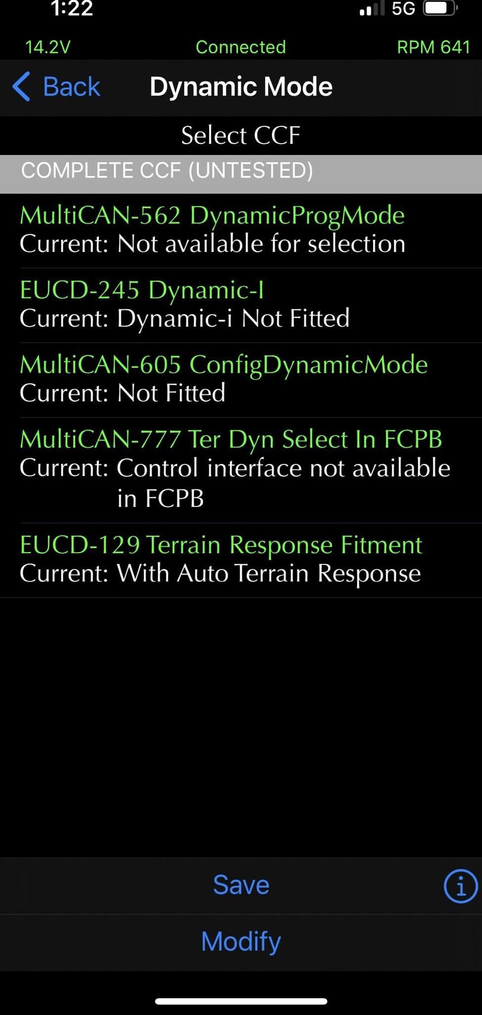

I got Dynamic mode activated. Not sure I will ever use it or be able to appreciate the differences but it's there.
I thought there was a cool red hue to the screen in dynamic mode but not the case. I know I've seen some folks with the red screen in Dynamic.
I don't see where to make any adjustments to suspension etc. I thought this was a thing too. Maybe just a V8 thing.
I put the 5 items that need adjusting in a favorites tab for dynamic so I can tweak as needed without having to refind them all.

That image shows nothing set as it should be, those are all the default settings without dynamic. If they are set correctly, dynamic shows up when you use the HVAC rotary, and the individual setting will be in a new “Dynamic-I” app that will show up on the app screen.
Yes those are the 5 settings listed before any changes.
I didn't realize there was a dynamic APP in Pivi.
I can select Dynamic on the TR dial. Wavy road icon and the Dash shows the Dynamic illustration and icon.
