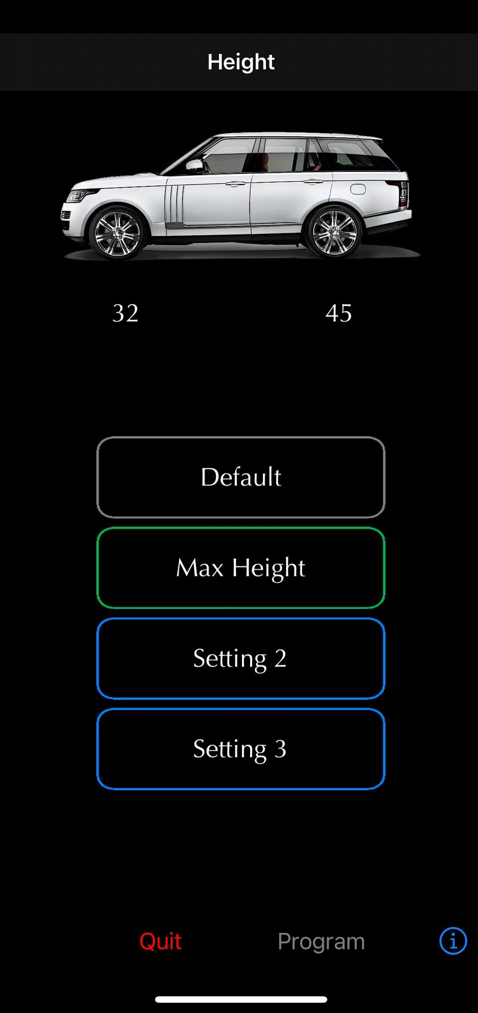

opening the tailgate with the key fob and adjusting the stock ride height.
the former is in the list in post 1.
the latter is controlled in height tab.
