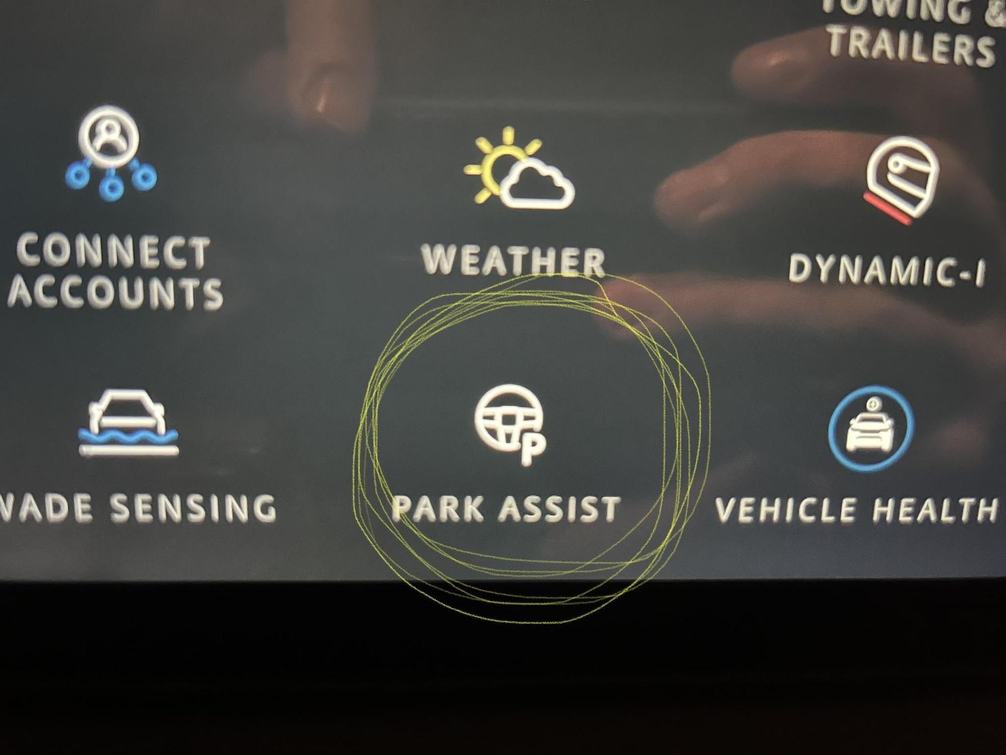

Originally Posted by GavinC
Tried a second time.
Park assist settings
Activate Park Assist
EUCD-059 Parking Assistance
Standard: Without Parking Assistance
Change to: PDC (Front, Rear) - Parking (Parallel, Exit)
EUCD-099 Park Assist Camera
Standard: Without Park Assist Camera
Change to: With Park Assist Camera
EUCD-140 Pdcautoactivationmenu
Standard: Not supported
Change to: With PDC Auto Activation menu
MultiCAN-469 PDCAutoActivation
Standard: Not Supported
Change to: Default OFF configurable
MultiCAN-500 PDCBtnFCIM
Change to: Fitted
MultiCAN-602 PDC
Standard: PDC not fitted
Change to: 10 Channel fitted ( Park Assist)
MultiCAN-786 Park Assist
Standard: Not Fitted
Change to: Full Auto VarD (Fully automated park assist with automated steering breaking acceleration and gears)
  • Needed 2 resets to PIVI for the app to appear in PIVI and a full car shut-down to clear the "Emergency Brake Assist Unavailable" error.
I still need to try it out to see if it functions before adding it to post 1. Not sure on the process or how best to test.
I attempted this today on MY23 75th…No joy. Got the app, but just showed the icon in the middle of the screen. Nothing else ever worked. Reset Pivi a couple times. Shut down car a couple times. Still no joy.
would love to see anyone else to get this to work.
Try the app when you're out and about driving. I have a theory, (granted I have lots of terrible ones) that it needs an actual setting while driving to break its slumber and turn on. Might take a day or two to learn. Mine activated the following day after install. Also make sure your park assist settings are turned on in PIVI. They don't default to on after activation. Also I did the semi auto and then full auto CCF changes for it to appear. Not sure if it makes a difference.
I do think it's there. Mine is a MY22. Nothing weird or unusual about it.
