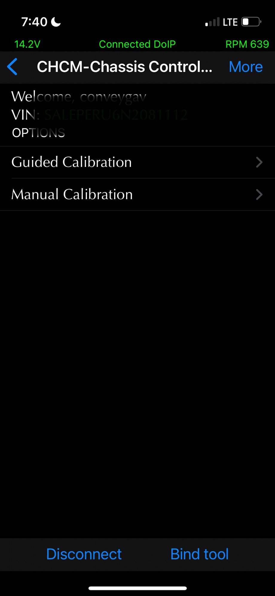

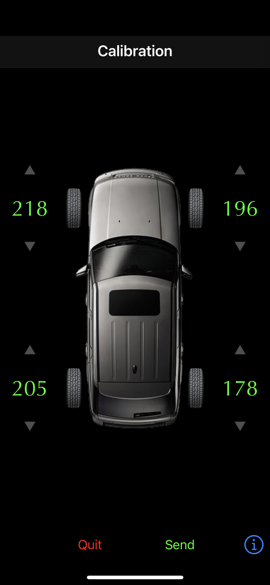

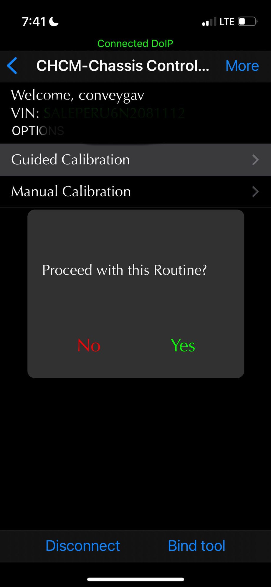

Originally Posted by stevemfr
Actually you can self-level the vehicle. I don't have the time to UL pics right now, but I just used this feature last night on (albeit on my old L322 travel vehicle).
-You first need to disable the air suspension by going into build mode into 'Service Test > CHCM>Build Mode' (CHCM = Chassis Control Module - in older vehicles the RLM (Ride Level Module) or even older simply EAS and Transport Mode).
- Then you choose the 'Test Valves' function in the same menu. You have the option of leaving either front or rear or all 4 corners linked/unlinked. If you go with all 4 unlinked you can compensate for some pretty hefty holes or angles and still get the car level. I use a level app on my phone on my center console lid which is parallel to my RTT in both axes.
We are camped out on a beach in Albania (as I write) and last night was probably the most extreme angle I have ever used this function on: the LR was on the bump stop and the RF completely extended. Funny that this topic should come up now :-p
We just spent a week off-roading and camping on the beaches and in the mountains of Albania. Beautiful country and unbelievably friendly people. First time here for me and I am coming back!
Looks like it may be a bit different on the Defender. I’m not seeing the terms you mentioned.
Im a bit wary to start clicking on things.
Manual calibration gives the last image. I’m not sure what I’m looking at here. Parked on the flat I thought these values would be more similar.

@stevemfr
Any insight into the chassis module menu I posted above? Is it manual or guided calibration I should use. Do I need to record the values as they are so I can return to them afterwards?
