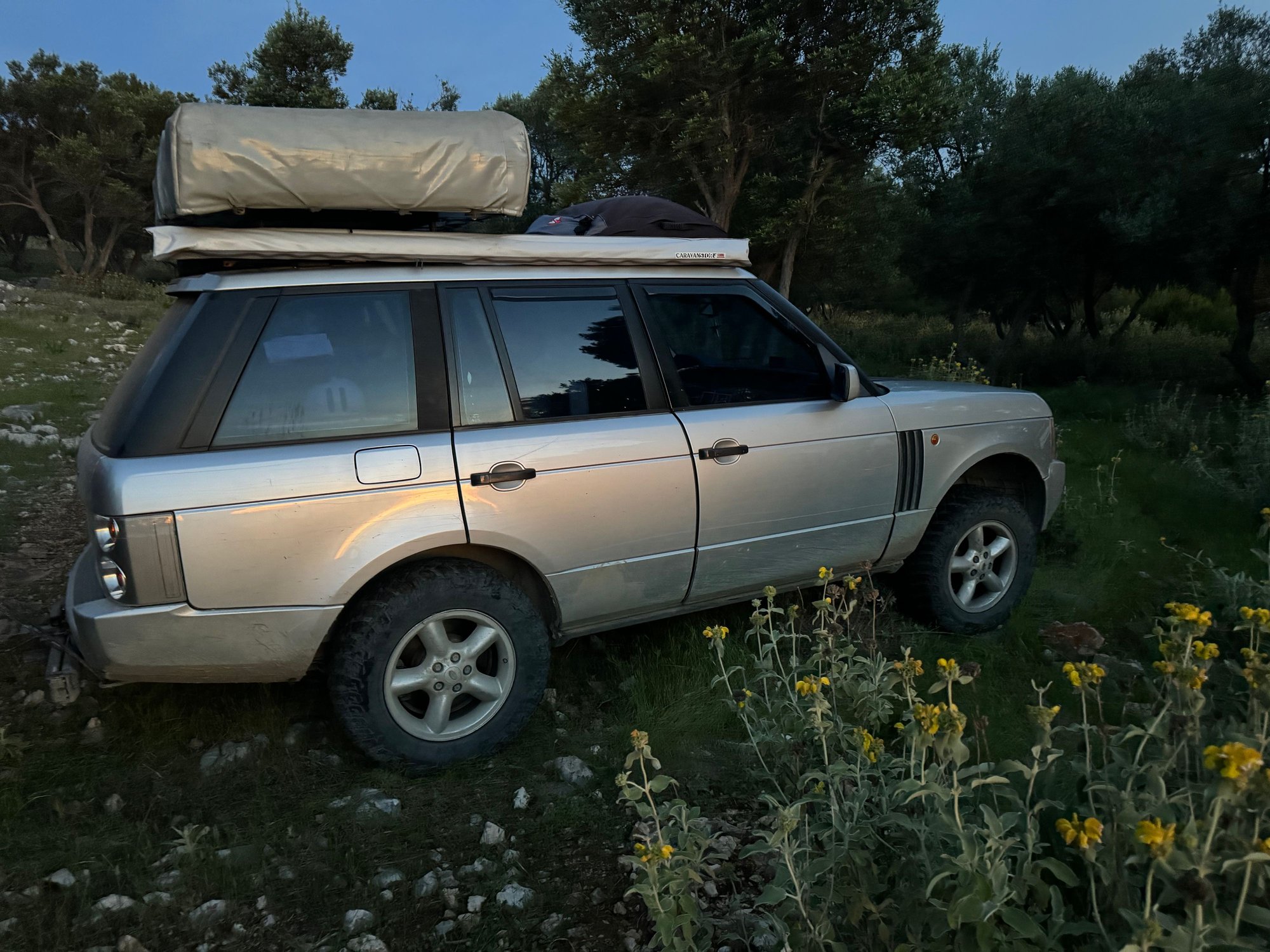

Actually you can self-level the vehicle. I don't have the time to UL pics right now, but I just used this feature last night on (albeit on my old L322 travel vehicle).
-You first need to disable the air suspension by going into build mode into 'Service Test > CHCM>Build Mode' (CHCM = Chassis Control Module - in older vehicles the RLM (Ride Level Module) or even older simply EAS and Transport Mode).
- Then you choose the 'Test Valves' function in the same menu. You have the option of leaving either front or rear or all 4 corners linked/unlinked. If you go with all 4 unlinked you can compensate for some pretty hefty holes or angles and still get the car level. I use a level app on my phone on my center console lid which is parallel to my RTT in both axes.
We are camped out on a beach in Albania (as I write) and last night was probably the most extreme angle I have ever used this function on: the LR was on the bump stop and the RF completely extended. Funny that this topic should come up now :-p
We just spent a week off-roading and camping on the beaches and in the mountains of Albania. Beautiful country and unbelievably friendly people. First time here for me and I am coming back!

Ok, here are pics
Sorry, it was nearly dark. The iPhone is amazing in low light, but there are limits.

That is very cool. I’ve not heard that was doable before.
I’ve only heard folks bemoaning the absence of a self leveling feature in the vehicle.
how do you revert back to normal afterwards? Ie. Next morning when you want to drive off.
Any drawbacks or downsides to doing this? I suspect no but thought I’d ask.
