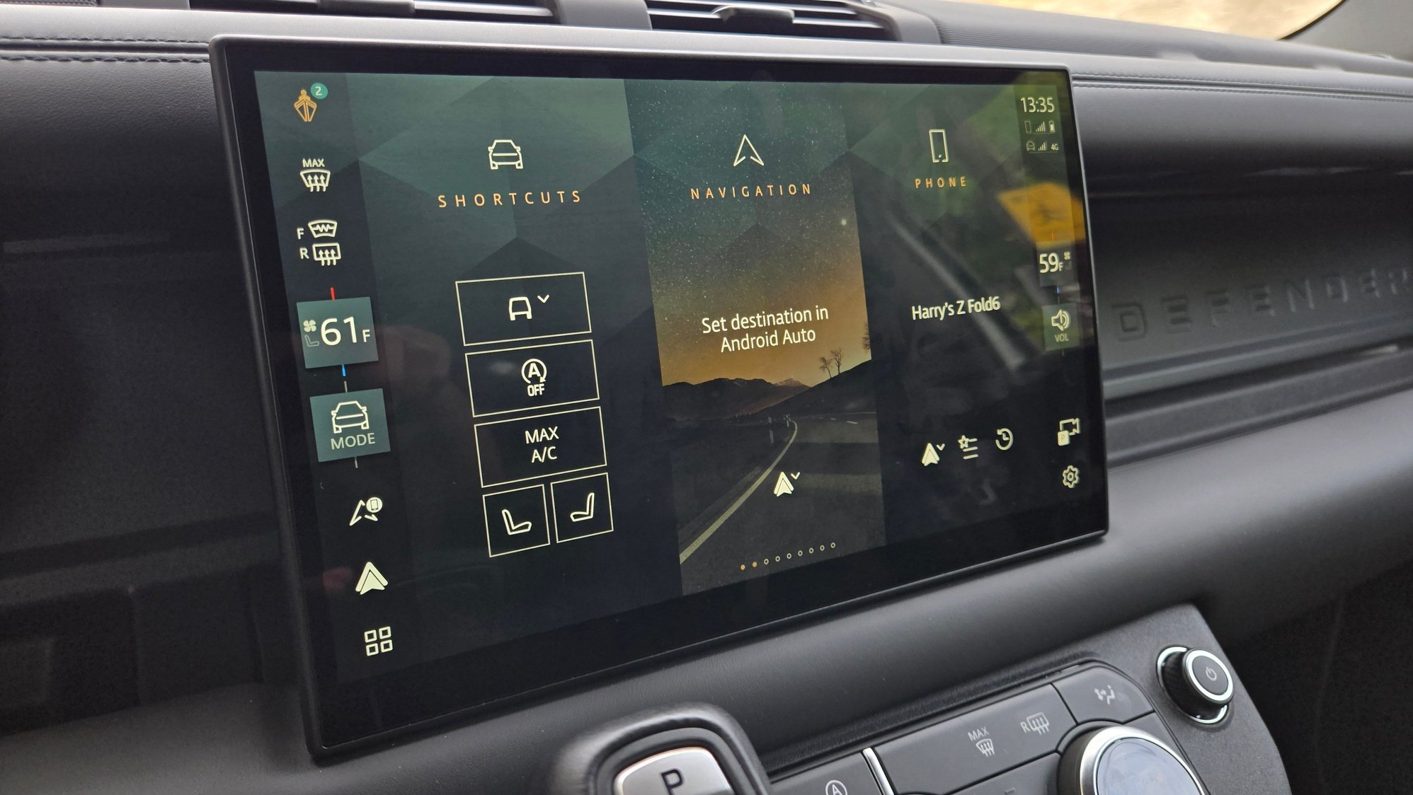

Hi guys, I just found a cool new shortcut which may be on the 2025 update. I tried a bunch of combinations but I think it's 882 to enable the side bars on the ends of the screen. This way you can quickly adjust the AC temp, fan, drive mode, seat temps, volume. You also need to enable a few setting that if I recall were grouped in the 895 and you can choose what short cuts you want displayed such as window defrost etc. Those are called soft buttons.
any details? or luck yet?

I’ve got the shortcut window to appear as well as the ‘custom’ sidebars, however I can’t figure out how to add options in the sidebar.
From memory, the new button on my left sidebar contains TR Mode and the right side has a volume slider (see my earlier post for details)
I do not get any of the climate control options. While I was doing the setup, Pivi served up a ‘demo’ screen that included climate control icons, however my actual screen does not include them.
I was hoping that the 4.2 update would change things, however it has not.
