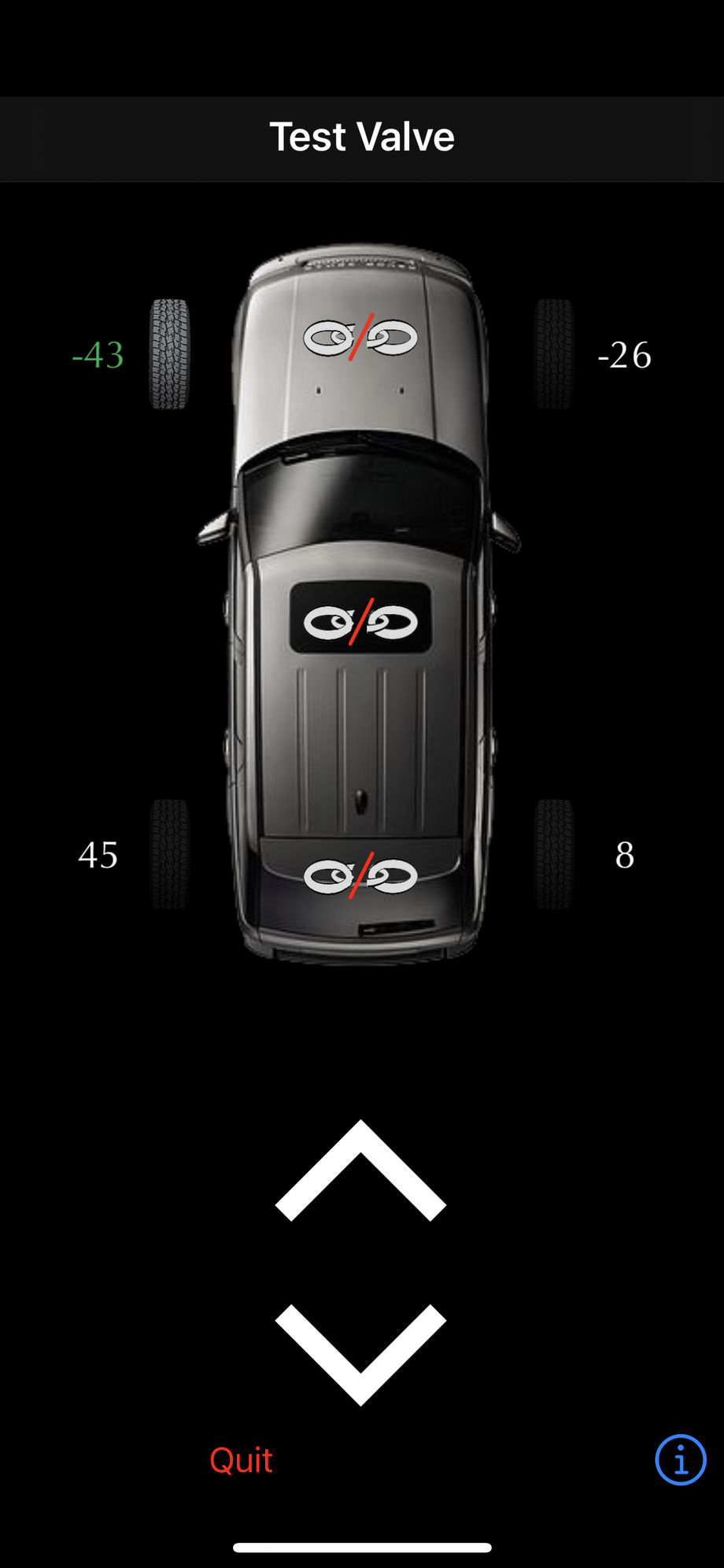

Originally Posted by GavinC
Looks like it may be a bit different on the Defender. I’m not seeing the terms you mentioned.
Im a bit wary to start clicking on things.
Manual calibration gives the last image. I’m not sure what I’m looking at here. Parked on the flat I thought these values would be more similar.
hi Gavin, you don’t want to do a calibration. This is used to establish the base height setting of the EAS. You would use this if you replaced a height sensor or similar. Not a big deal, but it is a procedure that needs to be followed accurately, including having the vehicle on a level surface and taking measurements. And it takes a while to get through.You want to get to the CHCM ECU through the service/test menu. Not the calibration menu. There you’ll find build mode and test valves. Sorry for the late reply – lost connectivity as I started typing this.
Thanks. I'm glad I didn't go messing about with this section. I'll have a gander at the CHCM ECU section. Much appreciated for taking the time to help. Cheers.

well that works.
Leveling with independent use of the airbags at each corner.
I won’t use it probably but good to know it’s there and easy to use.
