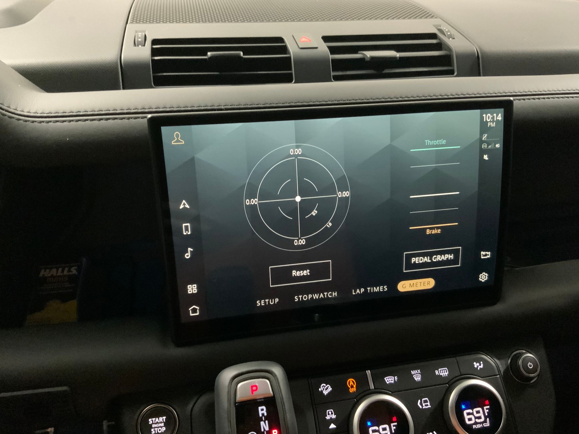

‘When I went back out to garage to try again, I decided to just check my dynamic mode again. Sure enough it now went into a new screen when I pressed the helmet on my Home Screen.
I got this screen, this would have been the 3rd full power cycle. However that setup button only went to blank screen.
I decided to back it out of the garage and test the brake hold again. Sure enough, no more brake hold function.
So based on all that changing after a 3rd full power cycle I desired to go for a 4th full power cycle.
‘Still nothing new .

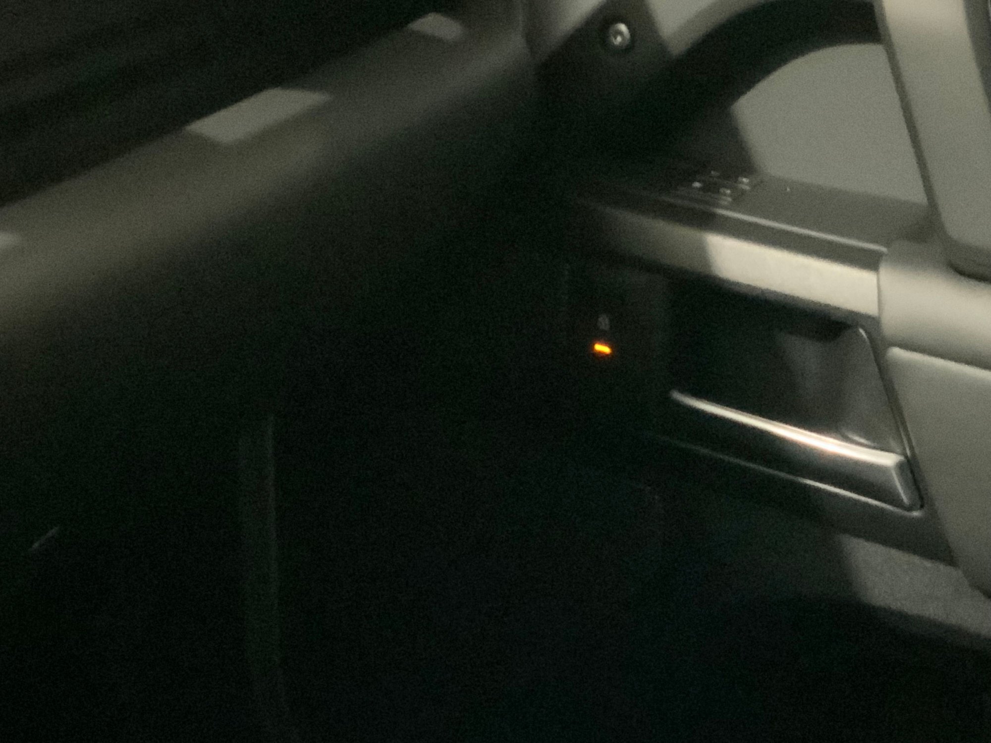

I have noticed even once everything has finally powered off the door lock lights stay lit.
‘Thought that was a bit odd.
Next I decided to go for a 5th full power cycle.
That 5th full power cycle, must have did the trick, dynamic mode setup button finally worked.
‘I now have the configurable screen I was hoping for. All seems to be working now.
