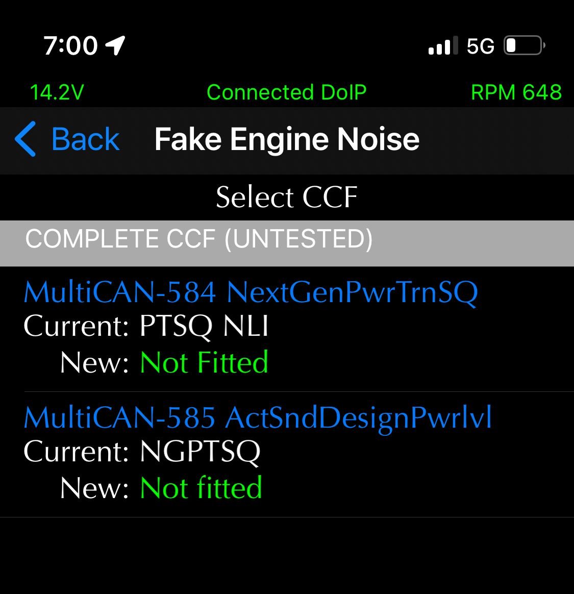

Originally Posted by GavinC
Decided to disable the fake engine noise today.
immediately noticed a difference sitting in the garage with it running.
no faults
