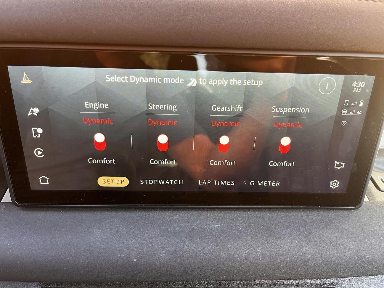

Originally Posted by cc1999
I saw a lot of chatter about the dynamic mode on here. Mostly about turning it on for the P400s.
What if you have V8/P525.
Mine has dynamic mode already, but best I can tell, my dynamic mode is not something I can edit or adjust like I see the guys on here doing with their 400s.
I want to adjust my suspension to comfort/normal but keep the rest of dynamic mode as it is. Is that possible on a 2023 P525.
Am I am just not finding the right screen to make the adjustments, or do I need to change anything with the GAP tool to make mine where I can edit the individual components within dynamic mode.
I don't seem to have access to this screen on my P525's dynamic mode.
I have a 110 V8 it is P500 (not 525 or Carpathian) and it has dynamic mode, but as you mentioned it is not adjustable. Just got a gap tool to turn off the stop start and it worked so will look at adding the dynamic selector and other goodies mentioned.

With the V8 you should already have the dynamic mode and the user interface for it. I assume all V8s have the dynamic mode but perhaps not.
There is a Dynamic Mode Icon in the main screen. Just tap the tile icon lower left to open up all the various things and you'll see it. A racing helmet. GAP tool not needed here.

I do have dynamic mode.
I have not found a way to pull up any screens to edit dynamic mode.
Nothing like the pic I posted earlier.
Other than the custom mode having optional settings, I don't see any adjustments for any of the pre-configured modes.
I will look again.

Not so …… dynamic mode is available but not user adjustable on some V8’s ask me how I know. There is no racing helmet, and a gap tool is needed here.
Ok
How do you know?
I'm sure you're right, I've not sat in a V8 let alone driven one but I thought the dynamic mode was a core feature and emphasized heavily by LR when the V8 came out. Spirited driving or some such nonsense. Without my g-meter and lap timer I'd be a shell of a man.

Ha, your posts are awesome you and some others on this forum know your stuff and I really enjoy the help. How do I know - because I have a Defender V8 that has dynamic available for selection (and it works and feels awesome) but currently it is not adjustable, in my vehicle there is no racing helmet (yet). I will be adding that shortly thanks to this and other posts. Again appreciate all of your posts - most helpful.
