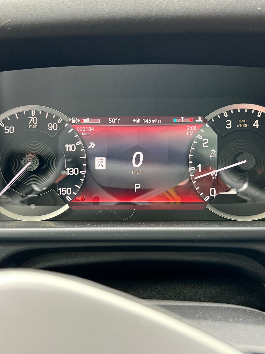

@mattF I see you have a 2023 with the standard dash and it turned red when you implemented Dynamic Mode.
Did you change anything other than the settings here? I've got everything your Dynamic screen shows, but no red lights on the dash. I have the digital dash which different than yours and it's a 2023.5 (probably subtle differences)
I was thinking that the MultiCAN 682 setting is what changes the dash, but it didn't seem to change anything when I would toggle it on and off when programming.
I'm with you on the "probably the wrong platform to implement a race car mode on". Still a fun party trick to play with.
The dials turning red seems to be a bit hit and miss, some people have it and some don't (like me) with exactly the same settings

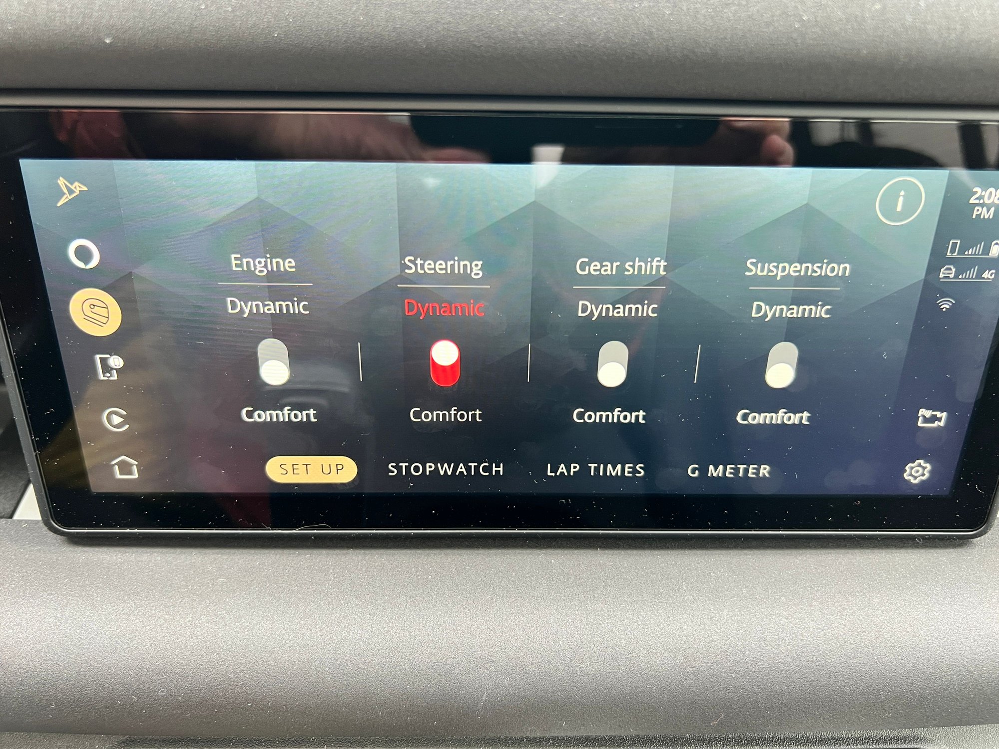

Dynamic mode on a p400 is a big difference. I tend to pop it into dynamic anytime I'm on a curvy twisty road, or on the highway. I just like it much much better. It is a quite noticeable change. For lazy around town driving I leave it in whatever it defaults to, ie Comfort or Auto.
The easiest way to explain it is -- it does the same thing on the P400 that it's been doing on the 2010 to present RR's / RRS's with the 5.0 V8 SC. Literally... the same thing. If you have seat time in any supercharged v8 L320, L322, L494, L405 you'd have a good baseline reference.
What I notice:
-- Shift speeds faster (shift speed is so lazy on the P400 Defender when downshifting on highway as stock, it's like a super slushy slush box until it shifts... I find it much better in Dynamic)
-- Transmission holds gears on decel a bit longer
-- Engine revs higher in the power band before shifting
-- More responsive or 'touchy' throttle
-- Tightens up steering. BTW - Noticeably on mine, unlike an above comment on P300 which perhaps is different?
-- Tightens up adaptive suspension.
For highway drives I put everything in Dynamic but Suspension in Comfort on this screen -->
What I notice:
I agree with everything you said. It is noticeably different on my P400. I use mine regularly and enjoy every minute of the change.
