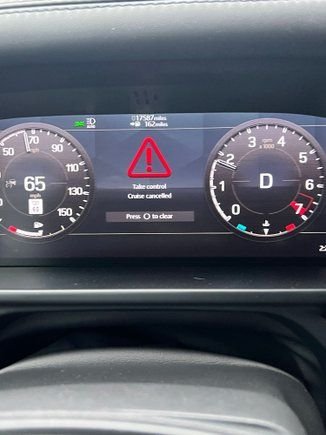

Default ACC Issue
Finally took the plunge and got the G4 GAP tool. First thing I wanted was ACC so proceeded as per this thread. All went as expected, after making the update got the Emergency Braking disabled thing but after cycling a couple times it went away. So out and about I went to test it. Seemed to be working as expected when all of a sudden I got this message (full disclosure the photo is taken from a post by @nashvegas in another thread as I did not think about taking a picture!). After that it told me adaptive mode was not available. Stopped turned off engine got out and closed and waited a couple mins. Then jumped back in and started again. System was back working but after a little while same thing. This same routine happened a couple more times, so I put the GAP tool to good use and decided to read and log live values for the cruise control sensor state. The log shows that it starts as “sensor fully operational within specification” and then after about 90 seconds of the ACC being activated the message on the dash comes and the sensor status changes to “sensor blindness detected”. So seems to be a hardware issue.The car is pretty clean and there was no rain, snow or mud involved (also no warning or faults of any kind other than the one in the picture, and no warning for emergency braking which as I understand it uses the same module). I will throughly clean the badge and housing tomorrow and check for anything that could be obstructing it (I did do a winch installation a few months ago which implied removing the radar), but was curious if anyone experienced this. My guess is the issue has been there for a while but since I did not have ACC it wasn’t noticeable (though I still think Emergency Braking should be showing a warning if the module is having issues).
Related to this, I also figured it might be worthwhile doing a Radar calibration via the Service/Test function of GAP IID, but when I tried to do so I kept getting an “operation failed” error. Curious if anyone here has successfully performed a radar calibration with the tool (I was able to confirm via live values that the horizontal and vertical angles of the radar are within specification, but still think it would be good to perform a calibration since I had removed the radar).

I believe when I took that photo it was icy conditions when I was driving back from a ski town (?) and there was a ton of rain or slush on the front of the vehicle, although I could be wrong. Either way, since then, that is the only time it has happened. I too, btw, have a winch and associated setup on the front of mine although mine came from factory with ACC.
It does sound like the sensor behind that LR badge thinks it “can’t see” based on what you say, doesn’t it? You’re sure there’s not a wiring issue with that connector right? I bodged and had to re-pin my connector to that sensor (it was a complete nightmare actually) -- I broke the connector when unhooking it to install my winch, and one of the wires came out and was loose. A loose wire could cause the issue you’re having. That connector is to as easy as you’d think. Mine was very difficult to unseat properly. As a final question, do you have any kind of bull bar or lights up there? Just curious. ‘

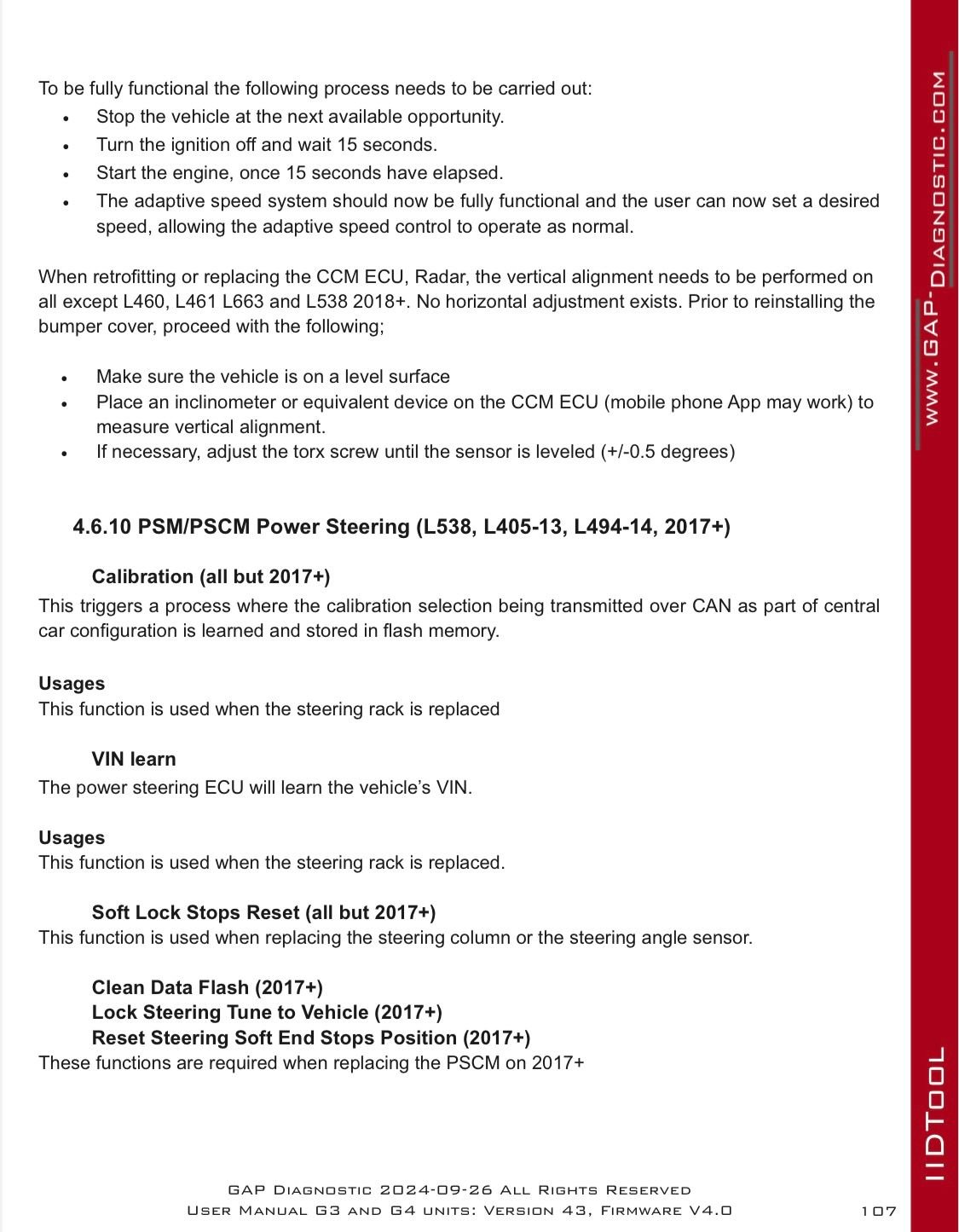

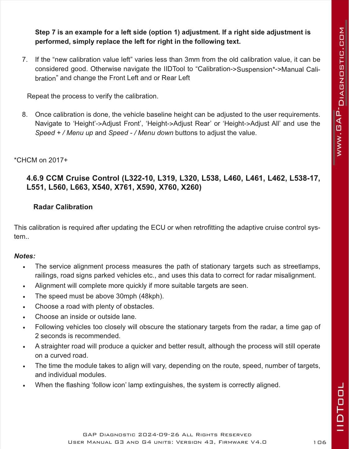

@nashvegas
i discovered the calibration steps in the shop manual the other day by pure chance looking at other stuff.
as far as I can tell all the steps to calibrate are GAP tool doable.

Originally Posted by GavinC
@nashvegas
I found the radar calibration function in the GAP tool manual. The notes are identical as what is stated on the LR workshop manual.

From: South Florida
BTW I have not recalibrated the radar sensor with Gaptool. Did not know you could do that. @CincyRovers said he had it done at the dealership - is that right?
Yep, wiring is on my list of things to check. I do not recall having issues with that connector when I did the winch installation, but will be checking it anyway. no bull or light bars, just the OEM winch setup.
Will report back after spending some time on this over the weekend.
